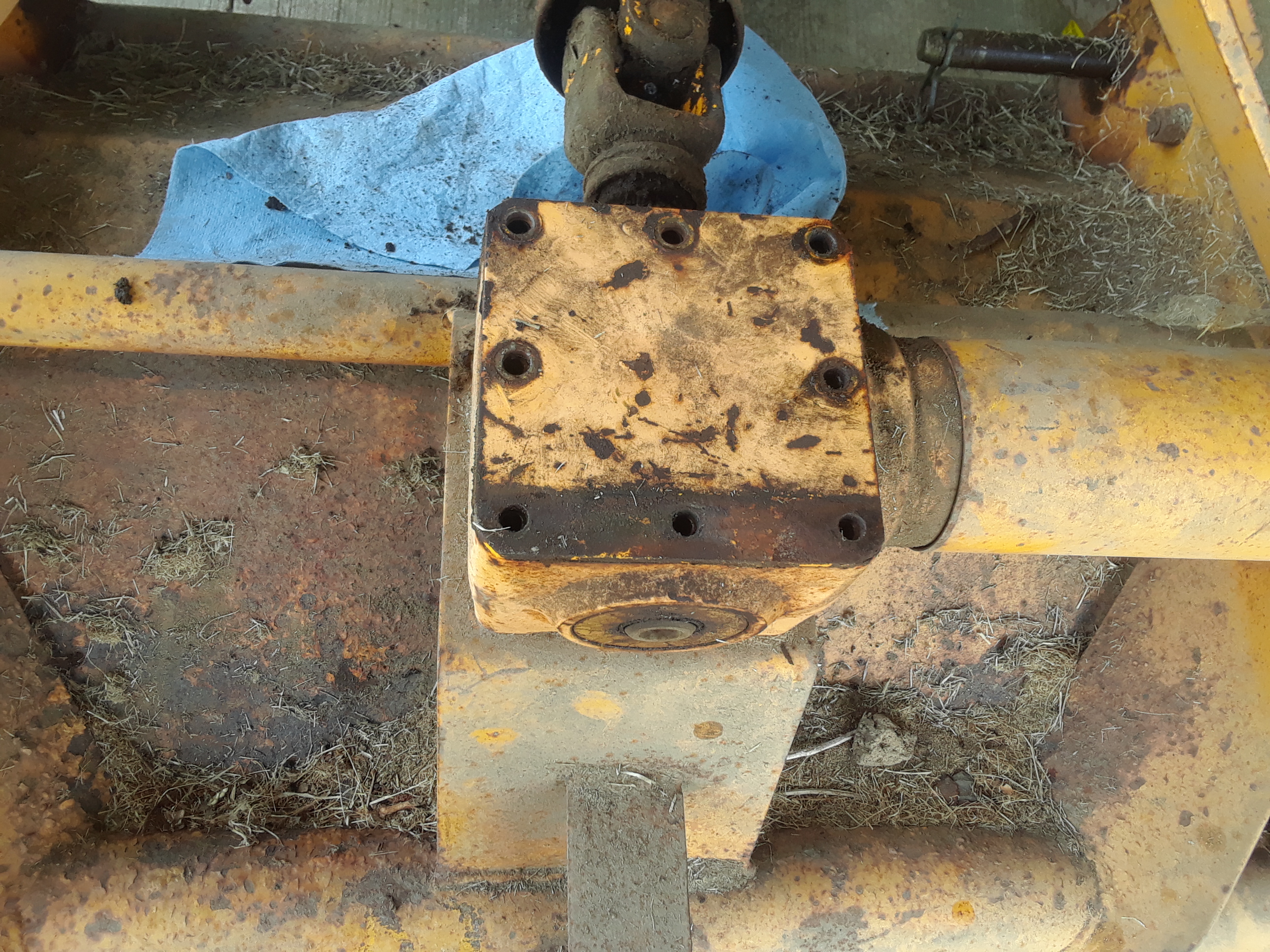

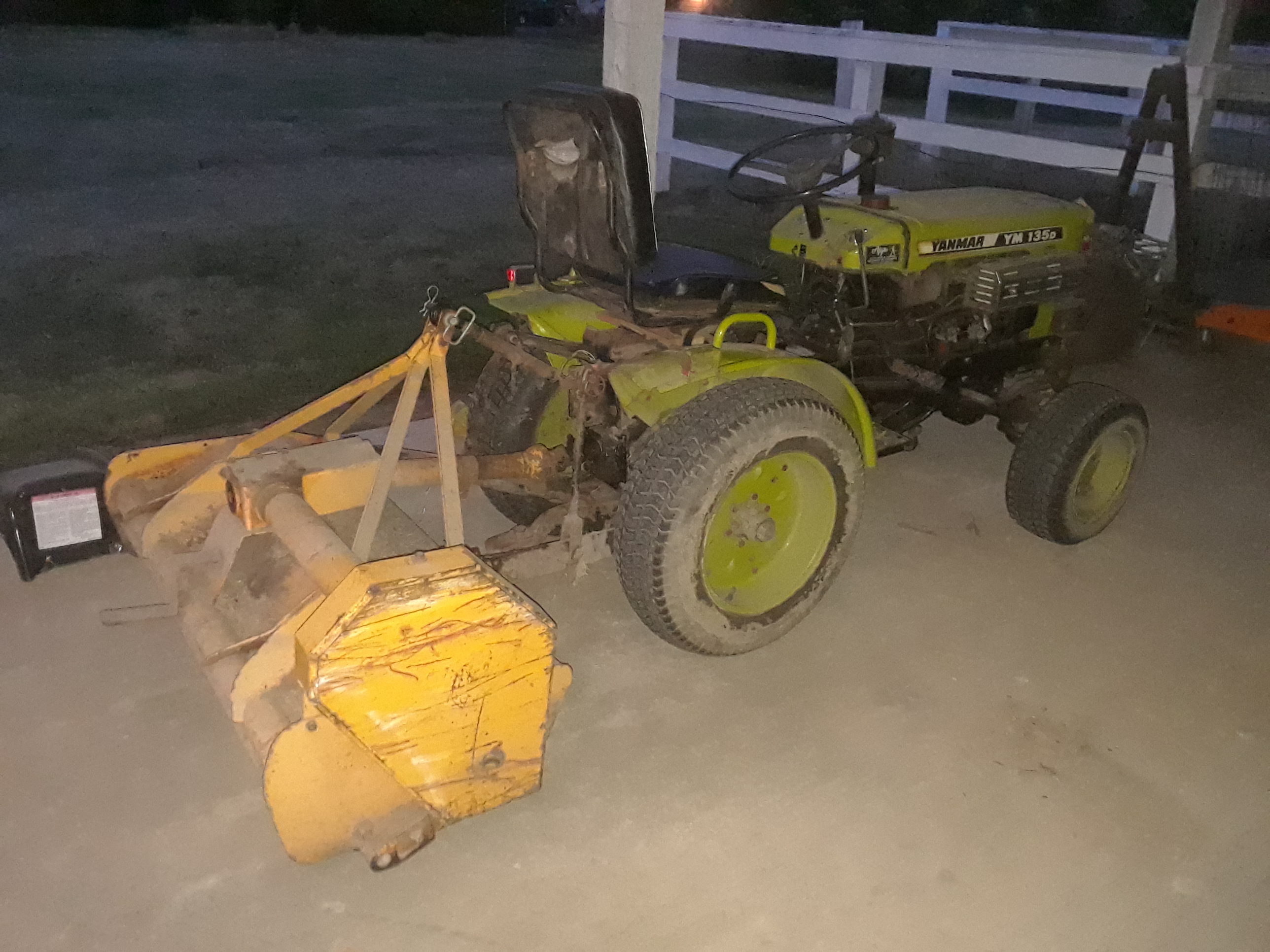

I have the flail mower shown in the attachment. It works great but I want to identify it for spares, advice, etc. There are no markings on it and it is 48" wide. It has square plate on top of the gear box and drives the mower from the right side as shown. Any help would be appreciated. Thanks 135D w flail mower (3).jpg20171001_133538.jpg20171001_133556.jpg
/ Flail Mower Identification #2
Can't identify specific model, but has many characteristics of a larger Mott flail I used to run. Mott is no more but I believe Alamo took over. Aftermarket parts available also for a lot of it.

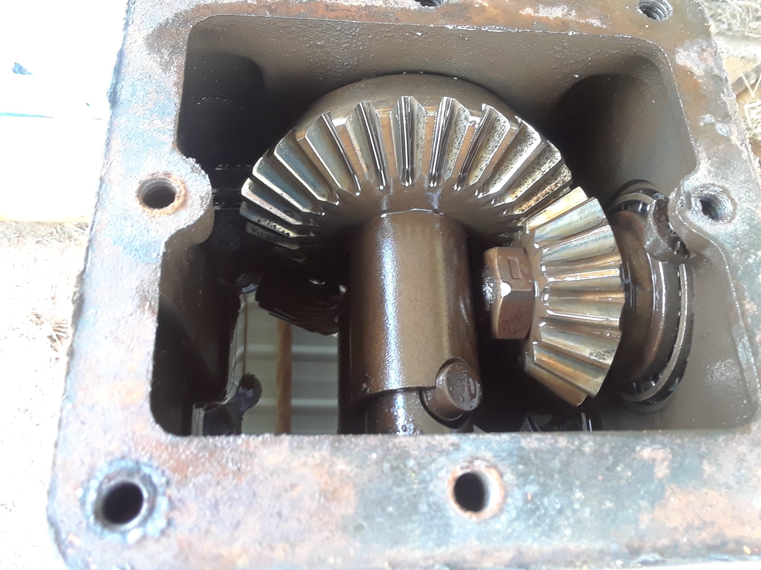

Thanks, all for the quick responses. I will pursue the Mott route. Did not see anything on the pulleys but they are dirty. 20171001_133538.jpgWill take off the cover and clean it up. FYI, everything rotated freely even before I lubed it up. I am not looking for anything specific, yet. But, just want to have a source when I need it. The previous owner left a bag of new double sided blades for me. FYI, we got the tractor and all the implements for free when we bought the house. None of it including the tractor had been used for maybe 10 - 15 years. So, just want to respect the gift and keep it all running. Here is a pic of the gears with cover removed.20171001_133610.jpg There was just about 1/8" of oil in the gear box. Cleaned it out and filled to just above the bearing with fresh 90w gear oil.

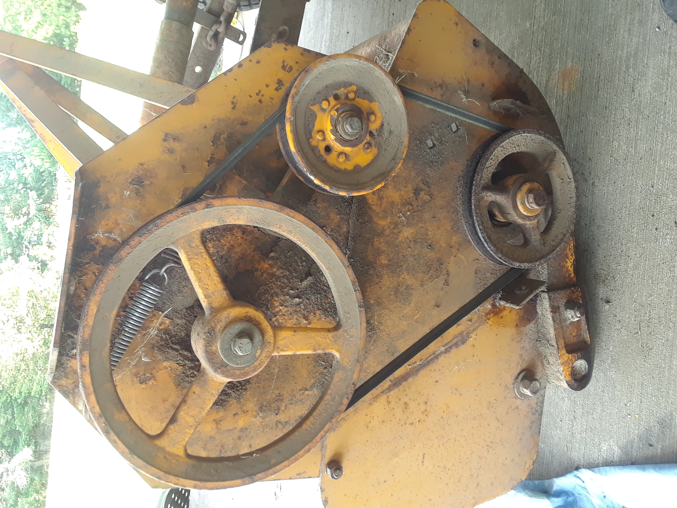

It looks like the belt isn't routed correctly. Generally the back side of the belt runs on that tensioner pulley, gets the belt's driving surface in better contact with the drive and the rotor pulleys. Might want to check that. I could certainly be wrong, though, as the way the springs are set up looks different. Maybe someone else can chime in with a mower like yours.
*Usually, the belt would be on the left side of that center pulley. But as noted, wait for others to chime in first.

Shaeff - thanks for the response on the belt tensioner pulley. It also looks like someone added a spring to the original (two in line). May validate your thinking. Will certainly check that.

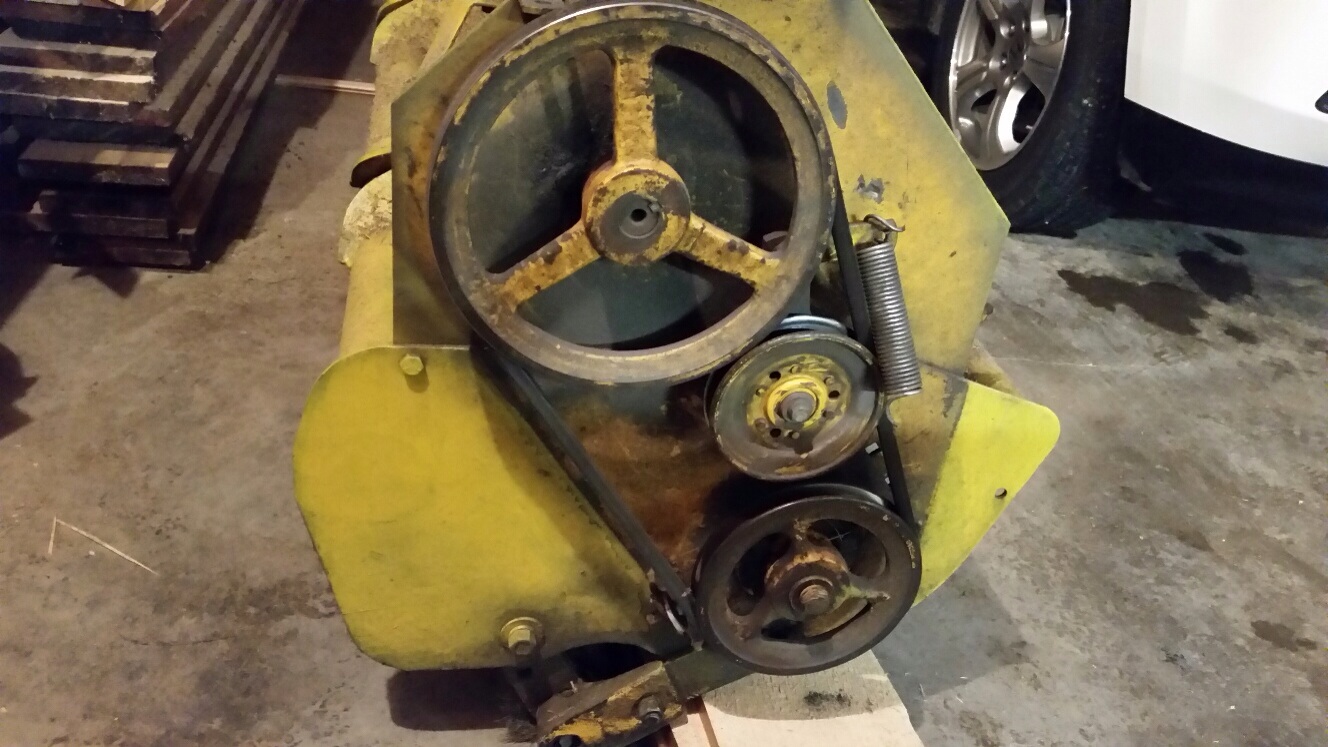

I have revisited the flail drive system and compared with one on the other thread. They are identical in the way the idler pulley is mounted and the spring end mount. The one with the broken spring is the one on the other thread and the one with the working spring is mine. I do not see any other way it can mount. The spring pulls upward toward 11 o'clock in the photos. Comments??20171001_133538.jpgimage tractorbynet.jpg

You have 2 springs there it should only have one long one.
/ Flail Mower Identification #13
Looking at your photo you posted, that definitely is an inside idler pulley. Belts look to be set up correctly other than as Leonz stated probably one tension spring instead of the 2.

Thanks, Leonz and DoubleDeere, also found the zirk was missing from the idler pulley shaft and it was frozen up. So, double spring / frozen shaft, good thing I did not throw a belt. Cleaned it up and installed the zirk and greased the heck out of it and it works fine. Looks like the belt is too narrow. It sits well down in the pulley. Anyone know what the right belt is for it?
I am thinking the previous owner tried to install the new spring and it was too short so he doubled up. It does work but not with much tension. Will have to see if I can stretch that spring. Thanks
