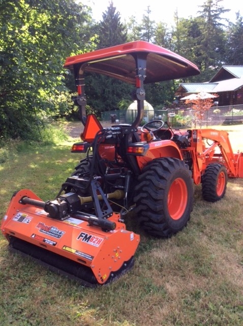

Having made no changes to my Woodmaxx mower, it is far from a perfect cut but, so much easier to mow large areas than when using my brush hog. On longer stuff, those having stiff stems, I get some that don't get cut off but most do. Am I happy, yes 100%. The mower is set using the top link cylinder to lift the skids about one inch high in front, the mower runs on the roller only and being set to it's lowest position. The cutters are the Y type, more for grass than heavy stuff.
My particular mower would never produce a finish look, much like a rider mower can, but I knew that from talking to the seller beforehand who was very upfront about flail mower results and something I knew already. My Kubota excavator has a flail as well and gives the same looking results unless mowing over twice.
My run speed is mostly medium on the HST but switch to low on the heavy and thick stuff. Tac speed is 2200 for the 540 pto and yes, it sounds like a vacumn!

Very happy with my Woodmaxx. Some parts are made in China but see no issue with that. My mower has been bulletproof and is well built. I have the side shift model 60 inch, also top and tilt on my tractor with a harbor Fright quick hitch..

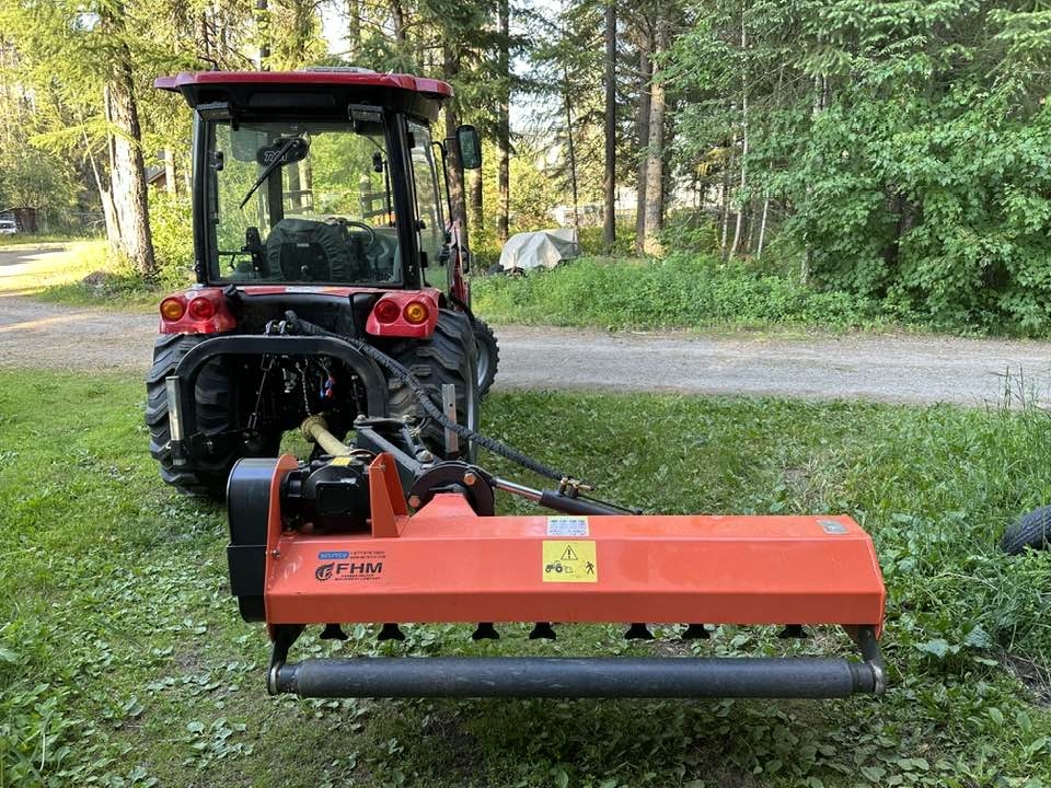

Hi! S584, I also just got a Betstco flail mower, a ditch bank mower. I got a huge job of 19 acres and it didn't do great leaving lots of yarrow and thistles that pop up like an IRS agent on payday. My old 68'' pallettforks.com offset mower was a beast with it's 1.5# hammers. These are barely 14oz.......and made from butter....not really liking it to be honest. The ditch bank feature is about the only good feature about it.
