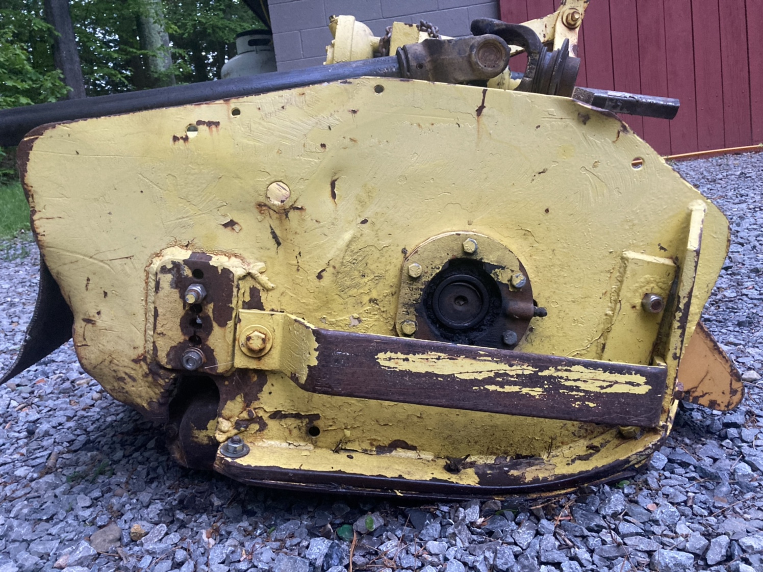

I picked up an Alamo SHD88 yesterday. It's well used and needs work. Former NY state owned. I had previously purchased a Ford 907 also needing work, but decided I'd like a more robust, modern unit to sink some $ into rather than the Ford. If you're in western PA and are looking for a 6' Ford 907 for parts or project, let me know! Anyhow, some questions on how to proceed with the Alamo:
1. Gearbox bearings seem good as in there is no obvious play and it all spins, but it is leaking some at both the input and output shaft seals. Does it make sense to just replace the seals or should I really do the bearings too? Oil is and apparently has been traveling down the extension shaft tube.
2. The rotor bearing on the non-pulley side is bad. Is there any reason to buy the bearing housing and the bearing over just the bearing? There is enough bearing left that I'm assuming the housing is OK.
2a. The rotor bearing on the pulley side seems OK. Should I replace it as well since the other end will be replaced for sure, or just leave it alone for now?
3. Roller bearings need to be replaced. Like question above, any reason to replace the housing with the bearing if no obvious defects?
4. The idler pulley arm has a little slop in it, so I figured I'd get a new idler arm assembly to be easier on belts.
I've prepared a list of what I think I need so far and will try to reach out to Flailmaster.

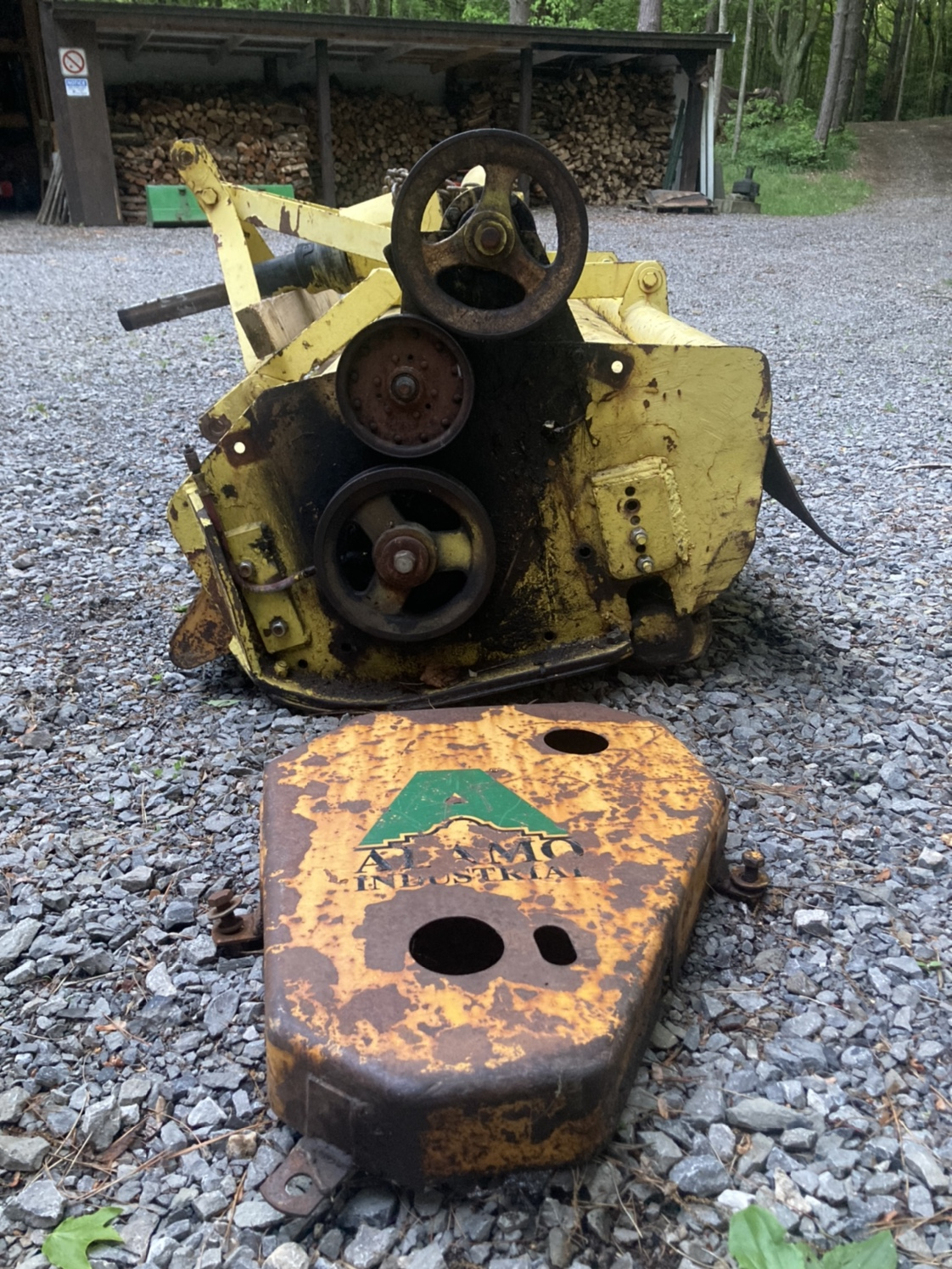

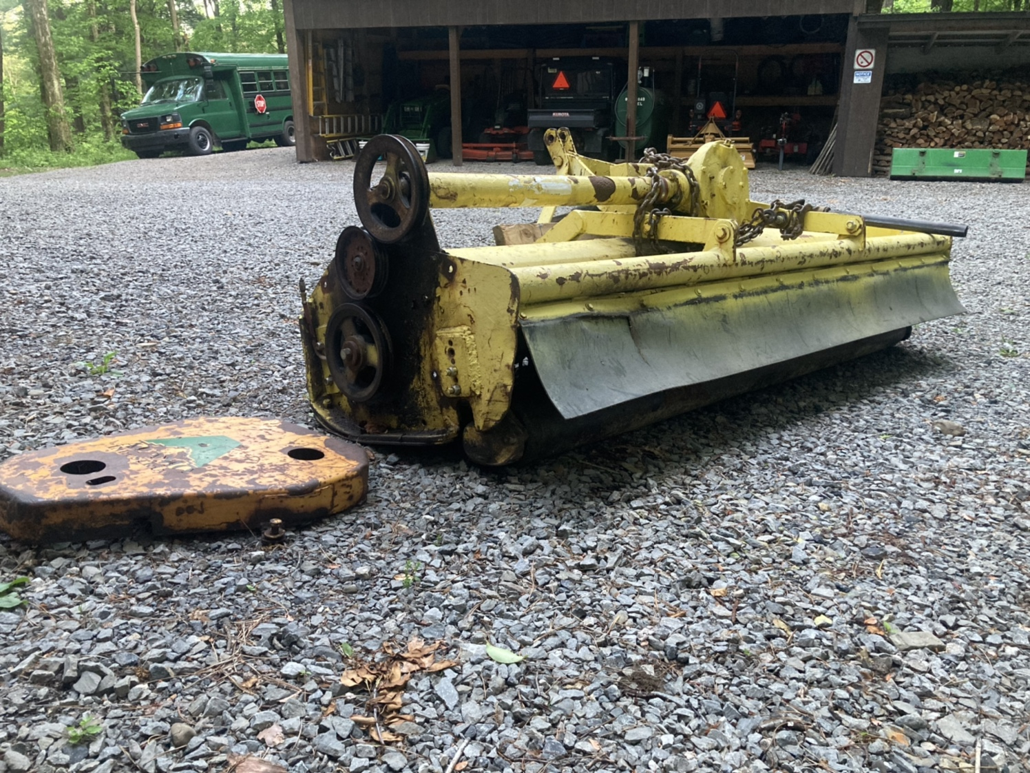

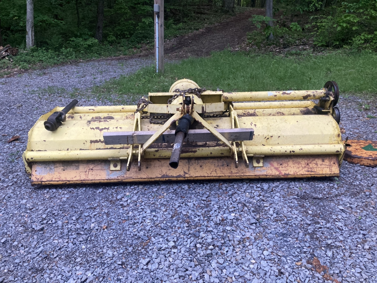

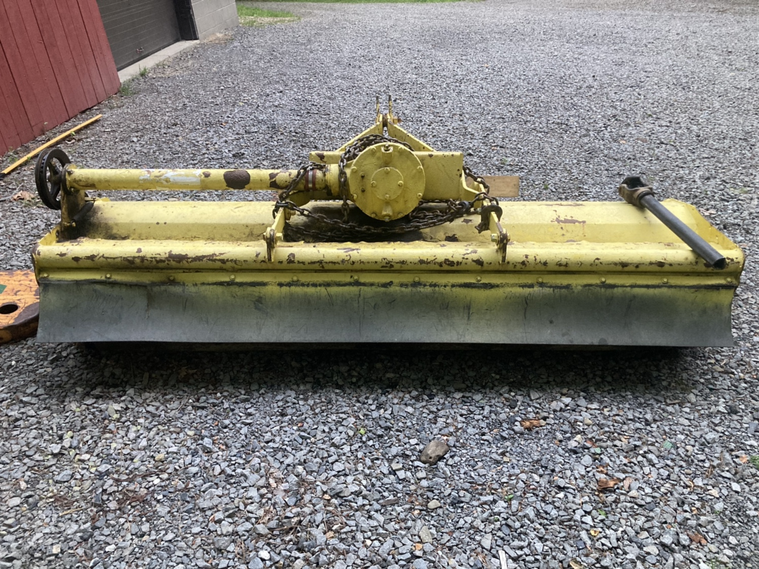

Here is the ugly old thing as it sits. Hope to make into something good over the next few months. Will try to update the thread as I go.

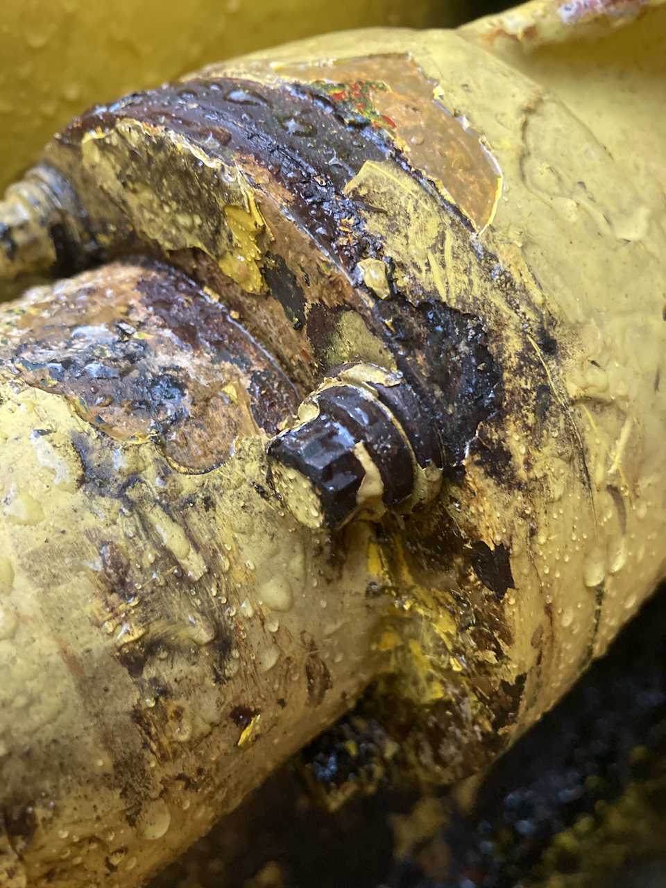

What type of wrench/socket do I need to buy to remove these bolts on the extension shaft tube where connected to the gearbox?
/ Flail mower bearings - Alamo #14
Looks like a 12 point socket to me.
Mine were switched at some point to allen head bolts.
