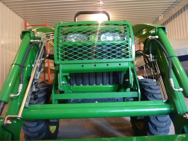

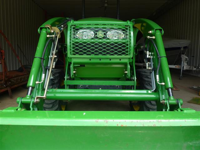

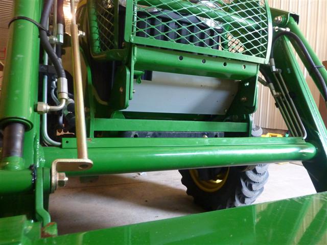

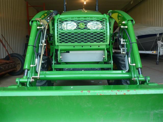

IMO.....the John Deere Grille Guards leave a gaping hole in a very vulnerable place on the 3X20 tractors w/ 300 FEL's. So......I had a grille guard piece fabricated to fill this void and complete my grille guard for use in brush. To me....Its what JD "should" have done.
I was quite pleased with the end result. It all bolts on in a short time by drilling four 5/16" holes in the gussets on the FEL. The guard had to be fabricated to clear the release for the guard...allow a hand to fit onto the latch.....and allow the hood to clear when opening. This plate does all three quite nicely. It has a reinforcement located behind the 3/16" plate....and I'm certain its stronger than the JD guard located above it.
Anyway....here's some before and after pics....and a few on mounting it shown in primer. I asked my fab shop what he would charge others....cause I like mine allot. He wants $40 plus $10 shipping. PM me if you want to have one made by my fab shop...and I will pass on the information to order one. He held onto the templates. ;)
I believe this improved grille guard could save me lots of problems. :thumbsup:

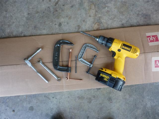

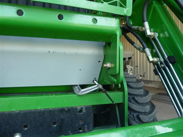

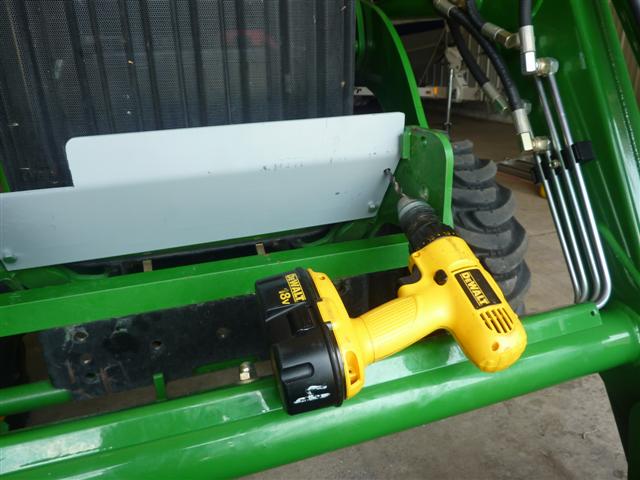

FWIW....to install this guard, I removed the existing JD grille guard (two bolts) and drilled the 5/16" holes....then installed (4) 5/16x 1 1/4" bolts. The tools needed are shown. Pretty easy project....with the right fabricated plate. The section removed at the top left allows the JD grille release to operate. An approx 1 1/2" gap between the guard and the screen (at the bottom) will allow trash to fall through....and air to circulate.

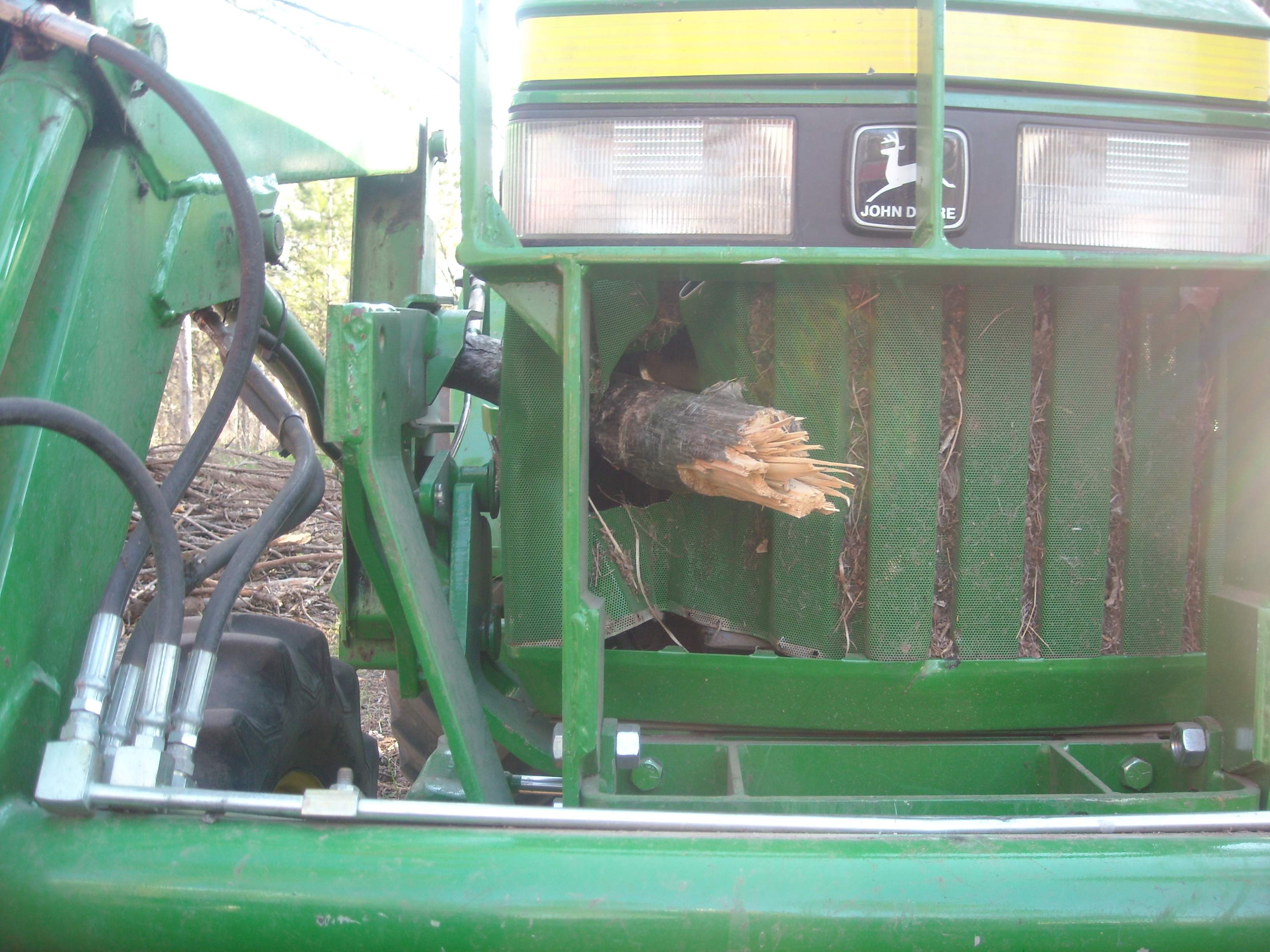

I've shown this pic before.....and it's why I'm so adamant about good brush guards. I ran this 3" branch through the front of my grille on my 790...luckily, it bounced off the battery and out the side grille....rather than through the radiator. I never even knew it happened until my wife "mentioned" it.
I got the grilles fixed up pretty good....but I hate it when this stuff happens....and it could be avoided. I made a vastly improved guard for my 790 "after" this mishap. :confused2: (once bitten...twice shy :eek:;))

Whoa.... That's a serious chunk of tree!! :eek: Thank God I haven't "skewered" my tractor that bad!!
The 110 has a Hydraulic cooler (radiator) directly in front of the engine radiator and I've been worried that one of these days my luck "might run out" and I'll end up with a huge repair bill!
