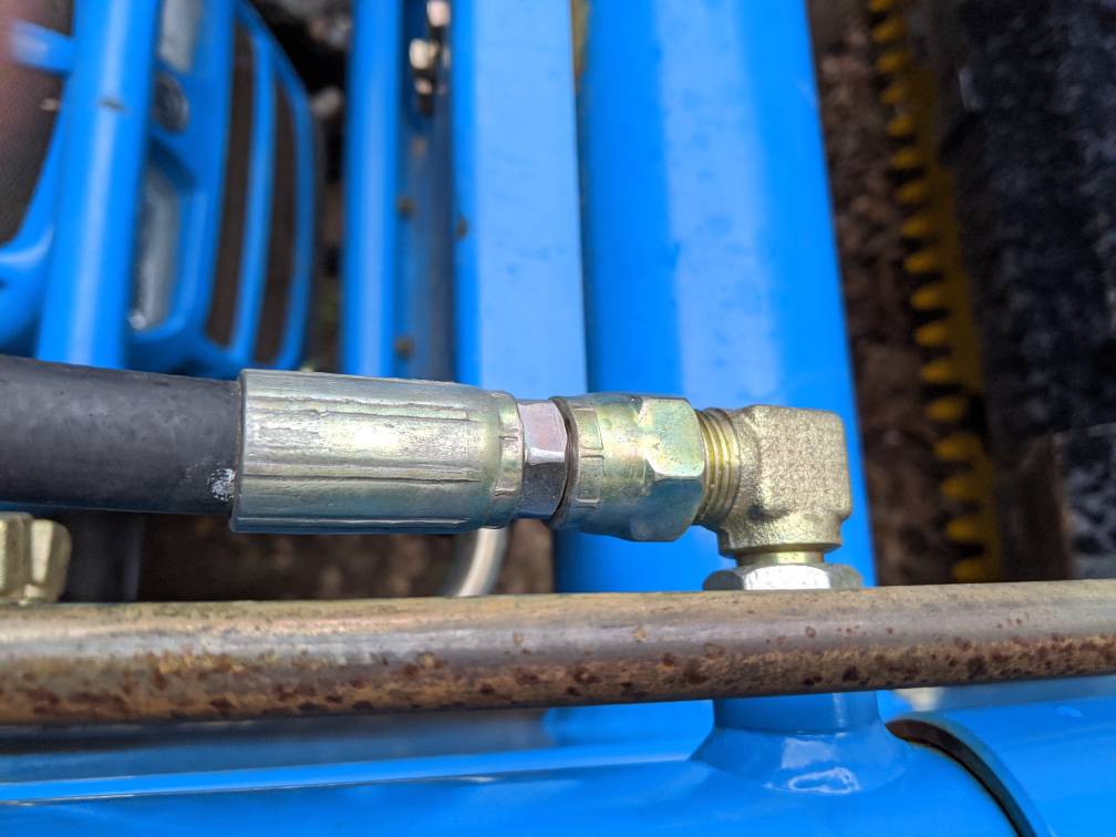

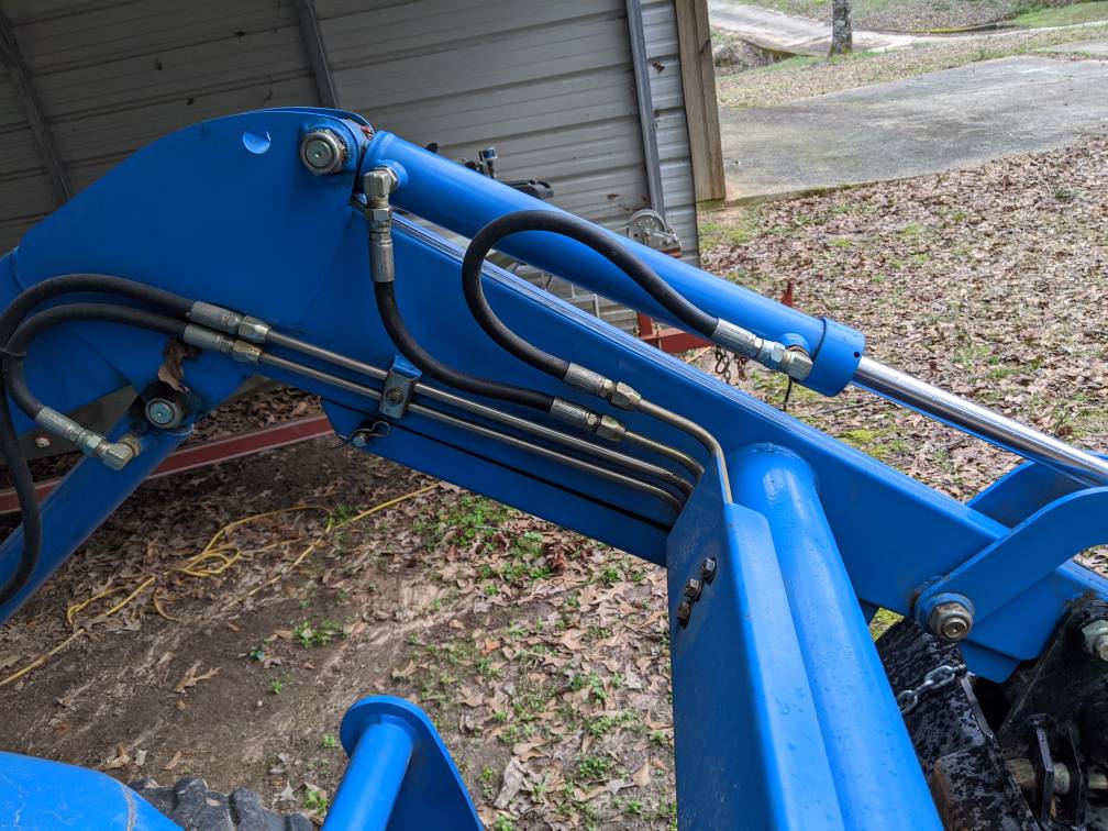

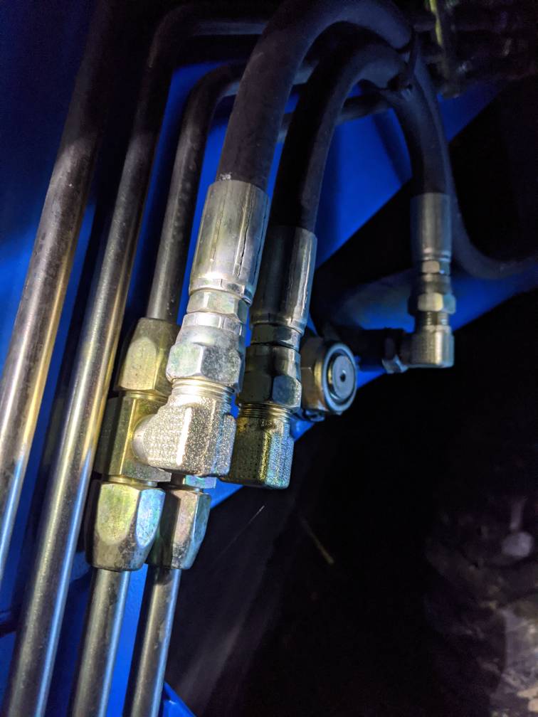

Hi,
I'm finally getting serious about getting a diverter valve and everything else needed for it ordered. I found the summit kit below, but now I'm at a loss as to what I need to get it connected to my tractor, an LS G3038.
Pictured below are my hydraulic circuit, hydraulic parts list, and pictures of the fittings on each end of my lines. The picture of the 90 degree fitting is going into one of the curl cylinders. There's also a link to the grapple I'm probably going to get (I know, it's not EA, but I just can't justify the price difference...). It shows to have 1/2" fittings, but my parts list has 3/8", so can I make that work? I'd get the 54" grapple if that makes a difference.
So, what fittings/couplers (is there a difference?) will I need in addition to the kit? I know I'll need at least two hoses to go from the diverter valve to the curl cylinders and then two more to go to the grapple.
I plan to mount it on the back side of the cross bar pictured below and use the existing hoses to go from the primary control valve to the diverter. Then two new hoses to go back to the cylinders and two more to the grapple. Am I missing anything? I have a bad habit of starting projects like this and not having all the parts, and with living where I do, that usually means several days waiting on parts with a piece of equipment taken apart and out of commission, so I'm trying to avoid that this time!
Thanks for the help!

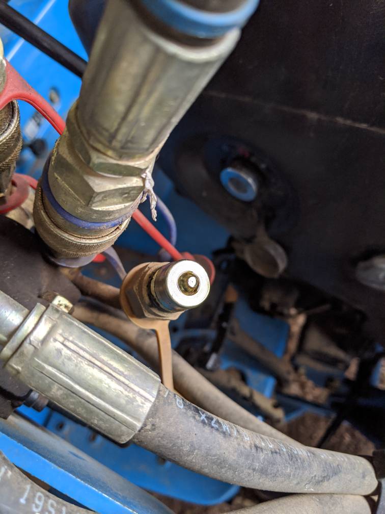

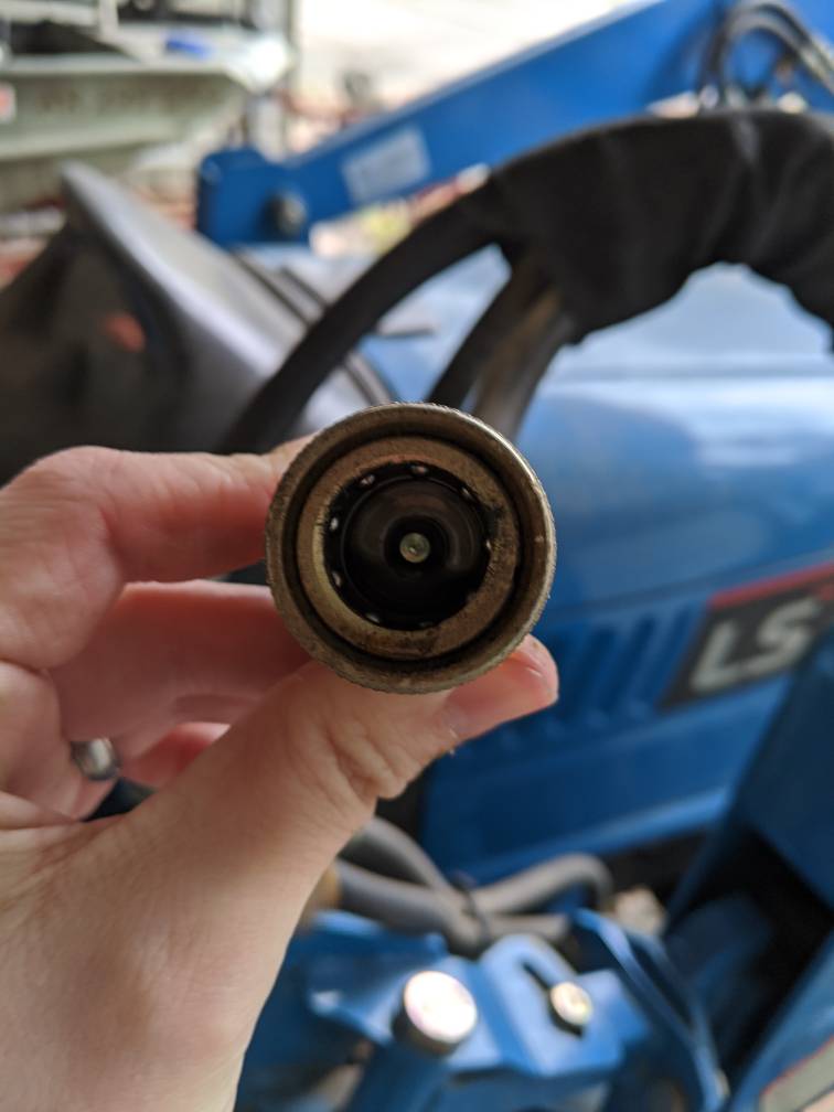

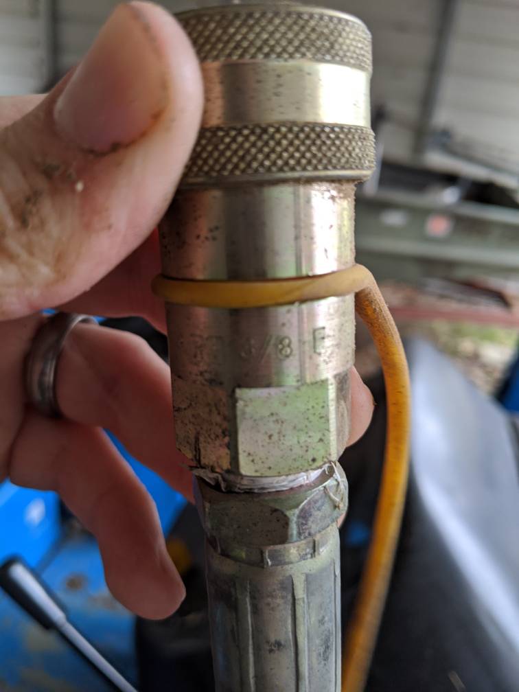

It looks like your loader's quick connects are 3/8. 1/2 is the standard for implements. I'd use 1/2 for the implement end. The existing loader curl hoses from the quick connects to the tee that splits off to the two cylinders may have a JIC fitting. That's what it looks like. The loader on my Branson uses JIC 6 fittings. If you want to reuse those two hoses you'll need to figure out what the fittings are and then buy the right stuff to get it to the diverter. I'd wait to mount the diverter until you have the grapple so you can make sure the diverter will fit and the outlets are in the right place. There's not a huge amount of clearance in there and when you curl and dump the grapple it changes it's position quite a bit. When I ran hoses up from a rear remote to a bulkhead on the loader torque tube I had to make my bracket twice, because what I thought was the right angle turned out to be all wrong.
The existing loader hoses that you want to reuse may be a little too short to reach the diverter when positioned where you want it.
DiscountHydraulicHose has a free fitting guide that you can use to ID fittings.

I'm guessing you are intending to mount the diverter valve on the loader cross tube and tie into the bucket curl cylinders in that area.
I would not swear to it but looking at your LL3104 hydraulic parts I see 3/4-16 UNF threads that thread would be for a
1/2" JIC flare or commonly called a -8 size fitting.
Looking at your pictures they do look like JIC flare fittings.
I usually order my hoses and fittings from Surplus Center.
Good Luck

Good catch on the JIC fittings. I typed in 3/4 16 UNF into Google and got overwhelmed quick. I am curious as to how 3/4 16 UNF translates to 1/2" JIC though? Is the 3/4 not pertaining to inches?

The thread size is the same as a bolt size 3/4" fine thread.
Many of the JIC fittings charts will give you the thread sizes for the various fitting sizes.
/ Fittings/Couplers Question(s)
So the 1/2" is the tube size? Makes sense.

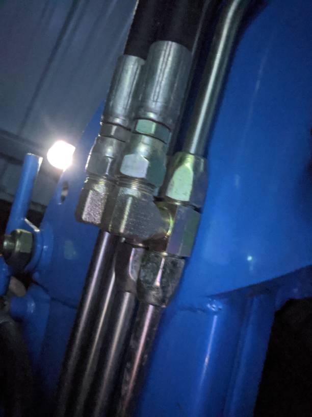

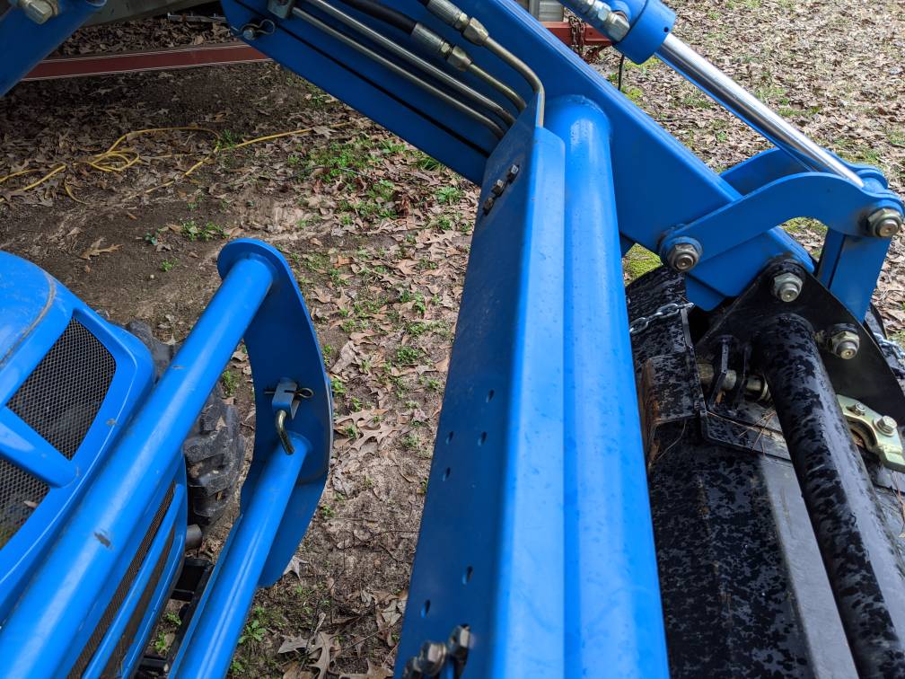

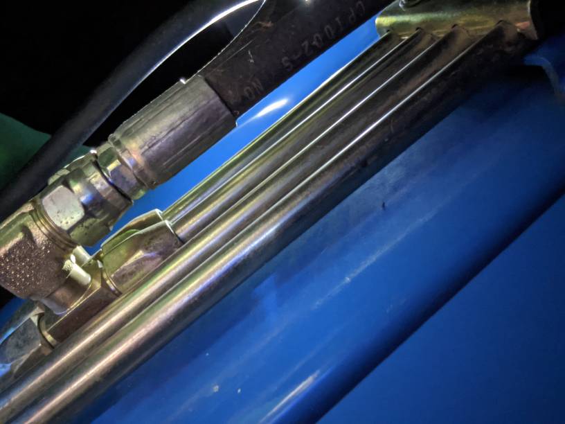

Any suggestions on how how to tie in correctly with mounting on the cross bar? I don't think the original way I'd planned will work. See pictures below of the multi tap connections going to the curl circuit. IMG_20200219_203421.jpegIMG_20200219_203417.jpegIMG_20200219_203402.jpegIMG_20200219_203353.jpeg
/ Fittings/Couplers Question(s) #8

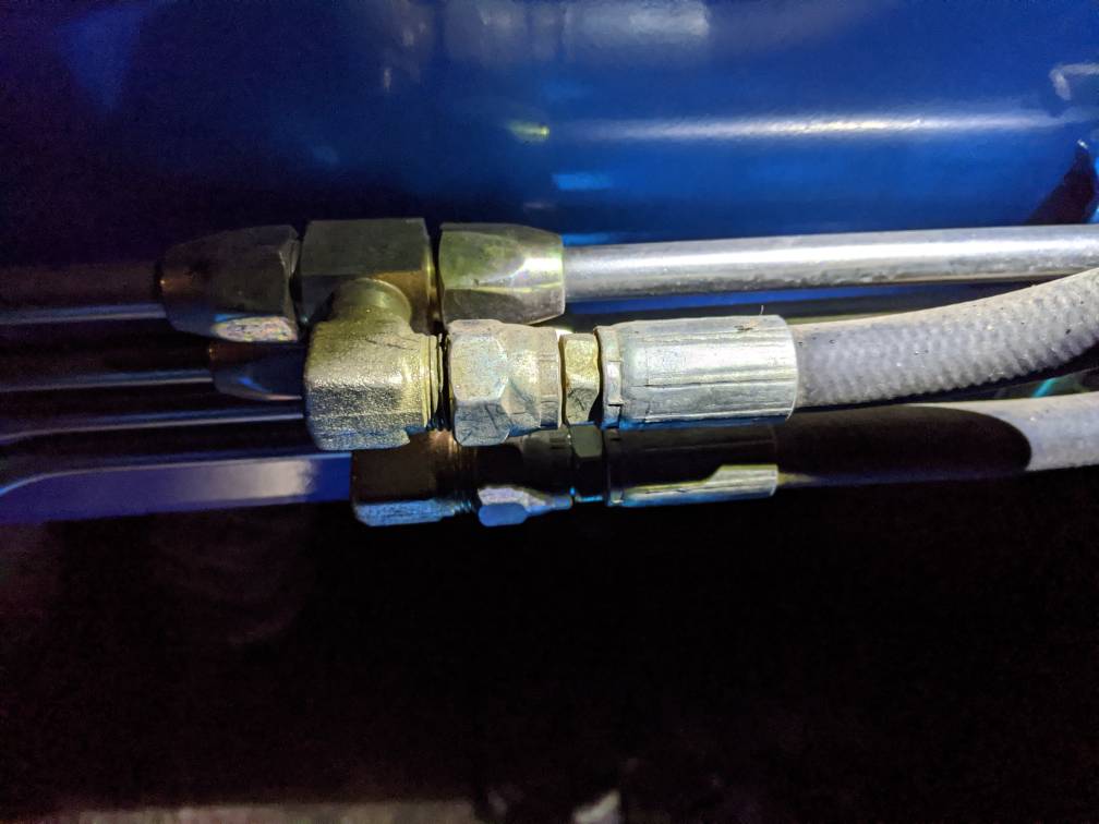

You will need to break into the first set of couplings prior to the curl cylinders,
from the feed lines to the diverter valve from the diverter back to the lines.
Looking at the pictures the steel tee fittings with the hoses going to the curl cylinder,
break apart the Tee, hose to the in port of the diverter, hose from the diverter straight thru port back to the input side of the tee.
For both Tee's.
So from the steel lines with hoses to the diverter, hoses back to the tee' from the diverter,
then either the quick connects or hoses to quick connects from the diverter secondary ports.

Ok, that makes sense for sure. Any advice on how to make room for all that seeing as what's there currently is rigid pipe?
/ Fittings/Couplers Question(s) #11
I'd use the same hose size as the existing loader hoses. It's probably 3/8 or maybe 5/16 like mine. You don't need 1/2 all the way, it doesn't flow that much. The smaller hoses will be easier to route and cost less too. You will need 3/8 quick connects to plug into the loader quick connects.
If you're clever and the stock stuff is routed right, you can use the existing hard lines with your diverter. You'll need short hoses from the diverter to the tees to the cylinders.
Rather than guessing on hose lengths, use a piece of old garden hose to mock up the routing and measure that. Surpluscenter sells hoses in 6" and 1' increments. That's the least expensive option. DiscountHydraulicHose is a better deal for custom lengths. I dislike NPT for hydraulics- you have to tighten the heck out of them and use a sealant to get them to seal. I use adaptors for NPT fitting like quick connects and then use JIC for everything else. Hoses with female JIC swivel ends are super common and almost as cheap and ones with plain NPT.

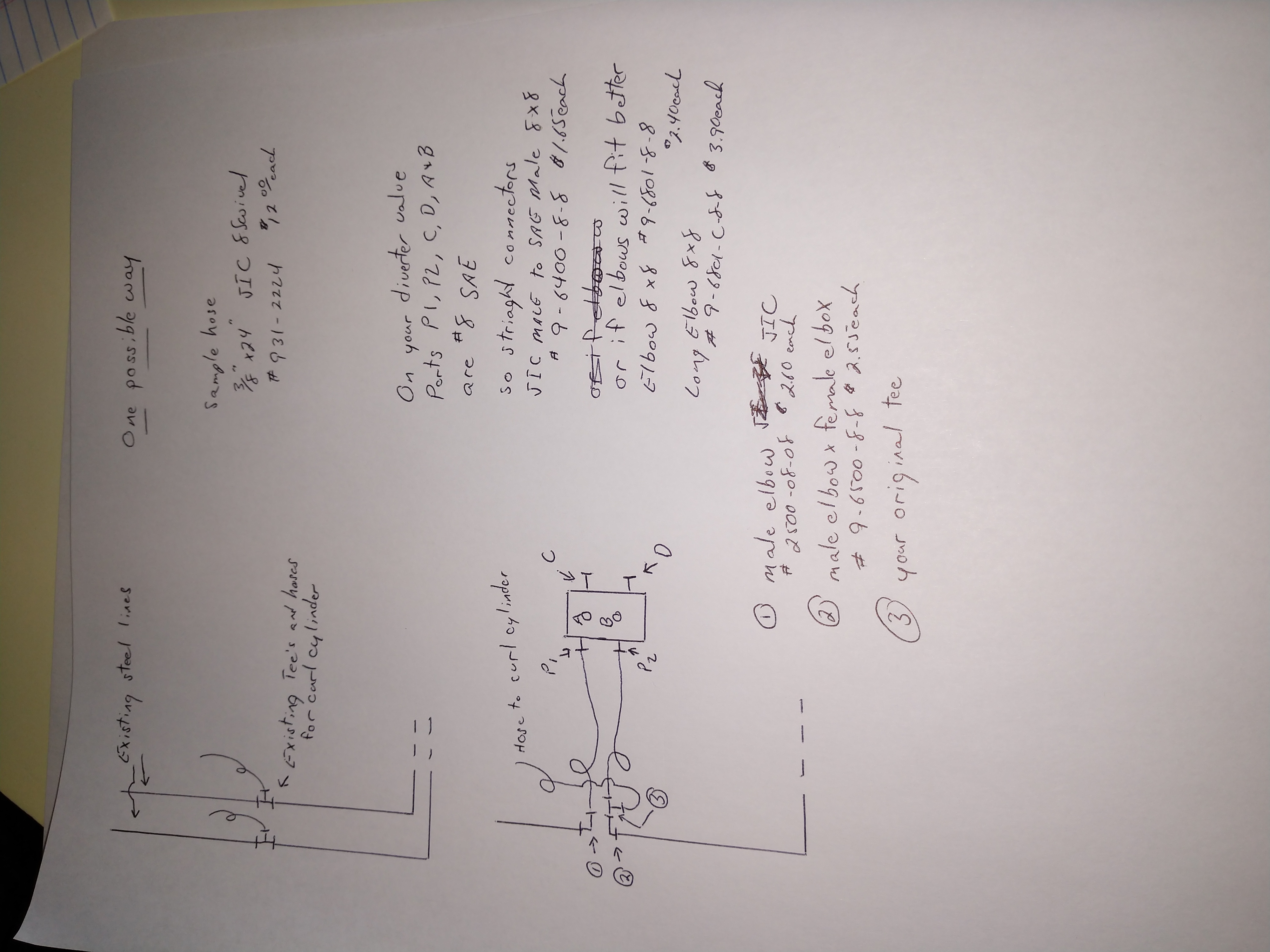

OK we will see if this works, I did a quick sketch of one possible way that should work may not be the best.
All the part numbers and pricing that I included are from Surplus Center just for information not necessarily a recommendation.
good luck
/ Fittings/Couplers Question(s) #13
Oh almost forgot your diverter has a #4 drain line which should return to your tank,
I don't know if it would impair the function if just plugged off.
The diverters that I have purchased and used from Bailey Hydraulics did not have a drain port.

You shouldn't need 3/8 quick connects as you say you are not undoing the ones at the valve.
Why would you want hoses with two different ends?
Are you trying to fit the hoses to your diverter without using fittings?
Hoses with female JIC swivels allow you to make up your hoses to fittings on both ends, simply by tightening the female swivels.
/ Fittings/Couplers Question(s) #16
Buy SAE or NPT or whatever you need to JIC adaptors and then use JIC hoses. 1/2" quick connect is the standard for ag implements. Surpluscenter has good prices on hydraulic fittings.
Use LocTite 545 on the NPT threads. It works much better than teflon pipe dope and does not risk getting pieces in the hydraulics like with teflon tape.
/ Fittings/Couplers Question(s) #17
Why will I need 3/8 quick connections for the loader? I don't plan on undoing the quick connects at the control valve.
I thought you were replacing the curl hoses that run from the loader valve to the tees. You can reuse the existing 3/8 QCs on your new longer hoses or if you can reuse those hoses then of course you won't need them.

Looking at your sketch, wouldn't the return going back into the T come from Port C instead of P2? I thought P1 and P2 were your incoming ports, and C and D went to the top and bottom of your curl cylinders, and A and B went to the open and close of the grapple.
/ Fittings/Couplers Question(s) #19
Yes it would, opps glad you caught that
