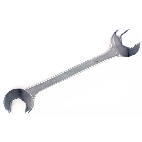

I would try 2 1" flat stock with a hole in the center of each run a bolt with a spacer between the 2 so that the flat stock doesn't bow out. This is after you line the fittings flats inline with each other. A 90 deg open wench might help getting them in line.
Yes, the above is close to what I was going to suggest. You can buy right angle open end wrench adapters, use one on each fitting, put a carriage bolt head through the hole on each wrench end, and fit a plate between each, and use nylock nuts to secure the plate to the two opposite facing wrench end adapters. This way neither fitting can move from where it's set.

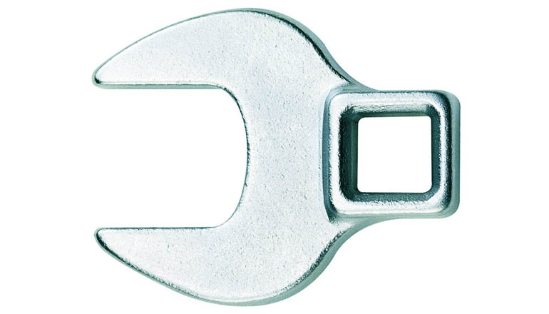

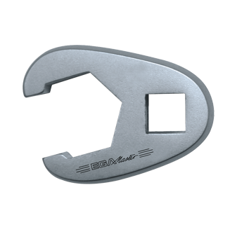

crows foot wrench.jpgLlaves-_LLAVE_HEXAGONAL_CROW_FOOT_-LLAVE_HEXAGONAL_CROW_FOOT.png
Crowfoot, straight and flare nut
