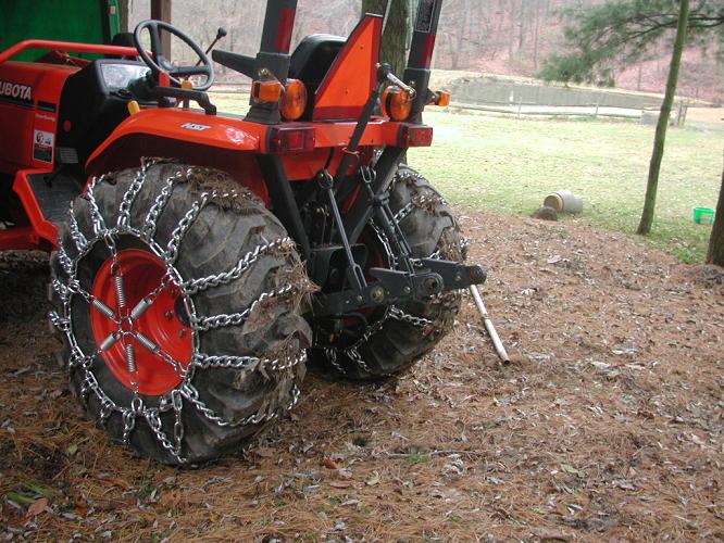

John,
If you have a lot of clearance then you don't need tensioners. My neighbor, for example, just leaves his flop around and it seems to clear the snow/ice/mud off his tires real well. I would call them sloppy loose, but they work for him on his 38 pto HP International.
In my case with my B2910, I need the tensioners due to close clearances. I think I like the chains tight anyway.
You cannot cut the cross chains [well, I guess you could with a gas axe] and the way I was told to shorten mine was to remove the cross chains as required to shorten the chains to fit my tires, and then to use bolt cutters to shorten the side chains.
The cross chains come off pretty easily if you can pry open the ends with something. I held them in a vise and used a small pry bar.
I got my chains and tensioners from tirechains.com. I don't know if you are looking for ladder or duo-grip chains. Not sure if duo-grips are shortened differently than ladders or not. You may not have to shorten anything, depend on what the supplier ships you.
I have attached a photo showing my chains and tensioners.

Henro,
Looks like most of the chain gets "lost" down between the treads /forums/images/graemlins/confused.gif
I bought an old rusty set at auction for my turfs, had to do some work on them to get them to fit, but they do. I just haven't used them yet.
I bought 2 sets actually for $30. I don't need the other set. Figured I'd use them for fronts, if it got THAt bad here. They won't fit though.

<font color="blue">Looks like most of the chain gets "lost" down between the treads </font>
Jerry,
Yes, some is lost between the lugs of the R4s. I can't see any way around it. But enough is on top of the lugs, roughly about half of each cross chain, to give a pretty good bite. World of difference. After a pretty good slide last year [wet grass on slope] I started putting my chains on in the fall well before the first snow, and leaving them on until after the April showers have ended.
