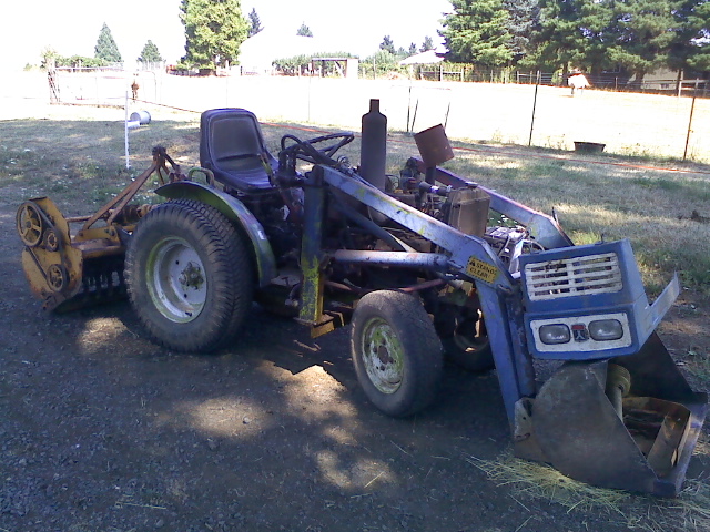

Hello Everyone, Just bought a 80 1500 Deisel 2cyl 4whld, The 3 point wont stay in the up position for more than 2 min?, any quick fix?, thankyou, jack, Plus I sure would like to see what these green things looked like when it was new!?, Ide like to Restore, Thankyou, jack, In Oregon

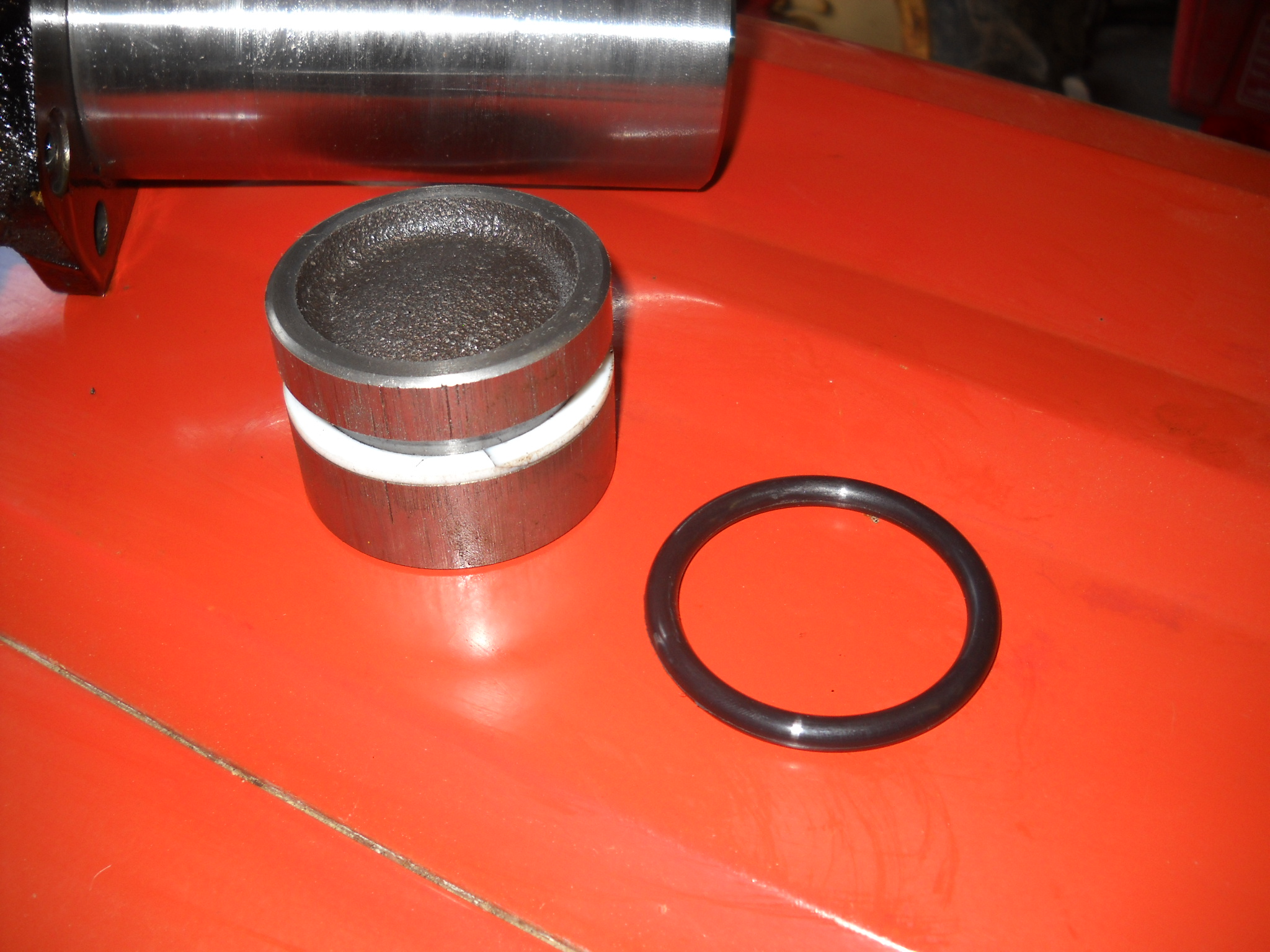

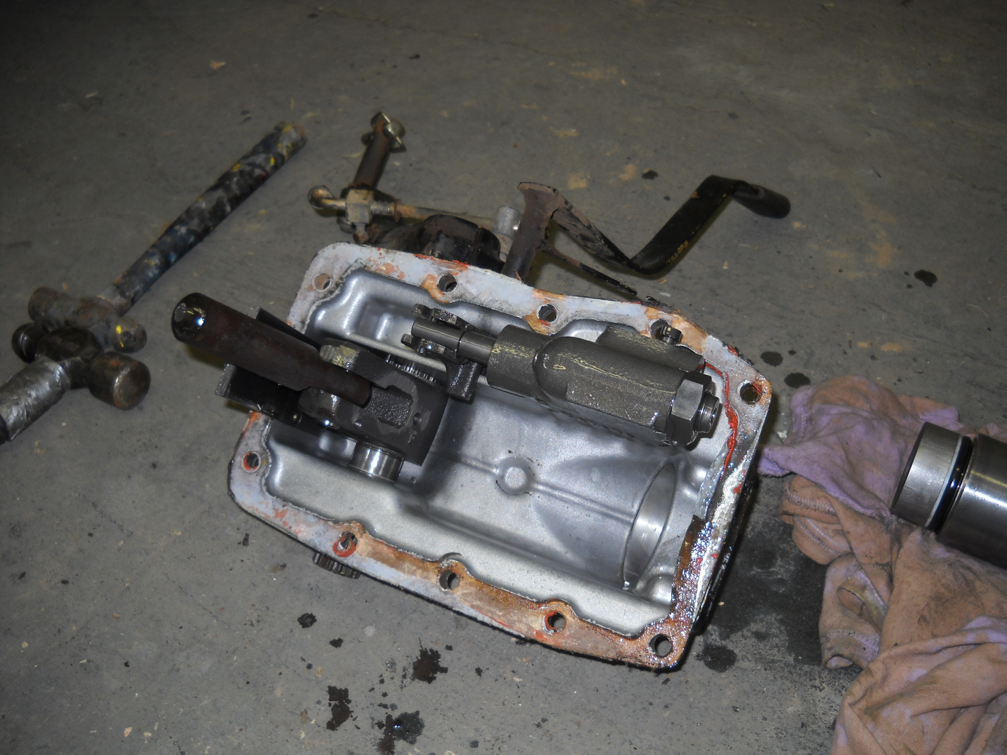

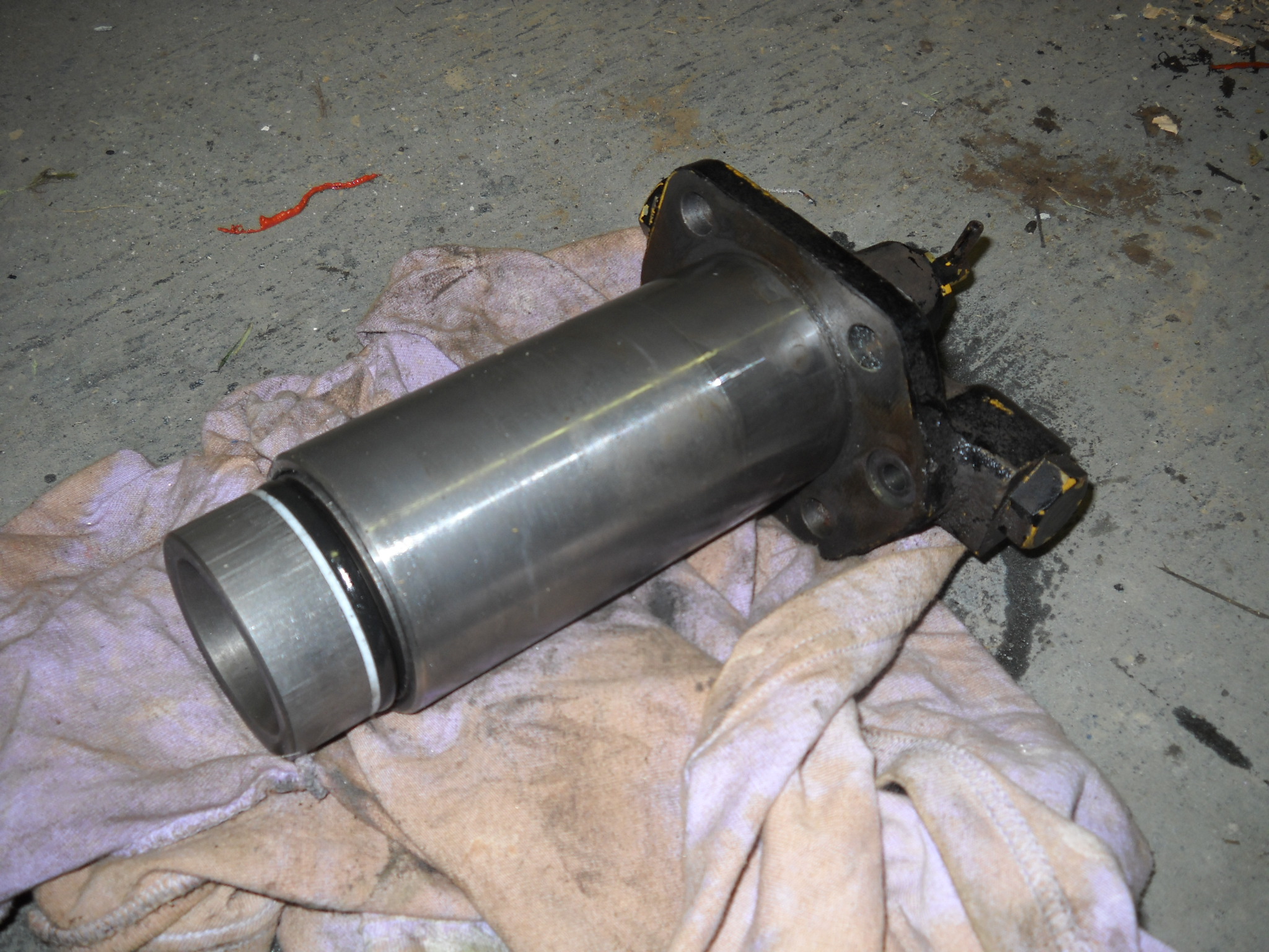

:welcome: to TBN fellow Oregonian! :thumbsup: My assumption on the 3 point hitch is a leaky hydraulic valve or a bad seal around the piston. Does it lift a considerable amt. of weight off the 3 point hitch or is it weak? My 3 point hitch on my 169D was very weak and it ended up being a $4 O-ring that goes around the piston and seals off pressure inside the cylinder. The cylinder is directly under the seat. It is a pretty simple repair, I did it in 1 day including locating the new O-ring. :) As for paint on your Yanmar, it came in either red or green from the factory. Yours appears to be originally green but I am not sure where you could get an exact match to it. Yanmar Tractor Parts - Shop Online sells exact match Yanmar red paint if you would like a pretty red tractor. Either way, welcome to the forum, glad to have you aboard!. :thumbsup:

The picture you posted actually is a 155D, not a 1500D, that is good. For parts, check out this link.
http://www.hoyetractor.com/mm5/merchant.mvc?Screen=CTGY&Store_Code=HTE&Category_Code=155
The 155D is a domestic Yanmar which means it was intended for the U.S. market. The 1500D was a grey market tractor which means it was intended for use in Japan, not the U.S. Parts availability is probably about the same, a lot of 1500's have been imported here.
