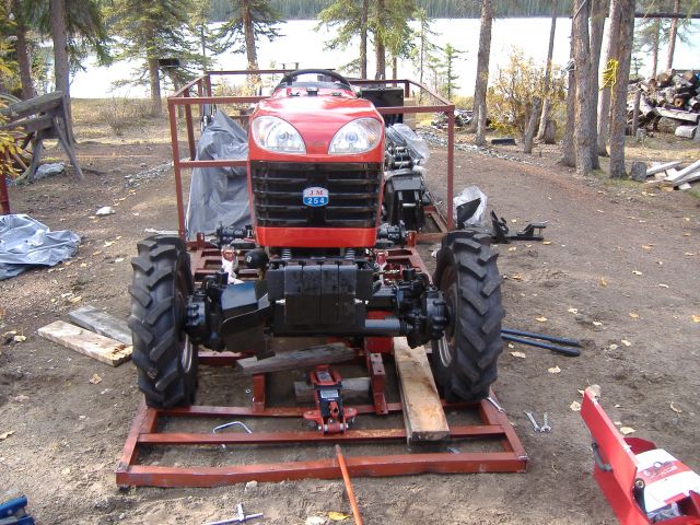

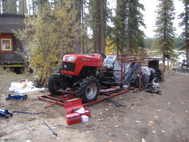

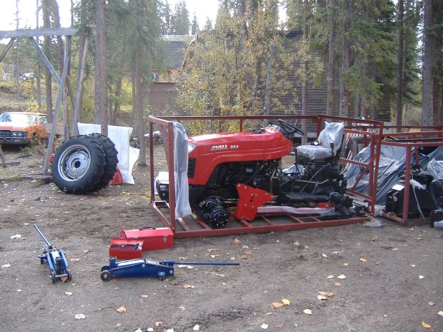

Here Goes

/ First Tractor Purchase #8
Congratulations ........
Give her a good service and prep before you put to work and she should make you a good little tractor.
As you service and assembile I would go ahead and set the tractor up for your intended use.

/ First Tractor Purchase #9
congrats.
Interesting hood/headlight shape... It also looks like they armored the steering cylinder as it appears to have a steel sleeve over the rod end.
Well this morning I got her fired up. Started good, all seems in order. Funny thing I was as suprised as you all about the hood headlight setup. Also it came with the battery in, hood on, "ready to run", the diesel in the sediment bowl looks very questionable for sure.
This was a direct personal import straight from the manufacturer. I ordered it in blue but it ended up red, no big deal. So far I am impressed with the machine.
