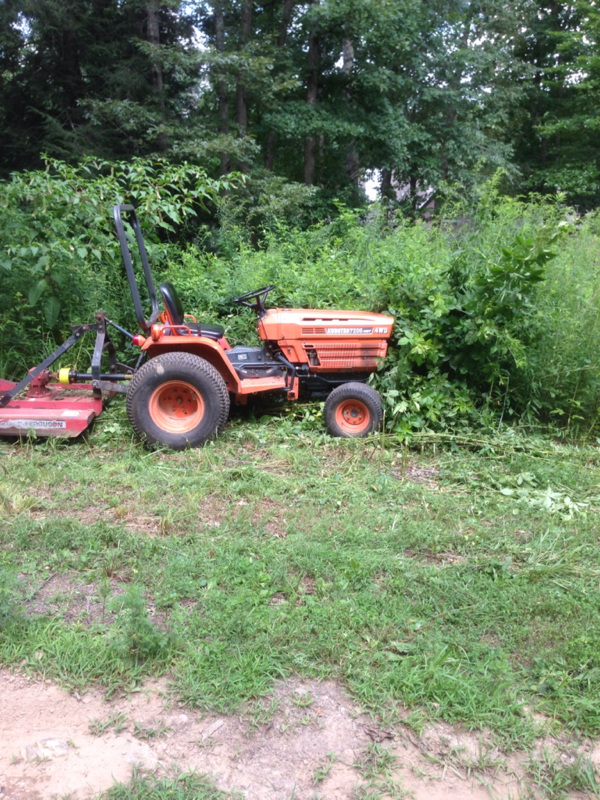

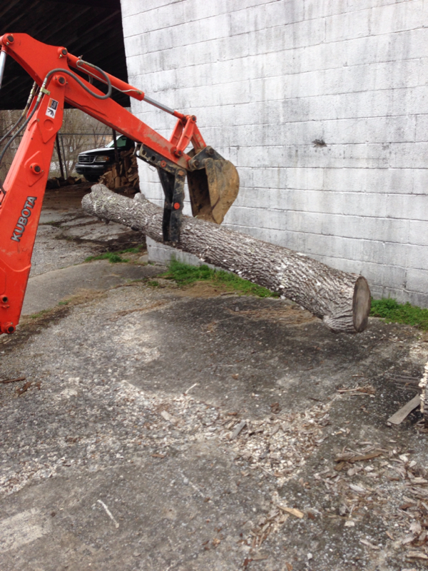

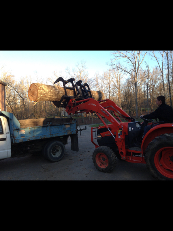

I've got a L and B. The L is better for anything that involves actual work. The B is primarily used for mowing. The L is used for most of the bush hogging because the 3' cuter on the B is a lot slower. My B doesn't have a loader, but I've used one that did. I'd highly recommend skipping the MMM and getting a RFM or separate mower. I would be disappointed with the small tires on a BX. I would have been stuck many times over with small tires on my B. image-1360185985.jpgImageUploadedByTractorByNet1475883627.880310.jpg image-2232482205.jpg image-1549818422.jpg image-3790258078.jpg

I've got a L and B. The L is better for anything that involves actual work. The B is primarily used for mowing. The L is used for most of the bush hogging because the 3' cuter on the B is a lot slower. My B doesn't have a loader, but I've used one that did. I'd highly recommend skipping the MMM and getting a RFM or separate mower. I would be disappointed with the small tires on a BX. I would have been stuck many times over with small tires on my B. View attachment 483883View attachment 483884 View attachment 483885 View attachment 483886 View attachment 483887
I have no doubt the L will do more work since it has grapples, a loader and a backhoe. :laughing: compared to the no loader B ... come on man.. :laughing:Nice Rigs though.,:thumbsup:

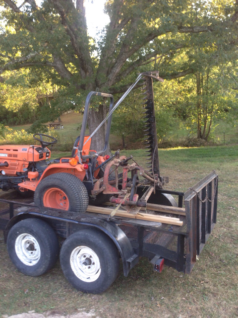

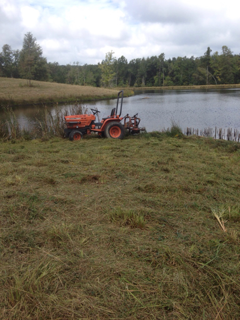

Even if the B had a loader and backhoe how do you think it would hold up to the L? The B certainly has it's advantages. It only weighs 1200 pounds. Weight is usually a plus, but not when I'm trying to drive it in the water around a pond bank. It's tough as nails. Despite severe punishment I've been unable to tear it up. It's relatively cheap compared to the L. Biggest plus it's easily hauled on my lawn mower trailer behind a 1/2 ton. My trailer loaded with the L weighs 11,000 pounds.ImageUploadedByTractorByNet1475892223.478960.jpg
If the B had a loader and a backhoe I think it would easily do what the OP needs it to. Agree, weight is a plus for a lot of tractor things though mowing not one of them.
