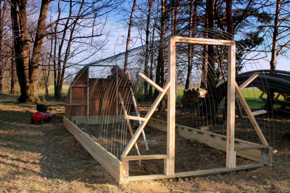

Here's an in-progress picture of the chicken house I'm building for 62 chickens. The PHD started it all with 6 holes in the ground and is officially my first tractor project.

many of my pens are built with those heavy welded wire panels too!
I've seen a lot of people build these hoop houses on skids for portability. For the past 2 winters, though, we've been getting 60-70 mph straight-line winds. As such, I wanted this sunk in the ground with concrete.
