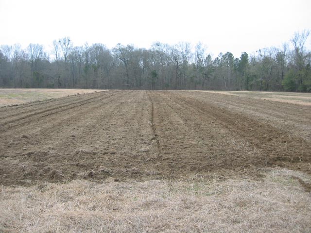

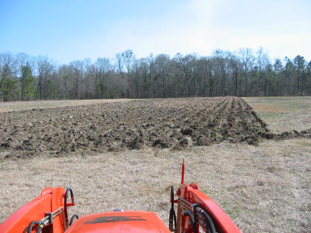

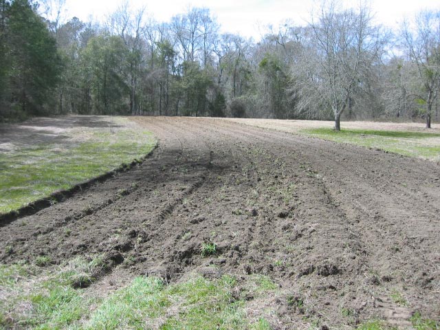

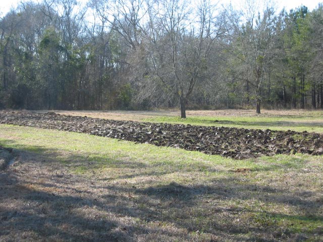

Thought I'd share some of my art-work with you. My first time using my turning plow and 6' tiller and although it wore me out, I had a ball and was quite impressed with myself, not to mention my KD40.
The pics will show where I turned them, then it will show the results after tilling. My objectives were to learn how to use the implements, (setup, speed, etc.) and approximately how long it would take me. The large plot is exactly 1 acre. That gave me my reference, and that should decrease some now that I know a little more.
All the plots will be food plots for deer, turkey, dove, quail, and whatever else infiltrates.
The KD worked flawlessly. I was worried that it might not be strong enough to pull a dbl bladed plow. I got on here and asked about that and got a positive return. I have not broke the KD in yet so I didn't want to work it too hard, so I never operated over 2000rpm. In 4wd, it pulled it like a hot knife through butter. The tiller is supposed to work at 540rpm which requires 2600 on the 40. Like I said, I never exceeded 2000. You can see the results.

Like I said, my first time. This ground hasn't been turned in a little more than 5 years. I was plenty nervous because I'd only seen a few videos, but once I got the blades set right, all I had to do was hold it straight (which isn't very easy to do) and let the tractor do the work. Hanging on while tilling is what I think wore me out. I found myself all tensed up. Once I figured that out, I started attempting to relax. It went much better after that. Boy did I have fun. Now I've got to till it again to kill weed seeds, then I get to use my spreader for fertilizer and seed. Can't wait!

Like I said, I'm new at this.:confused: Just made sense to me to pick out a tree on the far side and try to head straight to it.:eek::eek: When plowing though, the tractor is pulling hard to one side. Don't know if that is to be expected or if I was going about something wrong, but I still held it in there. I was right proud of the results.
/ First time plowing/tilling w/ DK40se #15
The only way to do it. Never concentrate directly in front of you.
It is normal for the tractor to pull hard to one side while plowing.
The other thing about plowing is, if you worked from the inside of your field towards the outside this year, work from the outside back towards the inside next year. It doesn't seem like much but, you are moving all of your dirt over a foot or so with each pass. Over the course of several years you will have a hilly field.
