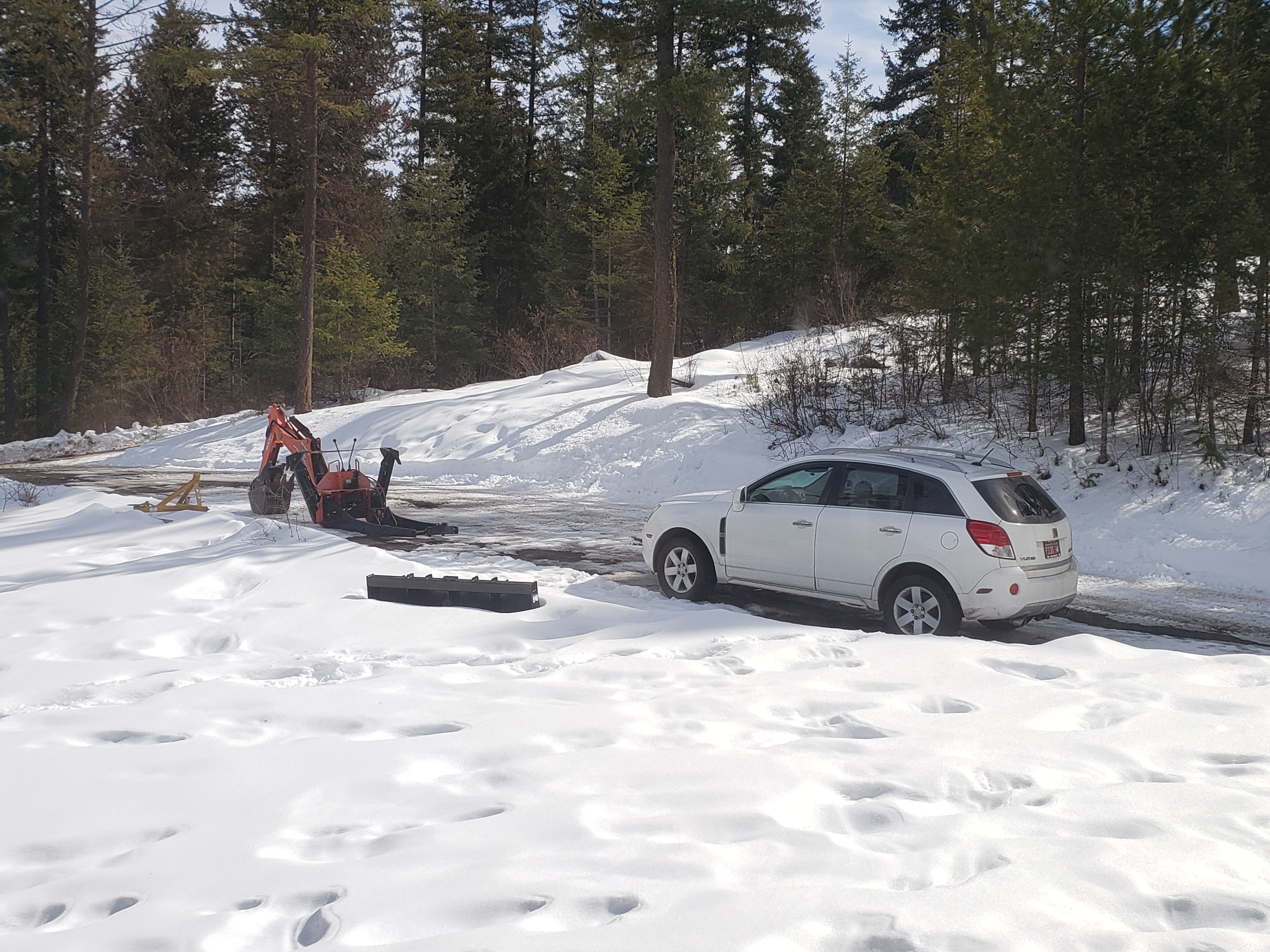

The heaviest thing I lifted was my backhoe attachment. The Wood's BX90-X with a subframe bolted to it. We brought it home from the dealer (it was on consignment) on a flat deck car hauler trailer, and I used my "crane" attachment on the FEL. Puts the shackle about 2-1/2 feet from the pins. Rigged it up with a bunch of straps to the shackle. I had the (at the time) heaviest 3pt attachment I have, the rototiller on the back. Plus beat juice filled tires.
My plan was to simply pick the BH up, back up from the trailer, drive to where I wanted it set down (in the "lot" where I keep my implements) and be done with the job. That was not going to happen. When I started picking the BH, I realized that this thing is MUCH heavier than I anticipated. I was only able to take the pressure off the trailer suspension!!! The tractor just couldnt do it.
We re-rigged it a few times, trying different things. Was able to get the rear of the BH up off the deck just slightly, and my friend drove the trailer out from under it. Fortunately, it didn't come crashing down when the front (bucket end) of the BH came off the back of the trailer. I was able to drive it, slowly forward, and set it down on the side of my driveway. If it had dropped down suddenly, it was only maybe 2ft off the ground, so I wasnt too worried. But was an eye opener of (1) just how heavy this BH was. (2) just how much length from the pins effects the lifting capacity of the FEL. And (3) just how important rear ballast really is when picking heavy loads.
I could not have picked this backhoe with nothing, or even a lighter implement on the back.
Backhoe sitting where I left it. This was a long time ago, fyi.
