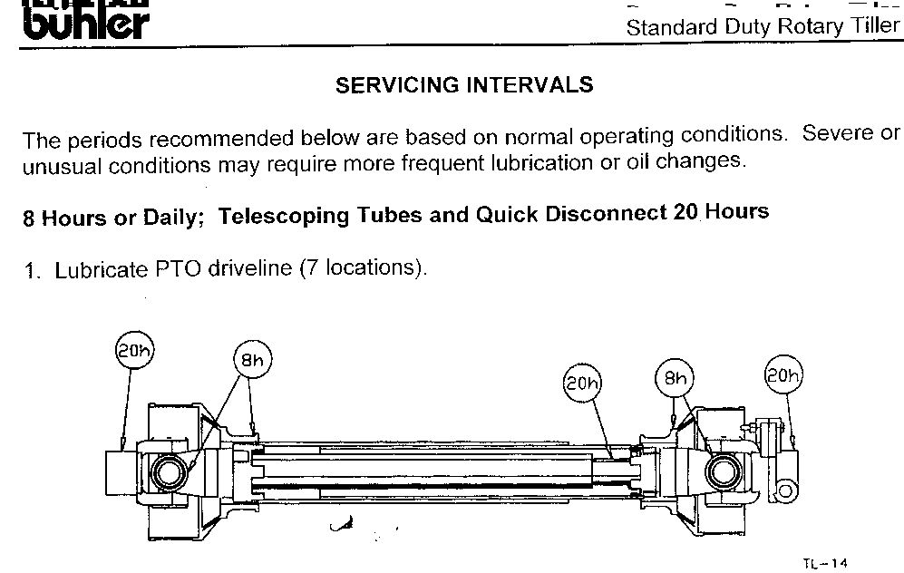

Hello,
I'm not sure if this can help but I scaned the PTO Shaft maintenance section in my onwer's manual...
Hypernix

There's also a break-in section in my manual (the manual is for a Buhler Farm King Standard Duty Tiller)
A. After operating for 1/2 hout or after completing 1/2 acre:
1. Check all nuts, bolts and other fastners. Tighten to their specified torque level.
2. Check that the blades are in good condition and bolted securely to the rotor.
3. Check the oil level in the gear box. Add as required.
4. Check that the PTO driveline shield turns freely.
5. Lubricate all grease points.
B. After opretating for 5 hours and 10 hours.
1. Repeat items 1 through 5 of section A.
2. Then go to the regular service schedule as defined in Section 5.
Section 5 Servicing Intervals
After 8 hours or daily:
1. Lubricate PTO driveline (Check above post for picture)
After 80 hours or once every season:
1. Lubricate rotor berings and chain drive (3 locations).
After 40 hours
1. Check gear box oil level
2. Add approximately 10 squirts of grease to chain case.
Anually
1. Change gear box oil. Refil with SAE 85W90 gear oil
2. Wash machine!
Hypernix
