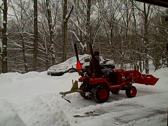

Plowing snow with a BX-25 and back blade brings back cold memories.
