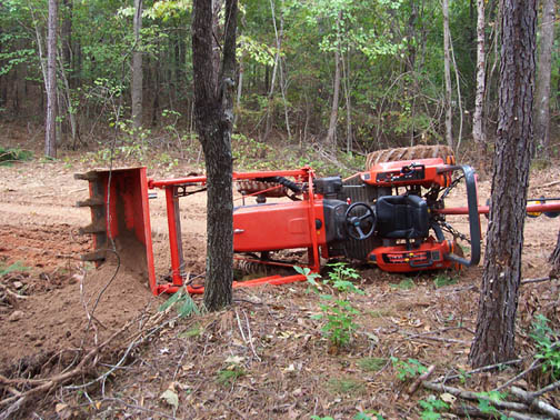

Evening Guys,
Thought I'd show you how my afternoon went.

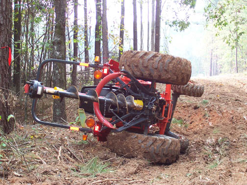

2nd

Sorry to see that /forums/images/graemlins/shocked.gif
Are you OK? Hope so!
How did you put it on its side? Full loader up to high?
/ First Rollover!!
Waiting for the guy whose pulling stumps for me to get me upright with his bulldozer.
In the meantime, how about some tips on the recovery process. I'll drain the oil, pull the points, check all fluids, anything else I should know about before I try and start her up again?
/ First Rollover!!
Thanks, I am. I was wearing my seat belt, and all things considered, it was a pretty gentle ride! /forums/images/graemlins/blush.gif The bucket wasn't high, but probably higher than it needed to be. I was filling in some ruts on a new road we cut to the back pasture, and on the 7th run, I got too close to the mud! /forums/images/graemlins/frown.gif /forums/images/graemlins/frown.gif The front left wheel just disappeared into the mud. My first reaction was to try and reverse, but that proved useless. I then thought to lower the bucket and use it to stabilize the front end, but by the time the brain kicked in, I was already on my side. /forums/images/graemlins/blush.gif /forums/images/graemlins/frown.gif /forums/images/graemlins/blush.gif.

Sorry to see your tractor on its side. Are your rear tires loaded? If it were me, I'd get it right side up ASAP, even if it meant paying someone. Check the coolant level, as well as the tranny and front diff. Did you loose any fluids? Oil, fuel, antifreeze, trans fluid, etc
/ First Rollover!!
JJT,
Unfortunately, I have fuel and oil dripping out now. I don't see any hydro fluid, but that could just be because of the position. I'll send an update as soon as I have her back up.

Sure appears you need some more ballast on the rear end. PHD won't do the trick, it appears. And first instincts to lower the FEL are very helpful to know when the rear wheels leave the ground. To me, that is sometimes not instinctive enough, but has been a 'saving' factor for me several times.
Appears to be a "lay over" and not a Rollover. I know, it's a technicality, but hey, a rollover is 'over'. I don't think you should find too many things seriously wrong (at least I hope not). But checking the fluids and topping them off, after letting it set upright on all fours should get you going again.
Glad no-one was hurt.

Thanks! You're right, I was asking for trouble! /forums/images/graemlins/blush.gif PHD was completely the wrong thing to have on the back end. Trying to do too many things in one afternoon, and found the perect compination of things to teach me better!! You're also right about the layover. Actually, it was more of a squishover. The mud laid me down pretty gentley. I guess it's the tractor gods giving me a smack in the back of the head. Not too hard, but enough to teach me a lesson. Anything specific that you know of that that might be damaged from having the engine/tranny sit on its side like this??
/ First Rollover!!
beenthere,
The rear tires are loaded btw. Supposedly 300lbs of windshield washer fluid. Obviously not enough to make a difference this time.
/ First Rollover!! #11
I would talk to the dealer about what to watch for when starting it up the first time. But I don't think you should have any problem.
I too have full rear tires, and when the full ballast box was on, I tipped the nose down the other day removing a pallet of shingles off a truck. Lifted it (barely) and I backed away on blacktop. Stopped and the stop rocked the load down slightly enough to start the rear wheels up, whereas I let the loader down. Hit the ground, but didn't hit too hard. Any other reaction would have probably meant posting pictures like yours.

Having been there and done that, I know exactly the feeling that you have experienced. The good part is that you were not injured. I was thrown from the tractor and landed in soft dirt. I not sure what hurt more.... my pride or my body. I was able to right my tractor with my Oliver OC3 and my F250 4x4. Mine was a 8000 pound Minneapolis Moline, so yours shouldn't present much of a problem to upright. Once you have it back on all 4's, the only problem that I can see is the oil might have leaked past the rings into the upper part of the cylinders. If this has happened and you try to start it, you might cause a hydraulic lock problem and bend a connecting rod. If it were mine, I would pull the injectors and then crank it over. No need to mention to check all fluids first, you already know that. Actually, I would drain and refill the crankcase. Measure the amount that comes out and that will give you a better idea of how much you lost. It will not take into consideration how much is on the ground. Also keep this accident to yourself, you don't want the state EPA coming in to do a environmental hazardous waste clean up. Just dig out the soil and hide it somewhere. Considering that you went over in soft ground, I doubt that there will be any lasting scars on the machine. If it is still under warranty, you might not want to clue in the selling dealer as to what happened. That way, if you have a problem down the road, he can't blame in on the accident. Any good diesel mechanic can give you advise and help on the engine situation and you don't have to consult with the dealer. Removing the injectors shouldn't cost very much. About 2 hours or less total to R&R them. If the batter has spilled acid, then neutralize it with baking soda. Since the battery is relatively new, I would add new electrolyte to replace what has spilled. Wash everything well with dish washing soap and water.
/ First Rollover!! #19
I'm like Junkman, I wonder about oil in the cylinders of the engine. If you try to start it and they have oil in them, you run a chance of busting the pistons. Pulling the injectors is a good idea, concerting the amount of time the tractor has been on it's side.

Thanks guys, that's great advise!! I thought about the oil possibly leaking into the cylinders, but I didn't realize the damage could be that severe. /forums/images/graemlins/shocked.gif I'll pull the injectors first thing tomorrow. The guy that will pull me out was going to come by tonight, but had an emergency and won't be by until the morning. I'm sure that if oil leaking past the rings can happen, it will happen after all this time. The nice thing is that we shouldn't have much of a problem getting her back on her feet.
