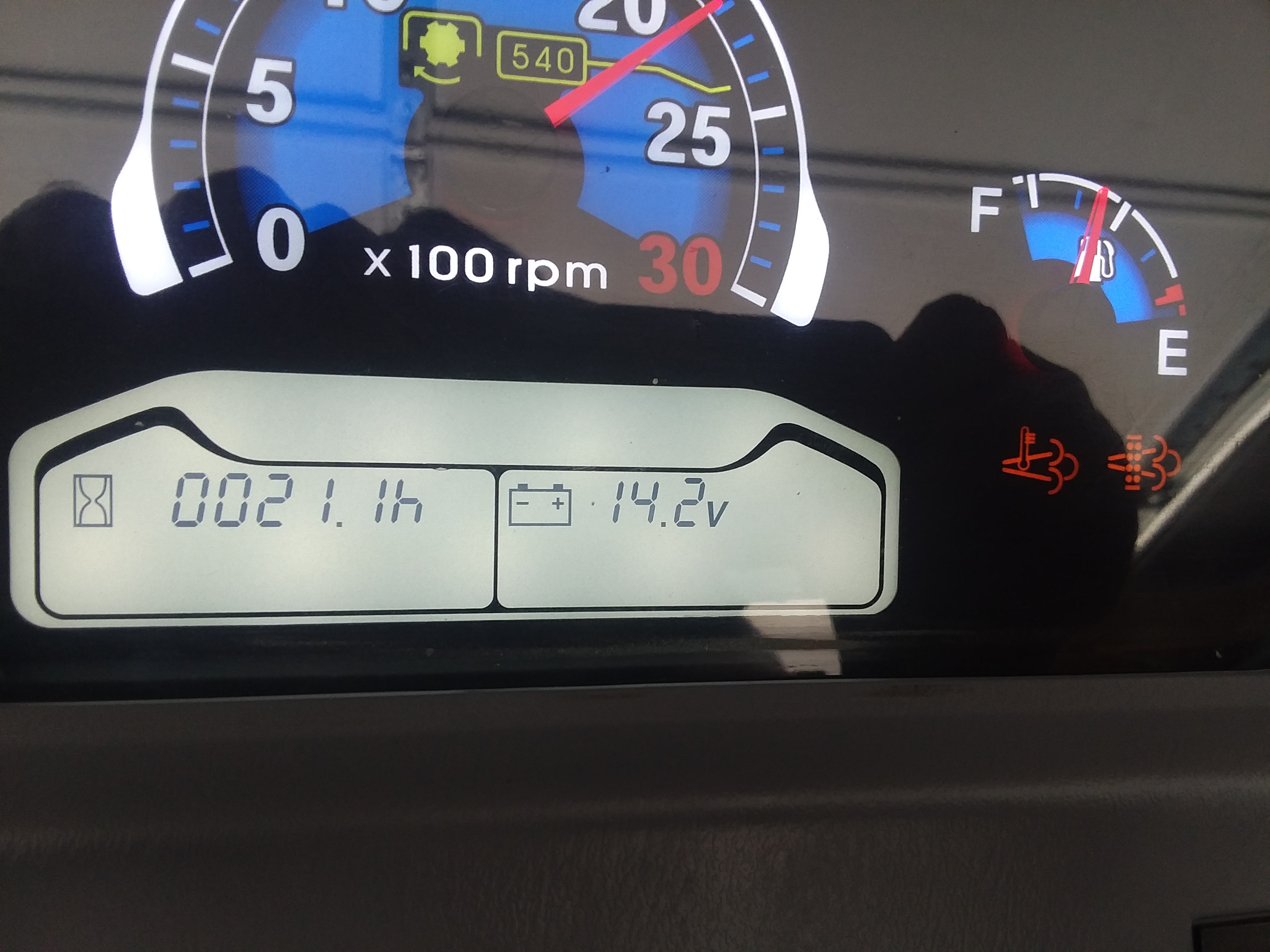

Was doing some loader work and it started to make some funny sounds, lights came on. Puff of smoke and it stank . Thought I broke something at first. Anyone else had a regen this early. It only lasted between 5 and 10 minutes.

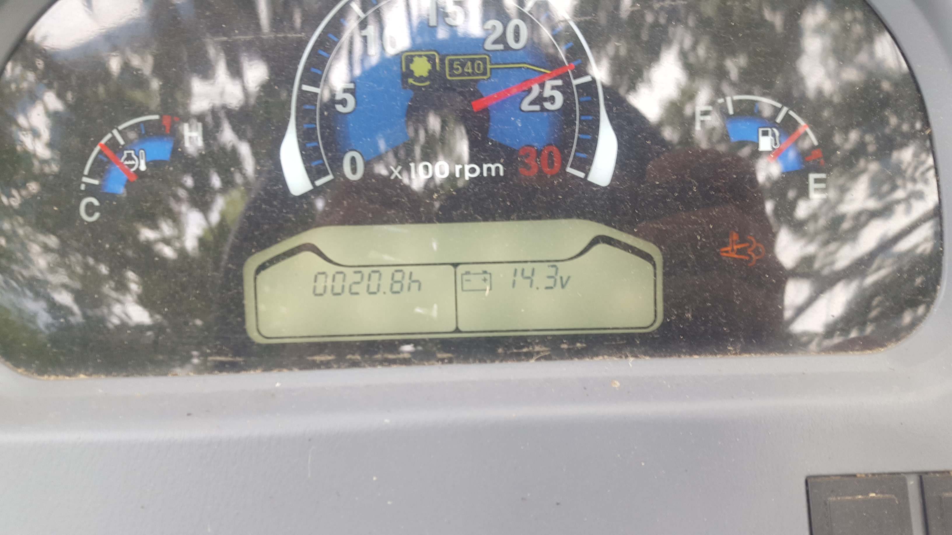

This is pretty ironic. I was coming here to post the exact same thing; I don't know whether it's better forum etiquette to create a duplicate thread or highjack this one.
I have a brand new LS XR4140H (20.8hrs on it) and yesterday I was also doing some loader work, and noticed a funny smell. I got down and checked if anything plastic was melting on the exhaust, nothing, kept working. A few minutes later this regen light comes on. I see that you have two lights on; I only had one. It did not last very long. Maybe 30 sec the light was on and then went away.
Is this normal?
/ First regen at 21 hours #11
The two lights are actually independent. The one light tells you its regenerating, the other is the light that tells you the exhaust is hot and it comes on after the first.
I don’t think idling is necessarily bad. If the engine is thoroughly warmed up, bringing it down to slow idle for a few minutes doesn’t seem to soot up the dpf.
I don稚 think idling is necessarily bad. If the engine is thoroughly warmed up, bringing it down to slow idle for a few minutes doesn稚 seem to soot up the dpf.
Your explanation makes sense but I am curious where you learned the meaning of the "regen with thermometer" indicator. The Manual just shows "regenerating" and "regen inhibited" indicators. This "regen with thermometer" indicator is a 3rd indicator not shown or described in the manual.
So now I'm curious if I even went into regen or not. I smelled the smell but I never saw the the actual regen indicator turn on. I've had the engine up to this temp plenty of times before and never saw the "regen with thermometer" indicator. Also never smelled the smell (this is my first tractor, first turbo engine, and first diesel engine; I'm not sure that what I smelled was the smell of regen).
