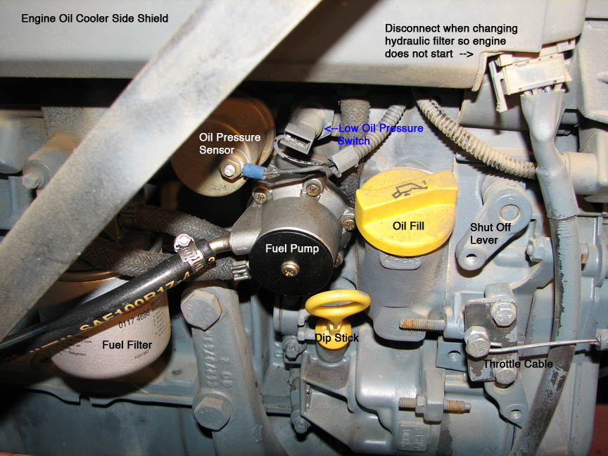

I have no troubles opening jars etc. and always just put filters on by hand in all other applications. I am using a Rigid strap wrench to tighten the filter and then checking for air bubbles, repeating until the bubbles stop. Everything is cleaned and oiled - I have never tried it dry but that sounds like a bad idea to me. Recently, I bought some high quality band filter wrenches and will see how they do. The Rigid dents the can even though I only use it at the top or bottom of the filter. Replacing the filter is one of a few things I hate about the PT. My tractor is a higher pressure tractor than a 425. Not sure if that makes a difference on the suction side or not but I can believe it does. What bothers me more is that Woodland has no issues. It is possible the filter assembly should be replaced but the main problem in my opinion is that a "low" (relatively speaking) pressure filter design is being used in a suction situation. I find it hard to believe the the "L" shaped gasket would not easily seal in the normal application of this filter.

Terry told me to definitely use a wrench on both my machines (425 and 1845) and tighten it as tight as I could get it, when I inquired why PT hydraulic pumps fail so early. I think this is a very common problem that most PT owners don't know about. When I first got a PT, more than 20 years ago (thanks MossRoad), I once looked in the tank with the motor and mower running and could see a lot of foam. I felt this wasn't right but didn't think much more about it. My mistake.
After changing the filter, always peak in the tank with the machine running. Better yet, do a very cold start and peak in the tank. No air bubbles equals good, presence of air bubble equals bad.

As shown by PT, when changing the filter, you hook a hose up to a particular port on the pump and stick the end into a jar of oil (or some do it in the tank) and check for bubbles while turning over the motor with the connector disconnected on the motor (diesel models).
The filter gaskets come in 2 flavors, one is flat and one is L shaped in cross section. I purchased some of the L gaskets by themselves to try them but I have not really noticed any difference between them.

Here is how you know; Sometimes, you can hear a high pitched whine. You can also get a film of oil on the outside of the filter, which gets to be noticeable with dust. Mostly, it is easiest and most noticeable due to foam or bubbles in the hydraulic tank. I check when the filter is first changed, and again once the oil is hot.
The reason to avoid the air is all the cavitation and erosion that the air causes in pumps and motors.
