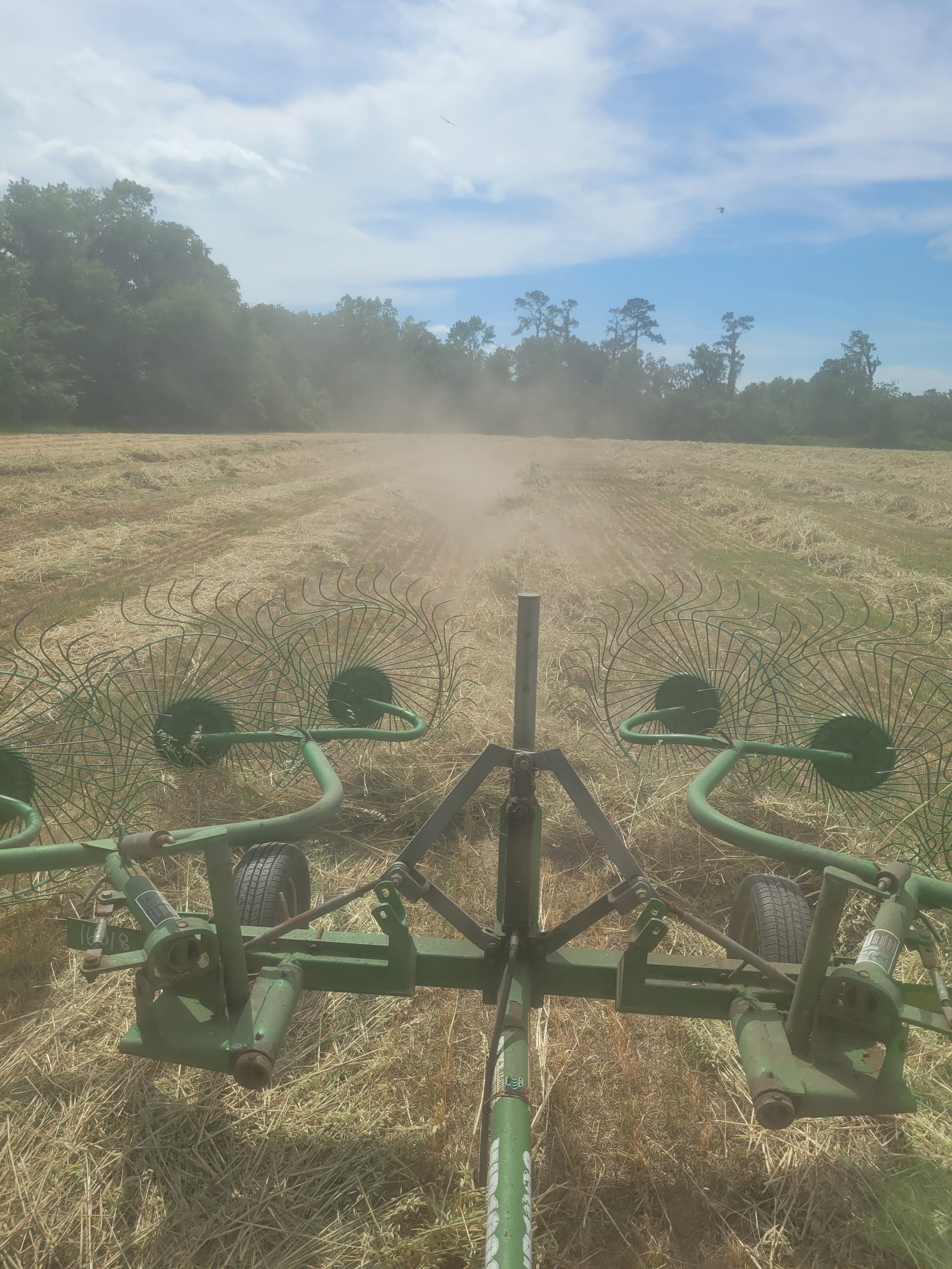

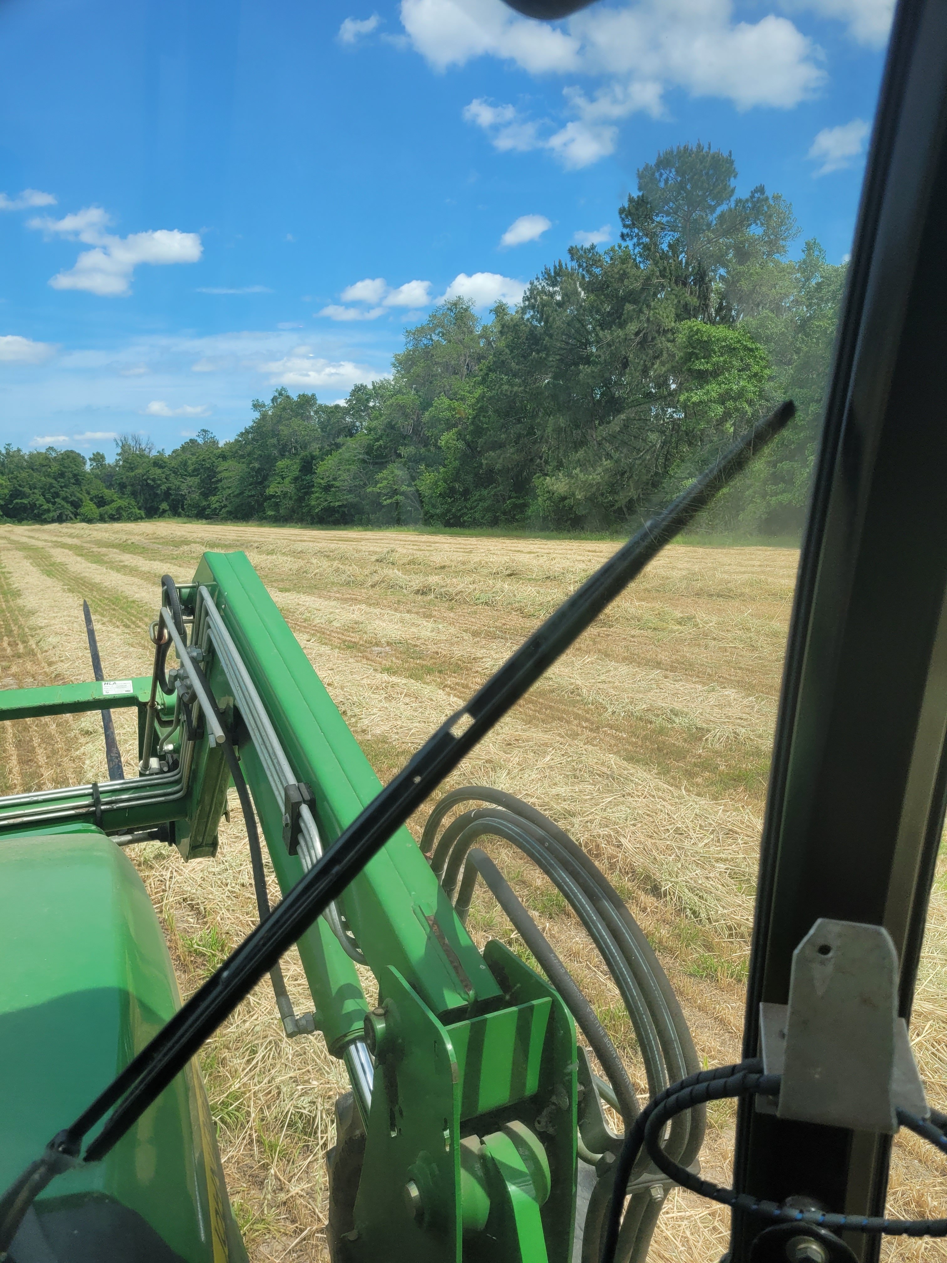

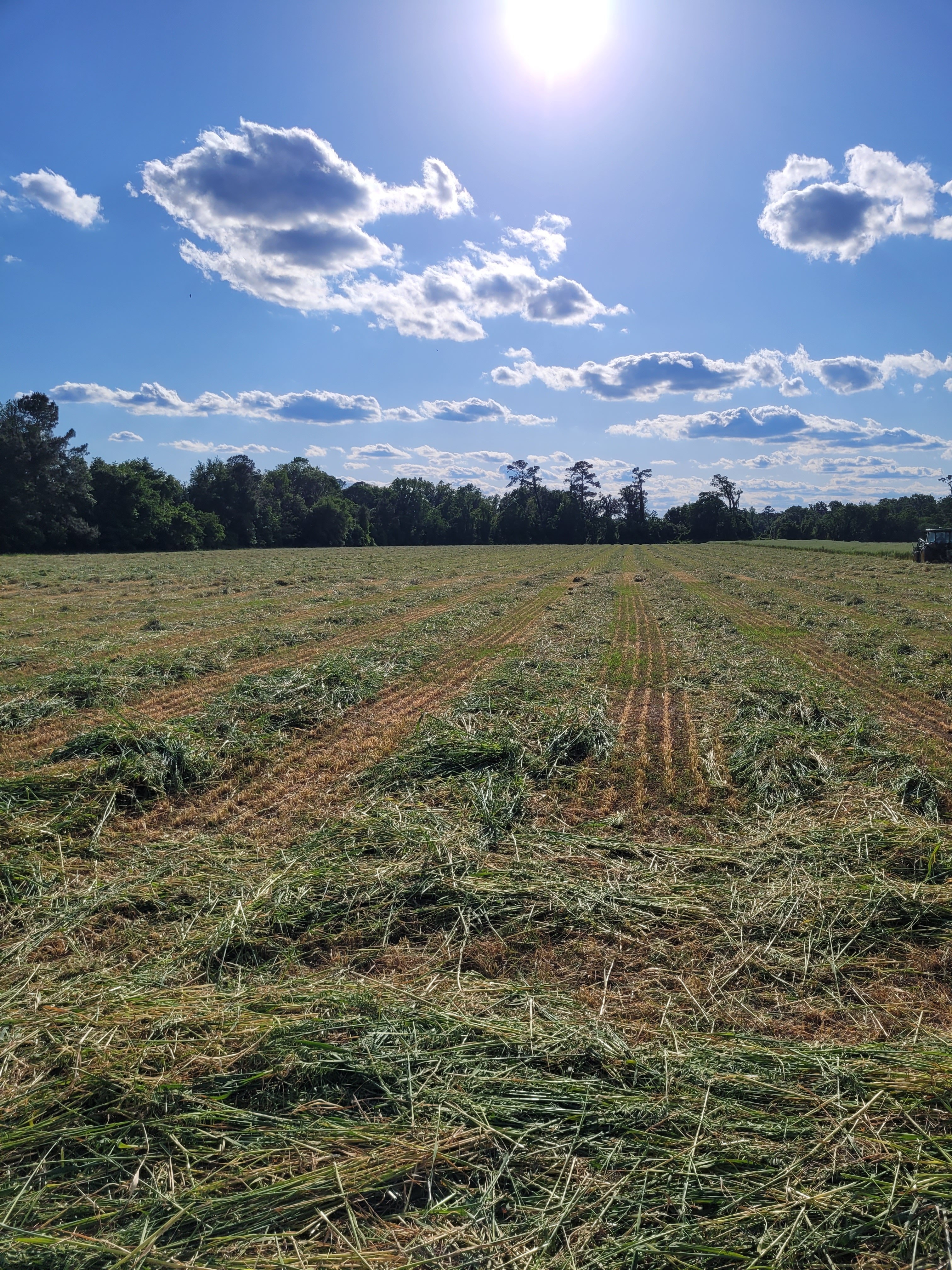

I posted this in my skidsteer thread but figured it might be more appropriate here, supposed to have good weather for the next week, gonna need it to get these dry without running a tedder through it.

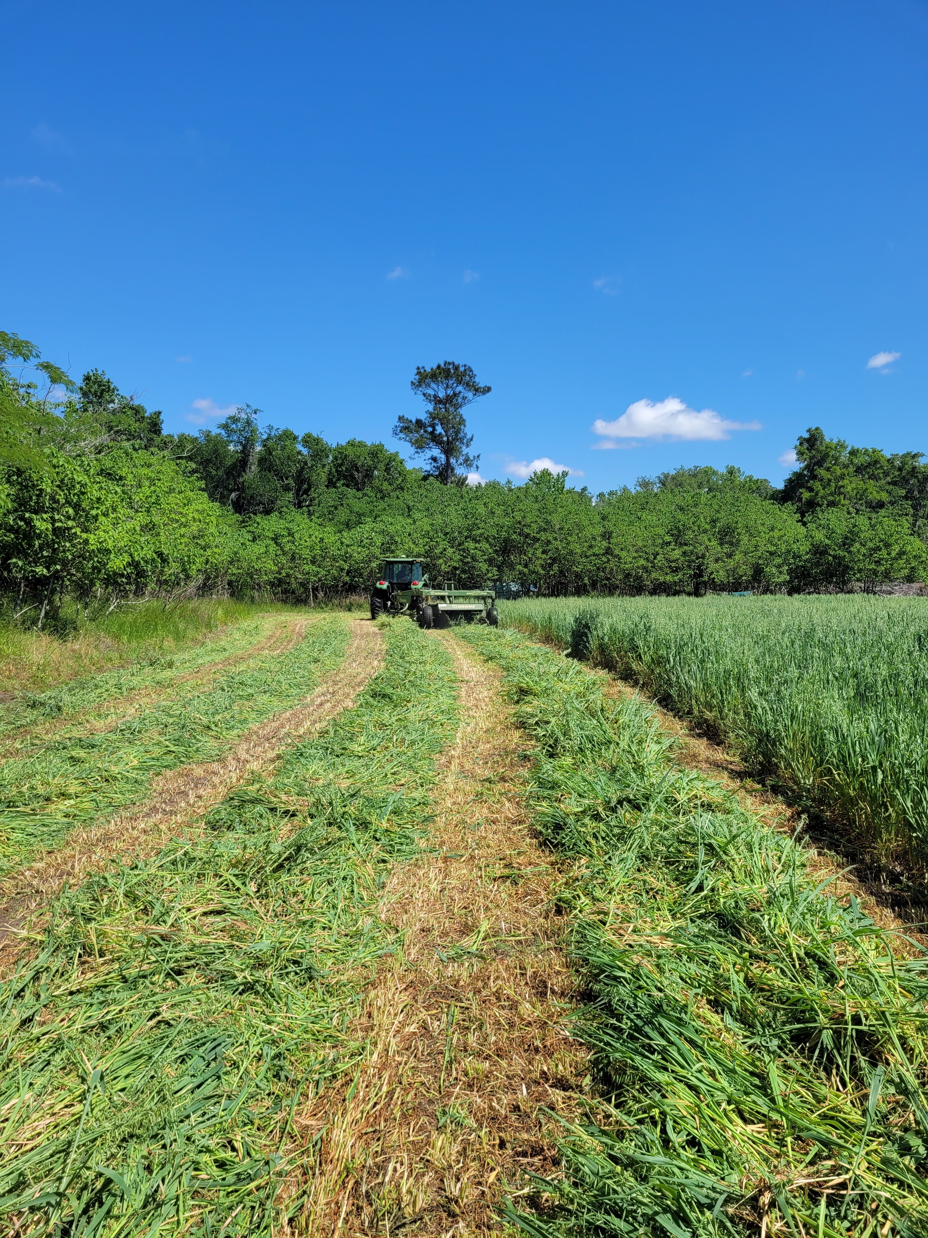

I try to cut them in the milk stage if the weather allows, I believe it's different in other parts of the country, some want to cut them in the boot stage, but seeing those seed heads in the roll is what sells down here.

No tedder or? Why would you not run a tedder right after mowing so they covered the entire field? What little loss there would be would be made up in better, faster, more even drying.
/ First cutting for the year Oats
Just a matter of preference I suppose, if I didn't have this 7 plus day window of good weather I would definitely run the tedder over it, but in the past I have had good luck flipping it with a rake and it drying well, I will have to watch it over the next few days to see if it pays off to keep from losing as many of those seed heads.
/ First cutting for the year Oats #8
I ted crop that heavy regardless of weather, but getting 7 days of sun and warm in a row would be like winning the lottery here.

We have the ability to get 4 hay cuttings if the weather cooperates, BUT it rarely does so it's normally 3 and I try to wait and no till drill in the oats after the first frost so they are not competing with the existing grass as much, I believe I drilled these oats in the first week of December last year. I am like you I like to see what other people do in different parts of the country, I'm always interested in learning.

Got it all rolled this afternoon, wound up with 138 rolls off of this 25 acre field, it took all 7 days to get it dry, I think if I do this again this coming up winter I might try what LHF 2019 suggested and tedd it gently right after cutting to help speed the process of drying, I don't think it would damage the seed heads much if I did it that way.Hope everyone has a fabulous Easter tomorrow and remembers that without Jesus's sacrifice all would be lost.
