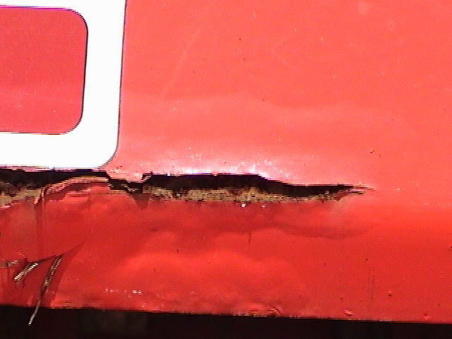

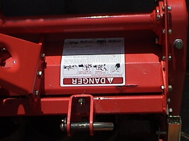

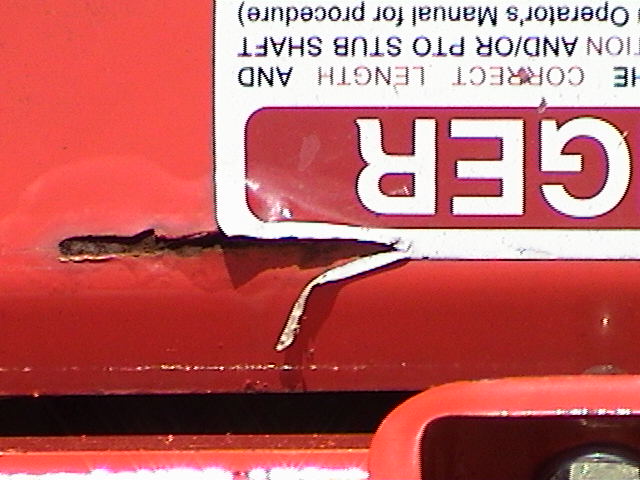

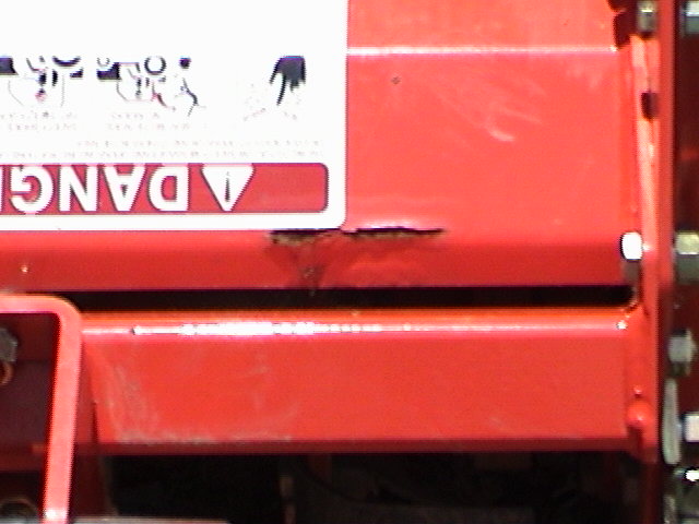

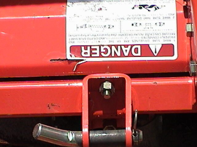

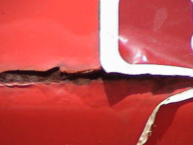

If you check CCI's pic the hitch block is inverted for shipping. This puts it in contact with the top of the tiller in the exact place where the rust begins. Once the paint film is broken, corrosion then creeps under the labels and paint and blistering begins.
/ First Choice Tiller and rust #42
theboman,
It is exactly what I mentioned earlier and Jim was nice enough to point out in the pictures. When the units are shipped the sway arm mounts are inverted and bolted in those spots and they hit the top and cut the paint.
Probably best to touch it up before it gets too bad.
Michael
/ First Choice Tiller and rust #43
Now I understand! At first I had a hard time visualizing what you and CCI were saying. Isn't that something First Choice needs to resolve on future shippments? Sounds like it is a common problem.
Meanwhile, I will remove the loose paint, apply some rust killer primer and repaint. I don't think I will need to cut out the rusted sections.
