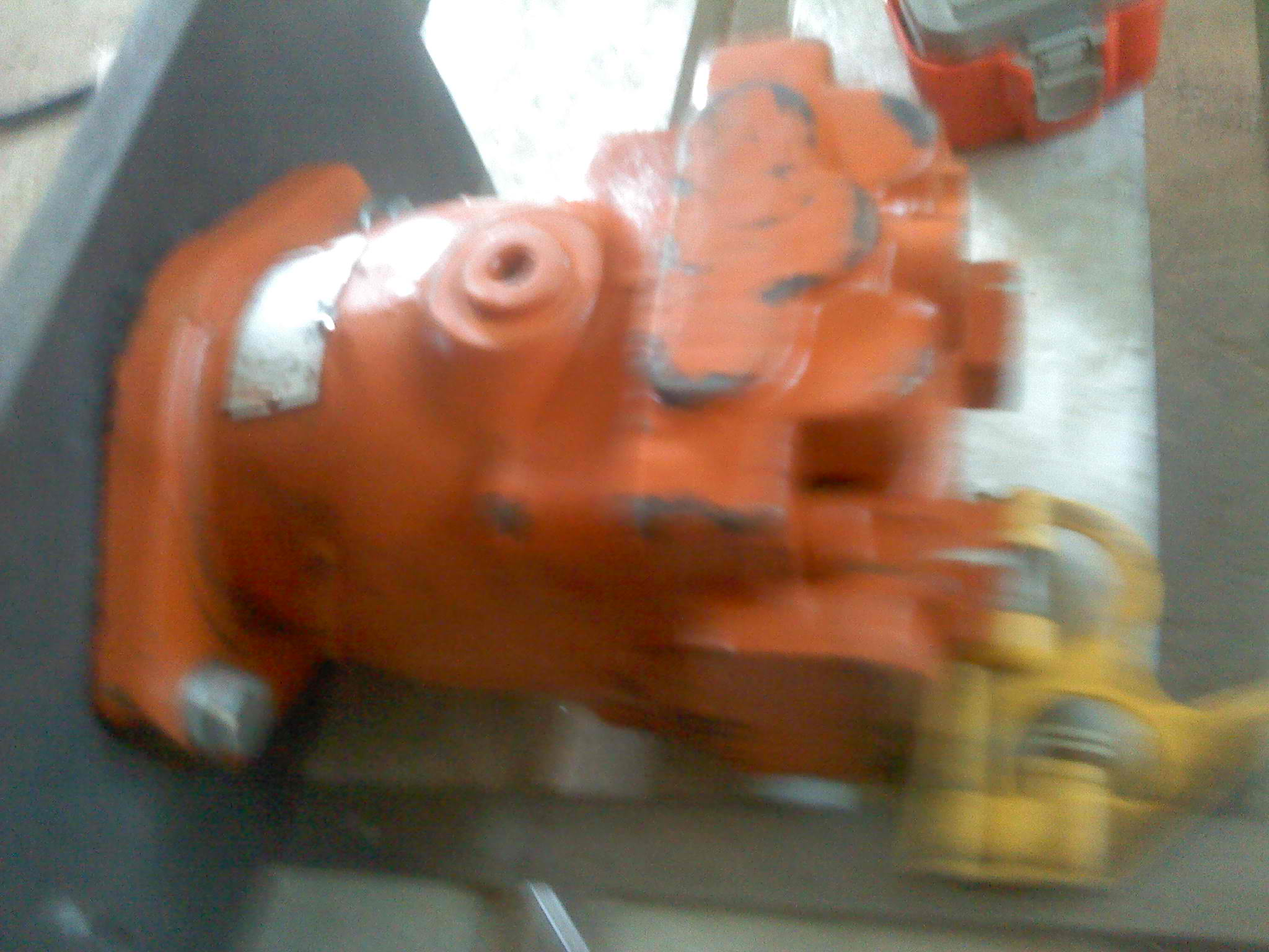

a axial piston motor can run 4400rpms, using a 13tooth sprocket on a .404 pitch chain will get your cut speed durn near the same as a 3120 husquvarnia chainsaw. Size your displacement of your hydraulic motor to match your available oil flow to obtain the 4400rpms and you will out cut the 3120 chainsaw because you will have more hp and torque. You dont need a hydraulic motor that turns 8000rpms to cut wood. Chain saws turn high rpms because they have little dia chain sprockets and need the rpms to get there chain speed up. A 13pin sprocket will create the same chain speed at 4400rpms as a chainsaw turning 8000rpms with a 7pin sprocket.
I have a proclain 1.3cuin motor for my saw motor. 13pin sprocket and .404 chain. I plan on 25gpm of oil and will start my pressure out at 700psi (not a misprint),and this will provide 1.5 times more hp than the 3120 husky gas chainsaw and about 3 times more torque.
My setup calls for a 15/30/60 gpm stacked pump. My current splitter has a 28gpm 2stage pump and because of the low pressure needed I am planing on a test of my saw motor using that 2 stage pump. Kind of just want to prove to myself that a 2 stage pump will work with a saw motor. Plus all its going to take to test it out is to hook my splitter to the saw motor and let er rip and see what happens.
