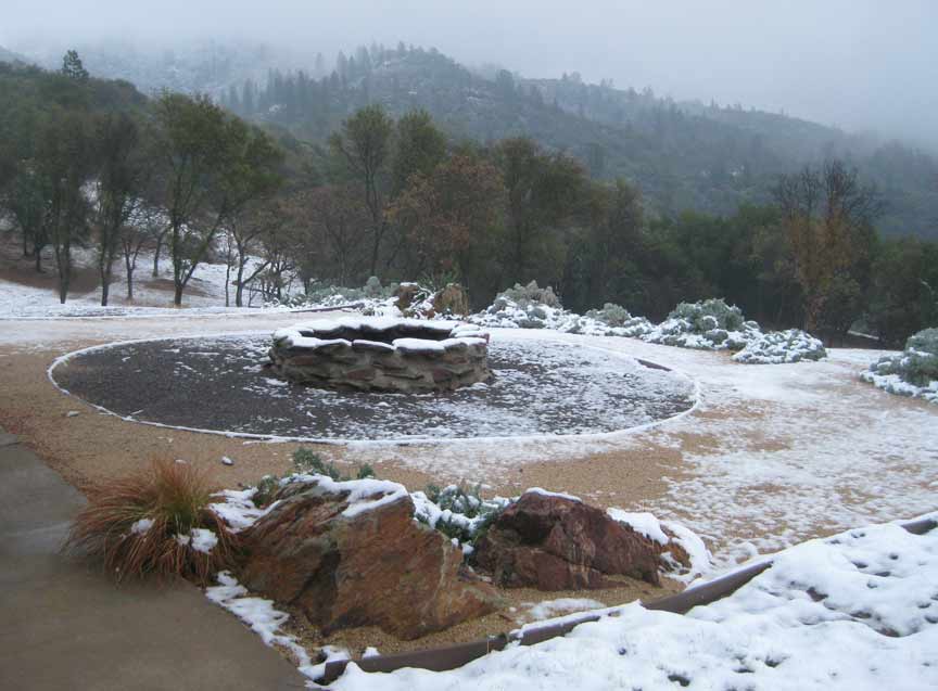

Is that rock and sand around the pit?
The walls are built from stones I found on site. The locals call it shale, but it looks more like limestone to me. There is an old lime kiln below the property situated on a big vein of limestone. My understanding is that it was used to make cement early in the last century.
Surrounding the pit is a 10' ring of 3/4"- road base, crushed gravel with a lot of fines. It packs down pretty hard and'll stay put pretty well. Then I spread out a gold colored decomposed granite as a general ground cover/mulch. It'll get soft when wet, but dries very hard. All the landscape plants here are on drip irrigation, and since we're in a wildfire zone, it's important that whatever mulch is used isn't flammable.
