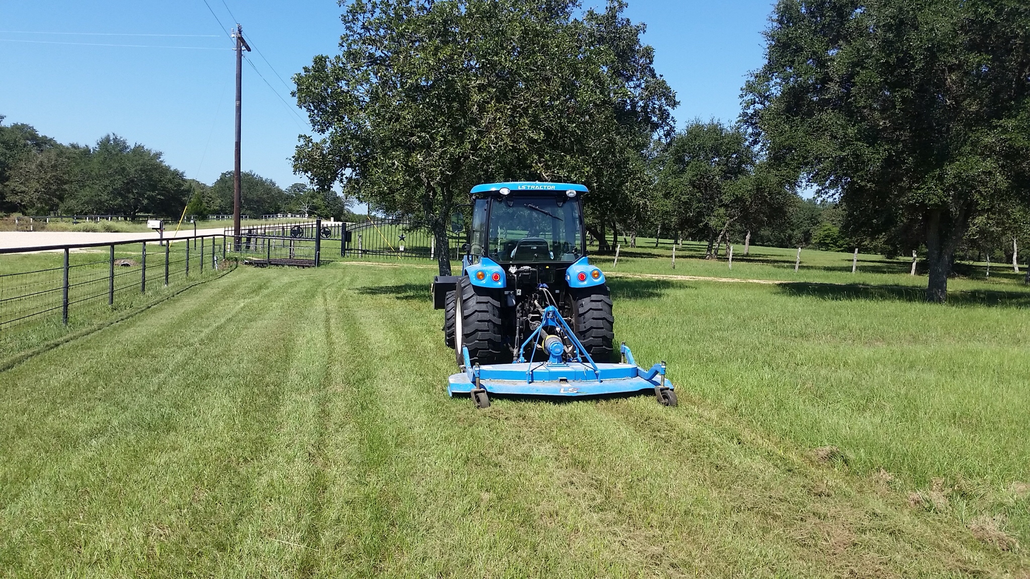

I bought an LS 84” RFM about 3 years ago and have had good service from it.

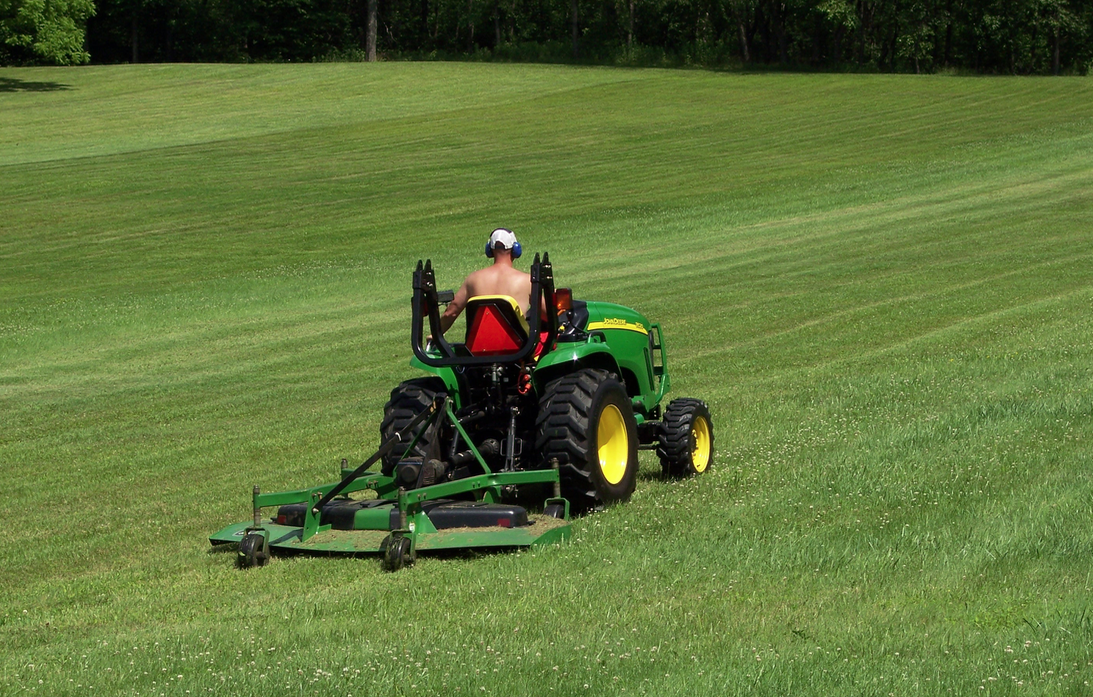

IMO, Woods is top of the line as far as long lasting quality and design. Of course that comes at a price.
I'd check out what parts manuals are available on line for popular brands such as Befco, Rhino, LandPride etc. and decide.
Look at the Woods then compare it to the others, would be my suggestion.
My 7' LandPride gives a much cleaner cut and follows contours much better than my 6' belly mower ever did.
