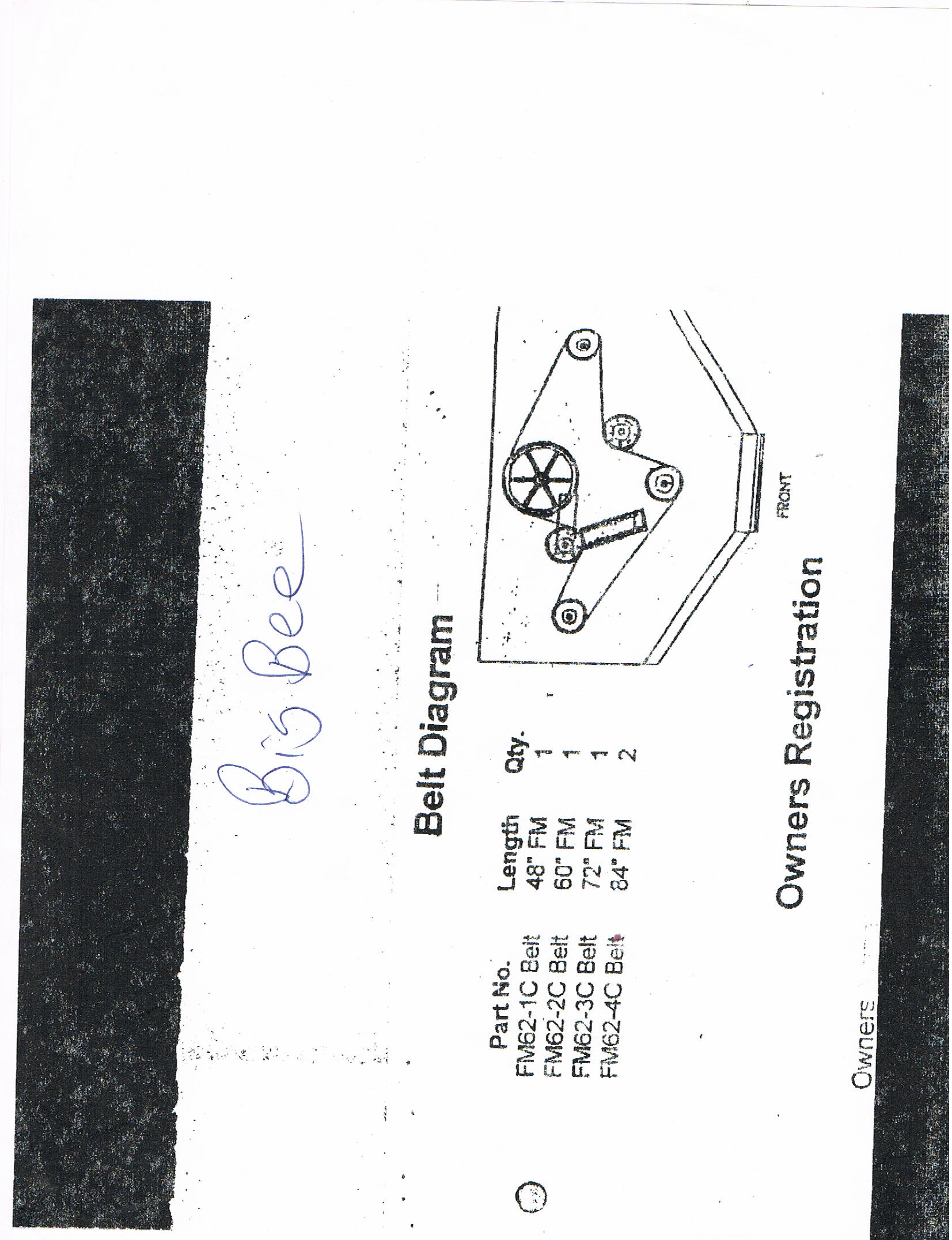

I had a 60 inch Bigbee rfm and used it 15 years and when I sold it a few months ago it still had the same belt that came on it. I would suspect that your idler pully is not running straight. If so , it will cause the belt to ride over one of the pullies. I had a pickup that the idler pully was running with a tilt to it and it would cause the belt to get on a pully and cut it and then it would break. AS you said the idler has a tilt, I would replace the idler. Thats what I did on the pickup and solved the problem.
/ Finish mower keeps breaking belts
#22
Tightening the swivel bolt on the idler arm took the tilt out of the pulley and this seems to have solved the problem. I have mowed several times this year already, and in some thick grass and the belt shows no signs of wear yet.

I'm still mowing with that last Gates belt I bought.
I haven't had to put the blue kevlar belt on yet.
So I guess it was the bolt in the idler arm.
