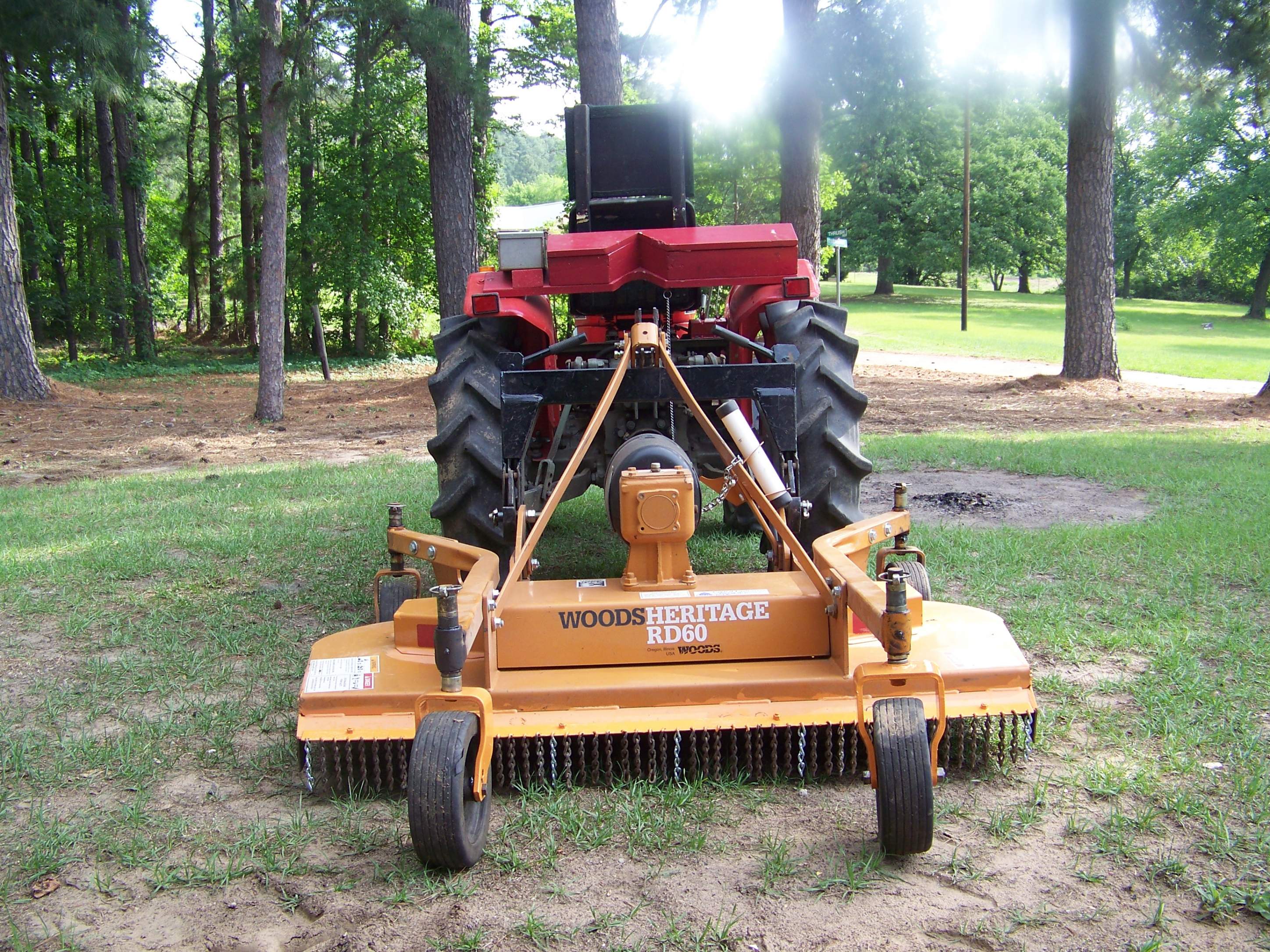

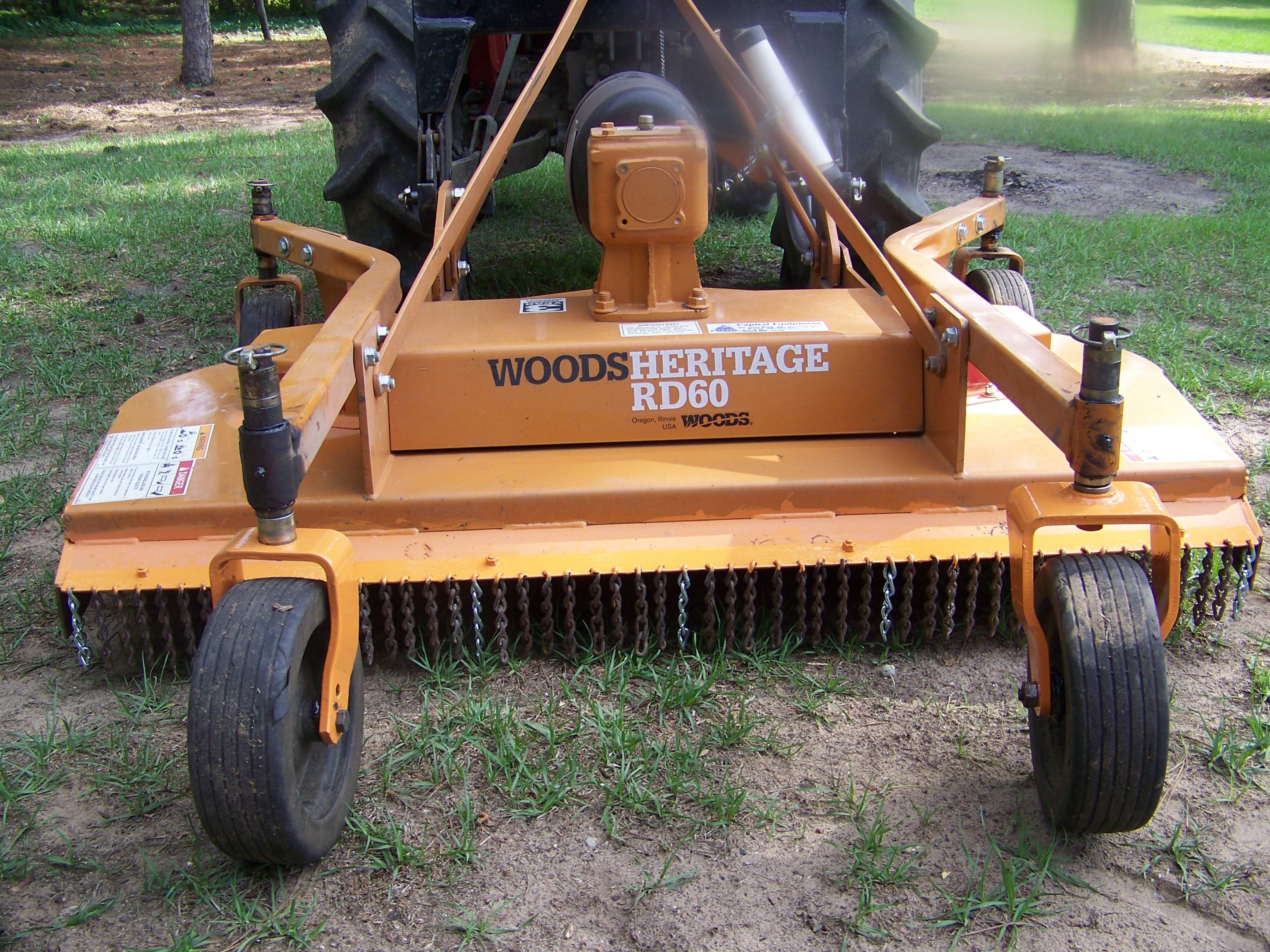

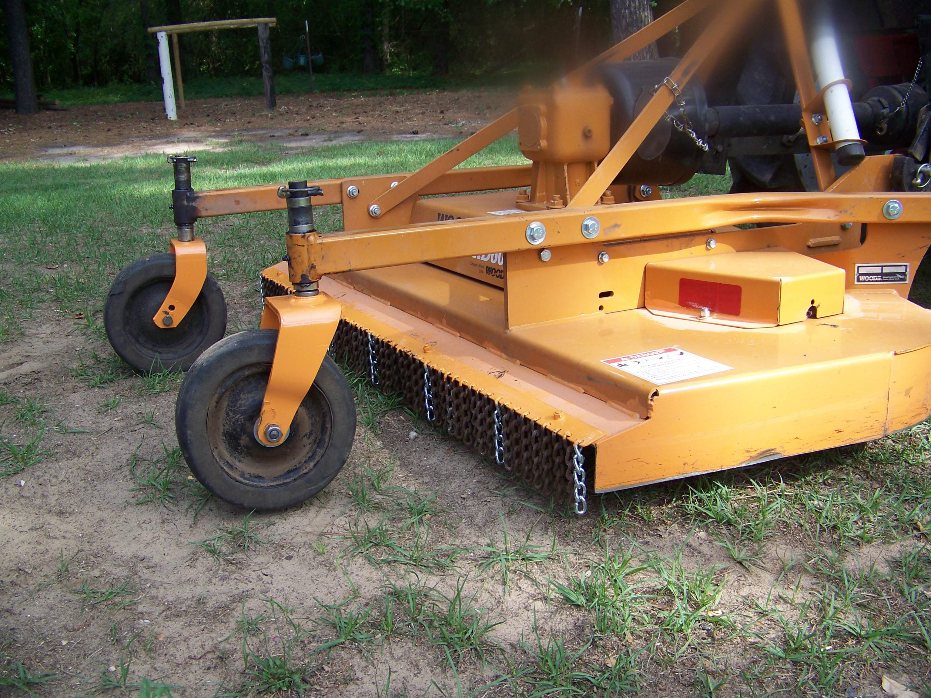

Well 284, I decided to go ahead with my safety chains. I used 2/0 twisted chain only because I had 15' on hand. Had to buy a small piece to complete as you can see from the shiny ones. I used 1/8" x 1-1/2" flat bar. I drilled 1/4" holes on 1" centers which gave me 55 links. The factory one has 42 links but they use a different chain. I cut my links with an angle grinder and Harbor Freights little cutting disc's. After squeezing them together on the flat bar I put a little weld back on each link. Hasn't been out for a test run yet because the paint is wet.

It looks terrific! The color even looks like it matches pretty well! I'm eager to hear how it works at suppressing the thrown debris. I'm hoping to start mine this weekend.

I mowed a yard this afternoon without any broken windows. :D I didn't seed it with all that stuff though. :laughing: Looks like it is going to work OK. If I see any evidence to the contrary as time goes by I will let you guys know.
/ Finish mower chains #6
How do you feel about the spacing of the chains? Does it block enough debris shooting out? Does it restrict the discharge too much? Would you change anything? I was kind of planning on the 2/0 linked chain already, and it looks good. It seems...denser, I guess, and like it should work better than a more spaced out series of links.

I wish I had put them just a little closer together. Looking as this picture of a Sitrex it would still seem possible debris could get through there. Everything Attachments | Skid Steer Attachments, Tractor Attachments, 3 Point Hitch Attachments, and Farm Tractor Implements. The factory jobber from Woods has 42 links spacing them at about 1-3/8" but they use the chain as shown on the sitrex. No problem with discharge stoppage. Haven't mowed any knee high grass though.:D I used the twisted chain only because I already had it. If I had bought it new I would have used the 1/4" link chain as shown. I now find this picture of one like mine and I can count at least 50 links. WOODS RD60 GROOMING MOWER w/CHAIN SHIELDING | eBay My woods manual doesn't show that. Oh well.:cool:

You have plenty of shielding to prevent (or at least, slow down) anything from flying out from underneath that mower.
