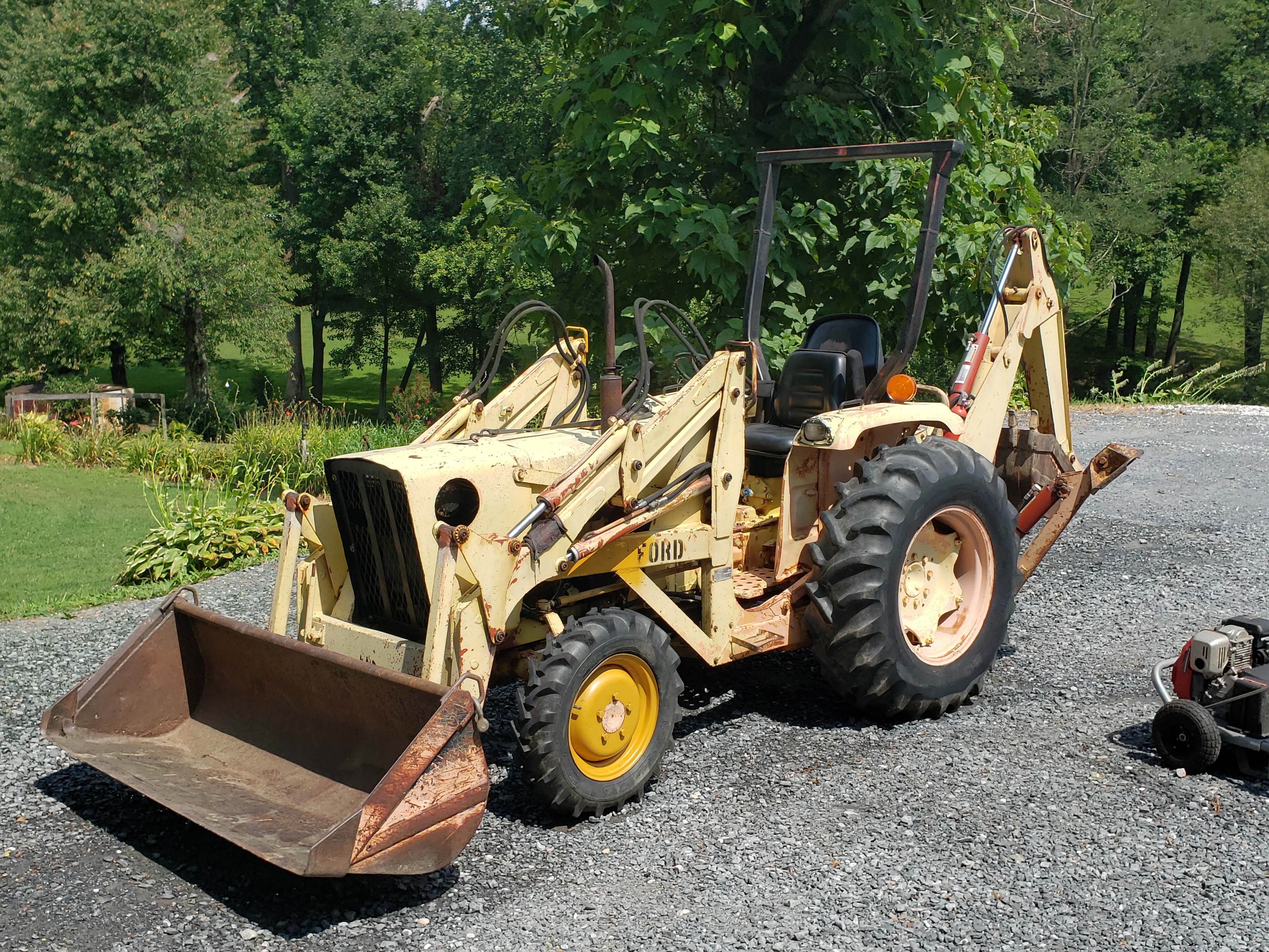

Full tractor

Thats pretty cool, I never knew Bradco offered a TLB, thought they only ever did attachments. I guess they didn't sell a lot, never seen or heard of one until now.

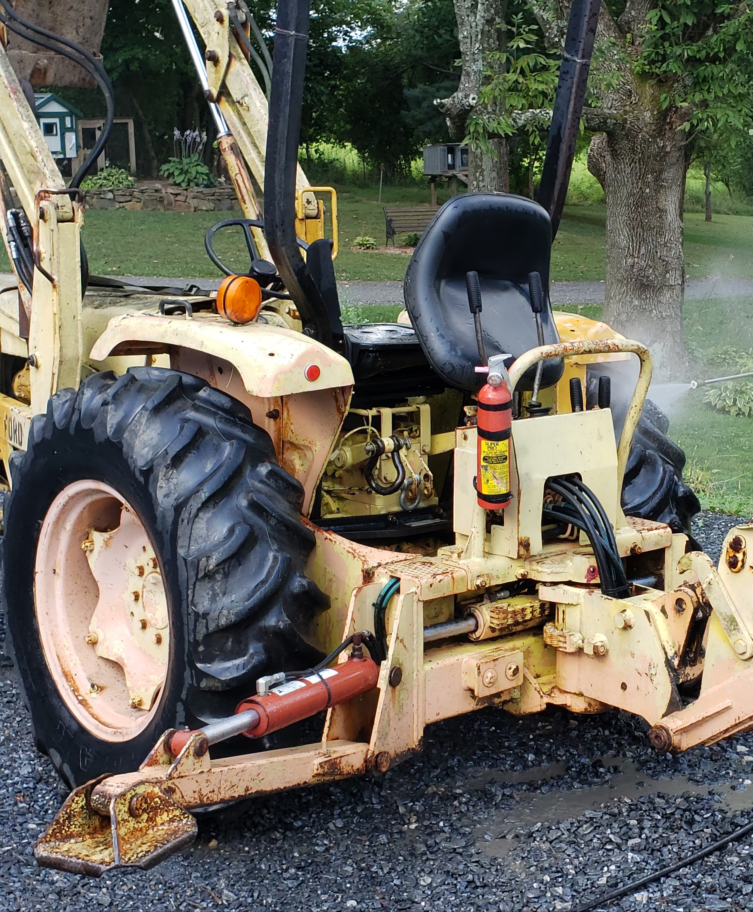

I think you'll need a Prince (PMC-8320), my Bradco tlb had a replacement when I purchased it, as best I can tell this is what it is. But check all the dimensions etc.
Good luck!

Closer picture

For reference mine is a TLB 31, 1986 1910 manual shift no shuttle. I believe the difference between a 31 and 32 is the backhoe digging depth mine is 9' and yours is 11', I believe the outriggers are the same. I'm no expert so if someone has some definitive information please chime in.
