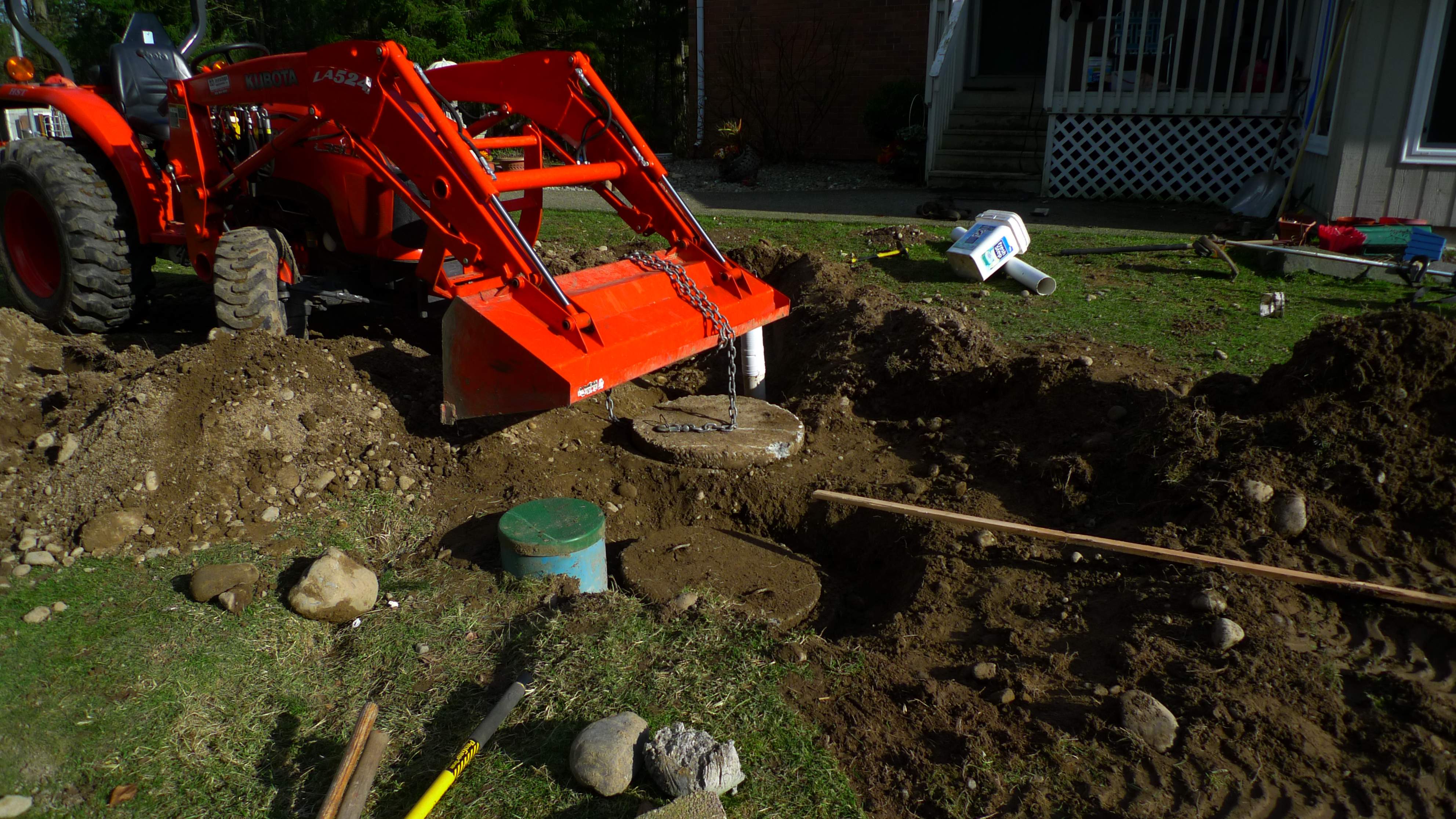

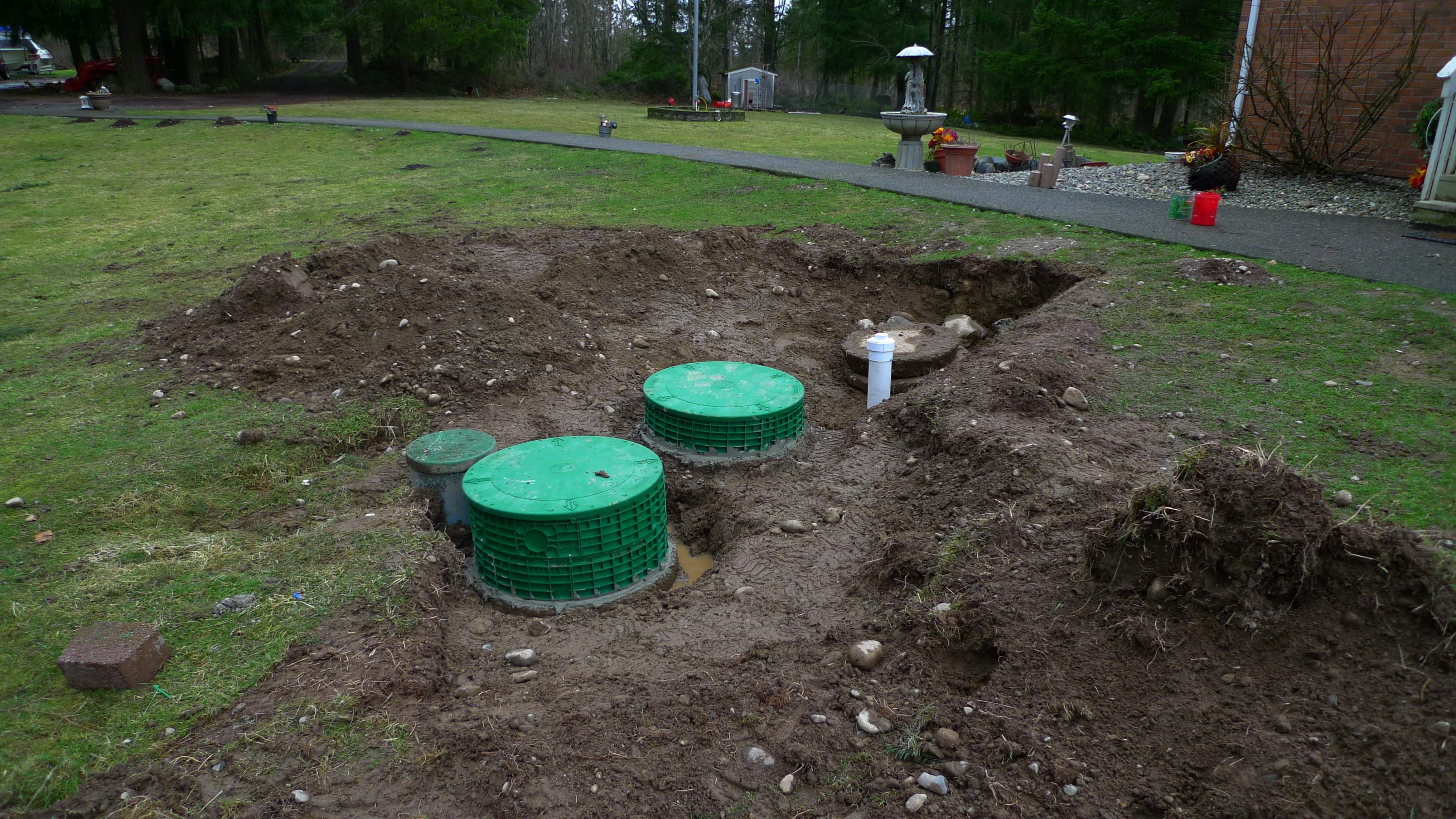

/ Finding my septic tank
#37
This exactly what I did. Saves paying the septic company to dig down to the tank lid every time. Here is the finished appearance.
