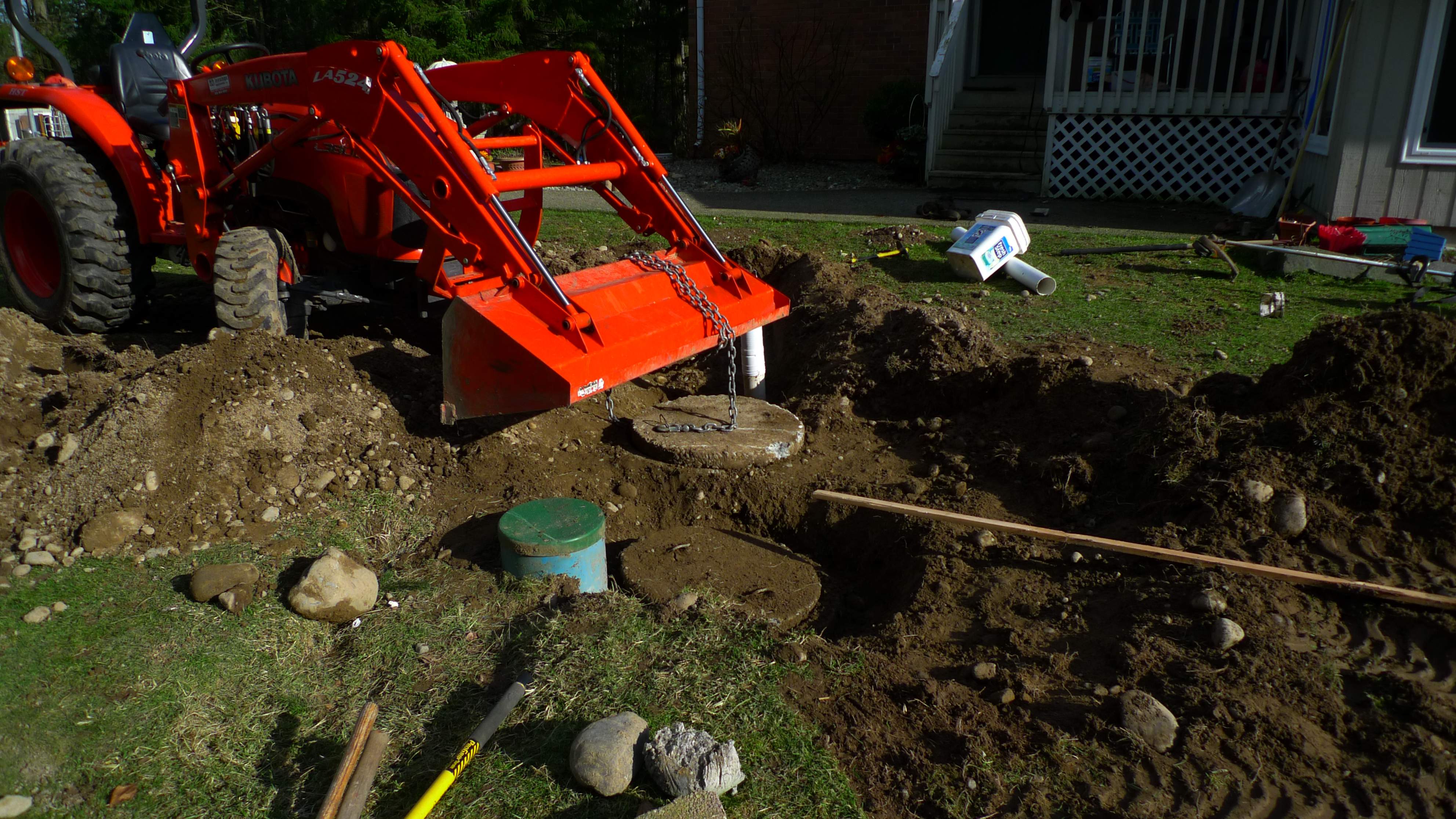

I recently purchased a property with a buried septic tank. I was able to determine the rough location of the tank, but it wasn't clear how deep it was located. I tried hand digging down to the tank, but quickly found that frustrating as I was running into a lot of rock and hard pan. Therefore, I very gingerly dug down with my back hoe (with some hand digging) until I determined the tank level. It was a big time saver to use the BX-25D back hoe to gently uncover the majority of the dirt and debris, leaving the final distance to hand digging.
Tonight I feel great because I had my tractor do most of the work :)

Most people dig down to the tank to allow the lids to be removed for fluid extraction.
/ Finding my septic tank #5
You can have a riser installed on the top of the tank which will bring the lid to just above finished grade. Makes it a lot easier to pump the tank in the future. Mine was made of a heavy ABS like plastic with a plastic lid on it.
