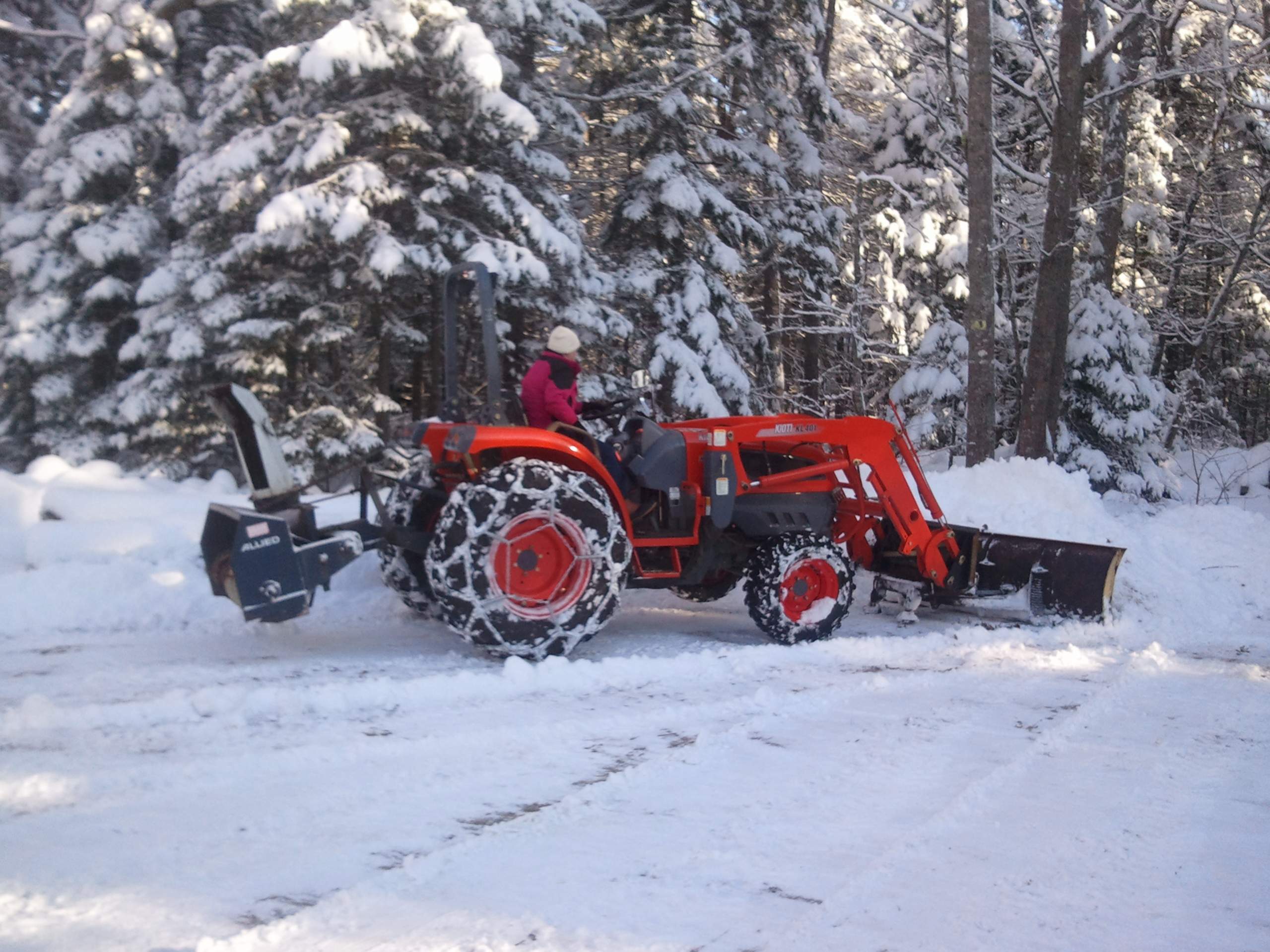

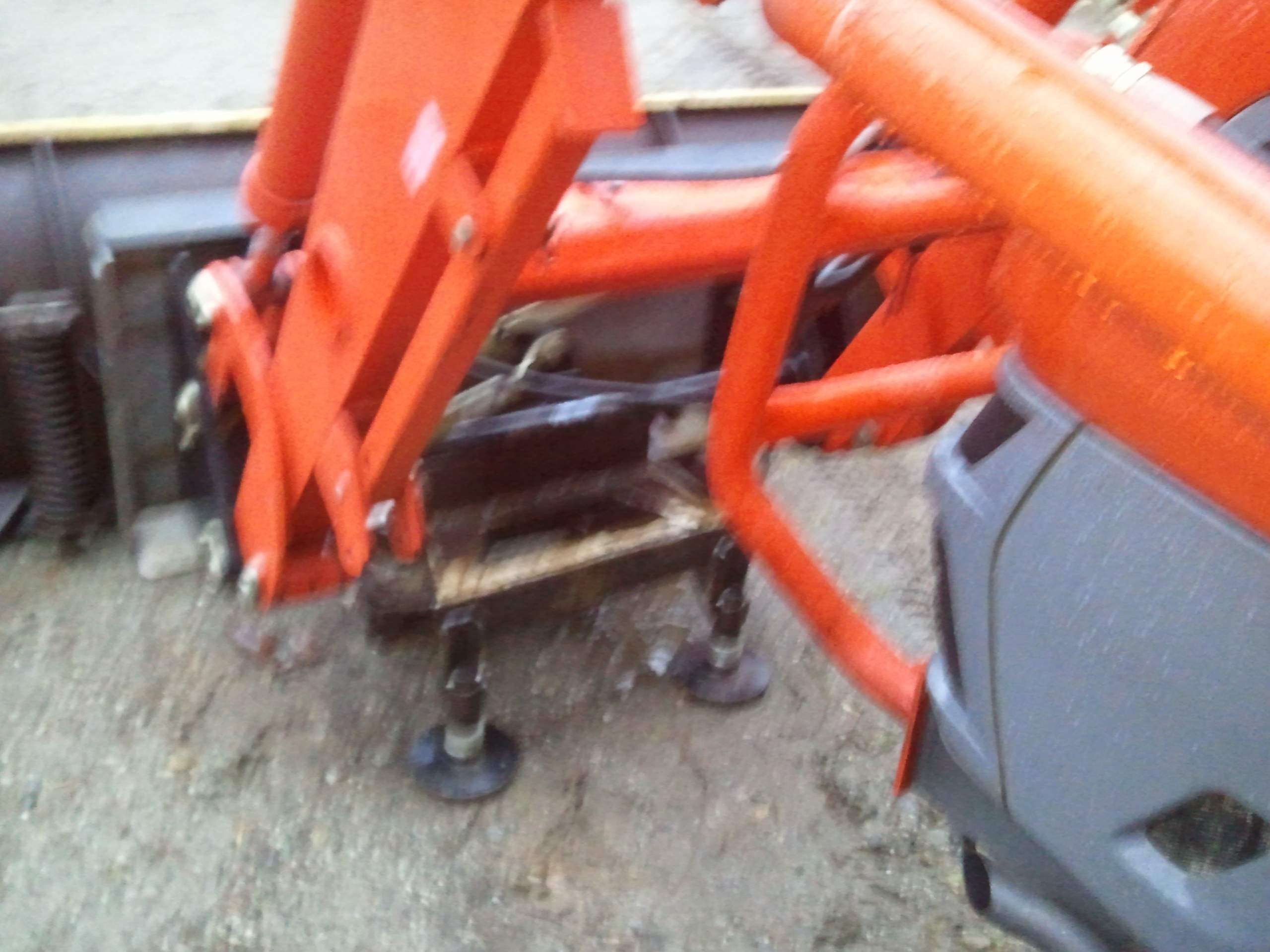

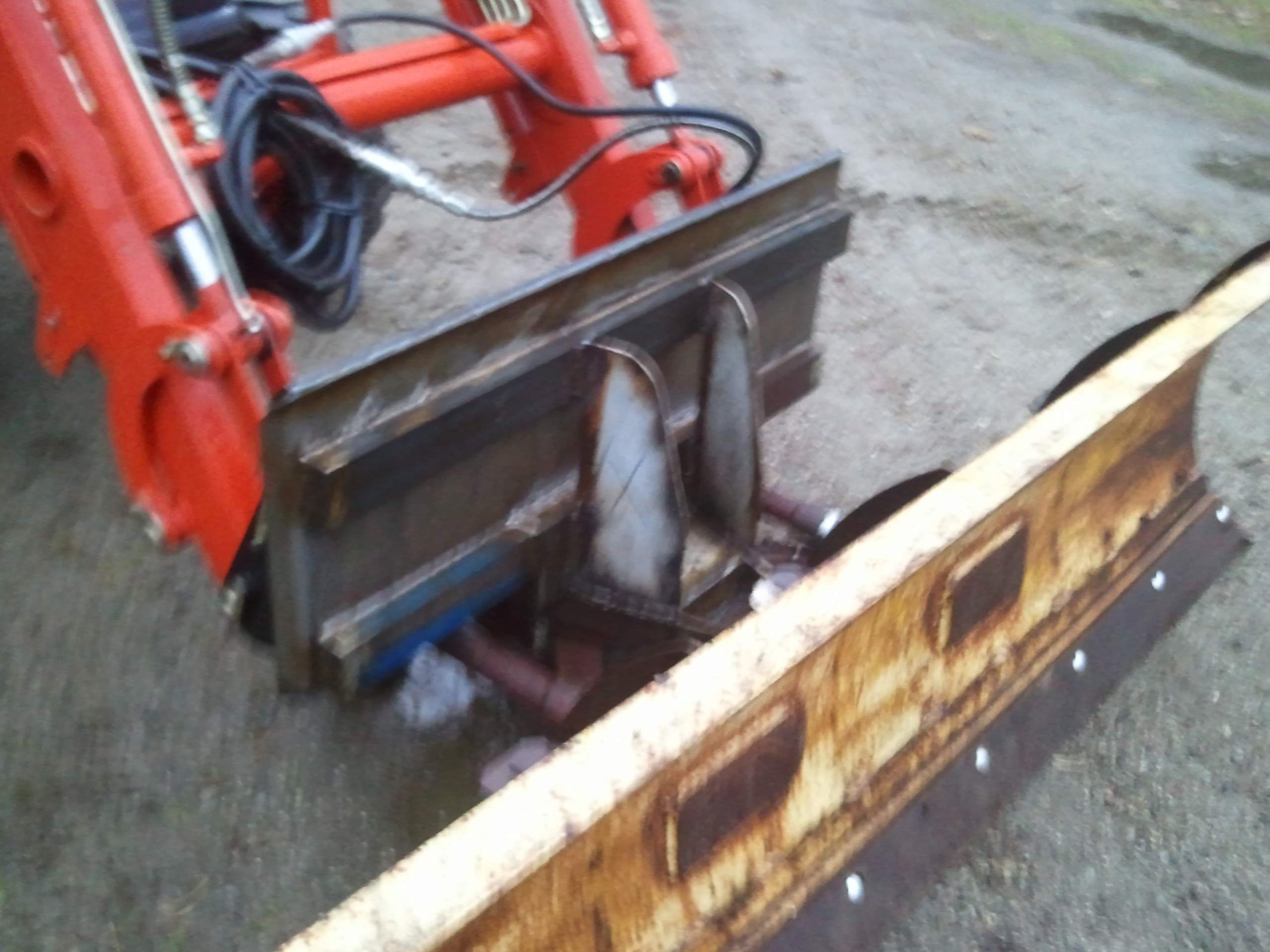

It took 2 small snow storms to finall get enough snow to plow. I took an old Fisher 71/2' snow and converted it to QA. My thanks to kubota tee and 4shorts as I followed their designs. Works good, still on the low end of the learning curve. I had to throw this together in a hurry so had a couple of bugs. I did not have time to drill the pivot bolt for a cotter pin. I double nutted it instead. I used lunch pins for rear shoes. They all failed. But not until I plowed an acre of shop yard, my 300 ft driveway and yard, and did 1/2 of my neighbors mile long driveway.
My wife even got to try it out as she will be using it when I ship out. So it is back in the shop now, I will address the issues tomorrow.

Blower on back with a good snow blade on front? Stylin' ! Thats a nice set up. Love to have a blade on front.
/ Finally used the plow #3
Looks like you have surprise for old man winter..nice setup.

I "borrowed" the rear snow blower of my Satoh 630D. The Satoh has a 4 sp PTO and I can wind the blower up. With 540 rpm I can only dump the snow beside it. I am just using it for rear wt.
I am pleased with the front blade. I did my snow removal in about 1/3 the time and my neck didn't hurt. Figured I would work bugs out and do any mods this season and paint it in the off season. I am already on mod 2.
I have never gotten a 4wd tractor stuck. I have had the Satoh up to it's belly in mud and the r1 ags kept it going. My DK45 with r4's could be another story. Hope the bucket can keep me out of trouble.

Well that's great and I'm happy to hear your pleased with the design. When I did mine back in 08 I put a lot of thought into it. My goal was to have that plow as close to the FEL as possible which I accomplished and have been using commercially ever since. It was a year or two later that Kubota tee emailed me with a few questions and he did his plow like mine. We became pretty good friends after that. He's a good guy :thumbsup:

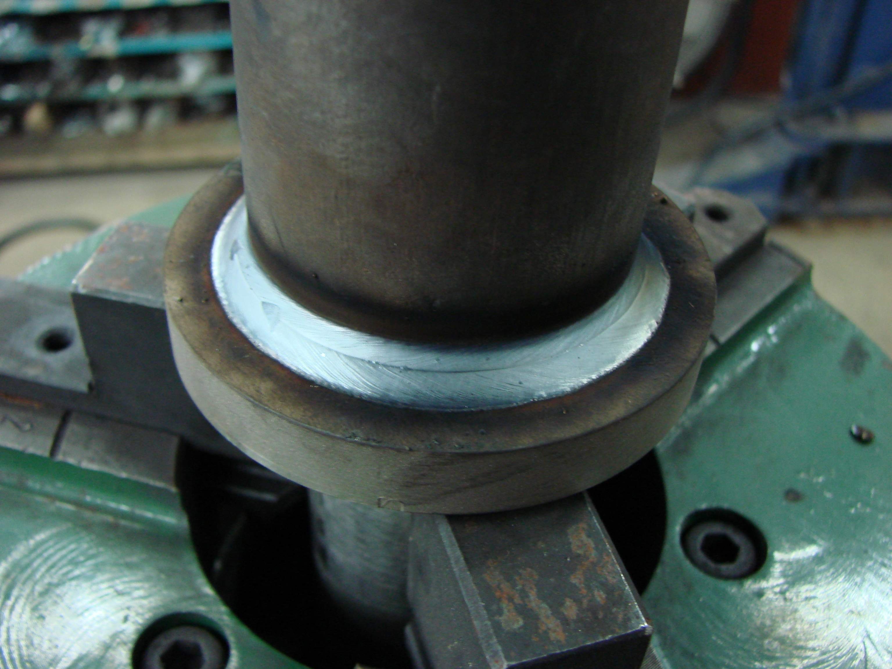

The attached photo is of a weld that I did. I used a pulse spray mig and a welding positioner but the rest was done by hand. My older brother who is a welder says its the prettiest weld he's ever seen but I just think he's trying to be nice (for a change) :laughing:

Alright, I'm in on the 2013 TBN member summer tour of Newfoundland! And yes Paul, that is by far the nicest weld I've ever seen.

Glad you liked the weld. I got word late last evening that I have a lot more stainless work on the large shrimp trawler so that's good news. Most of the time Iceland gets that type of work :cool:
