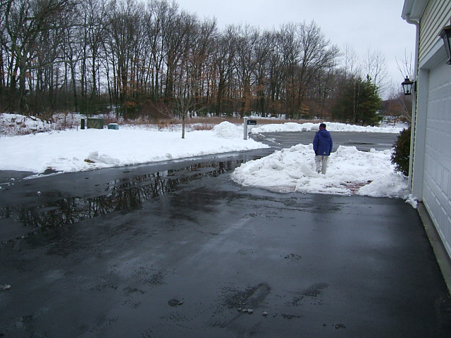

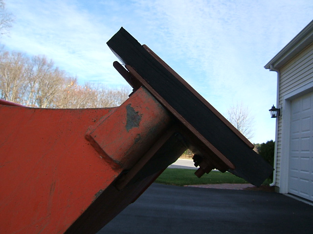

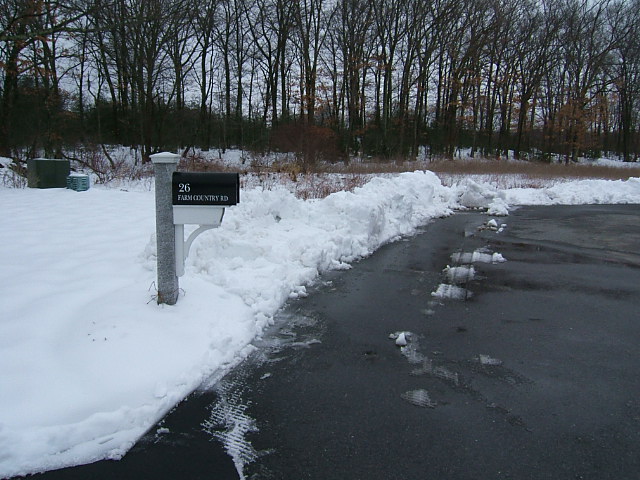

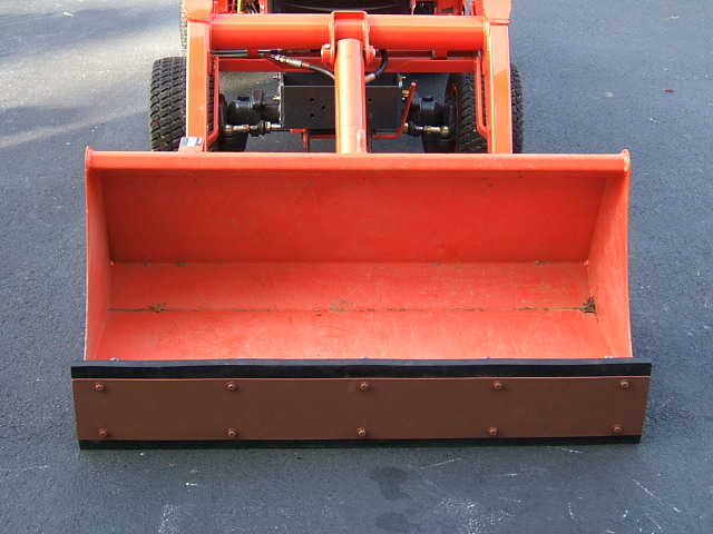

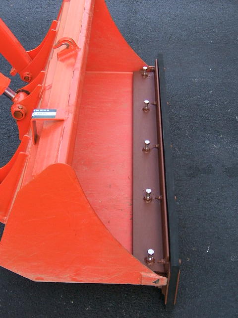

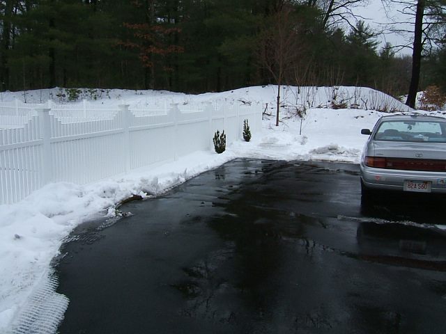

We had our first snow/sleet/rain storm that left enough slush to give it a try...and it worked as expected - it's one mighty squeegee...
No issue back-dragging and no issue dumping the FEL - very limited wear on the rubber. So I am very pleased with the outcome.
I realize I do not have a massive driveway like some, but I basically "plowed" with this setup as opposed to scoop and dump which was extremely fast and painless.

That would not have worked here with this storm. I used the bucket to break through and scrape up 1"+ of ice.
   / Finally the slush pusher took its maiden voyage #4
Just curious, would it clean as good if someone would have driven over the wet snow and slush and made tire tracks??? By the way, you may want to patent the idea, it looks like it could catch on :D . Good fabrication :) .

My wife made several passes over the driveway with her full size SUV, it was not completely frozen, but iced-up - no issue scrapping it up...
It would be nice to have an angle on it or angled wings (rev 2)
Easy on, easy off with the clamps - allows for bucket scrapping when necessary...

c-and-a, congratulations for a beautiful piece of engineering.
It's well thought out, very clean assembly, with an ingenious "easy on - easy off" design.
Were did you find the rubber?
