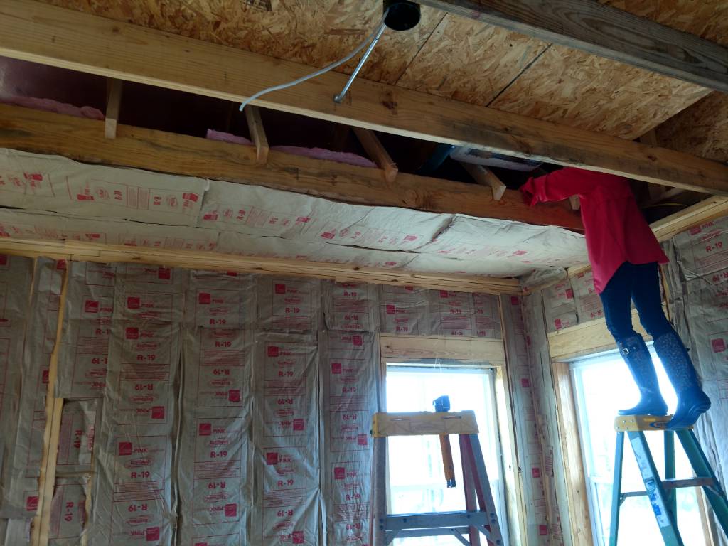

I never took you for a knee high boots kind of a guy. :)

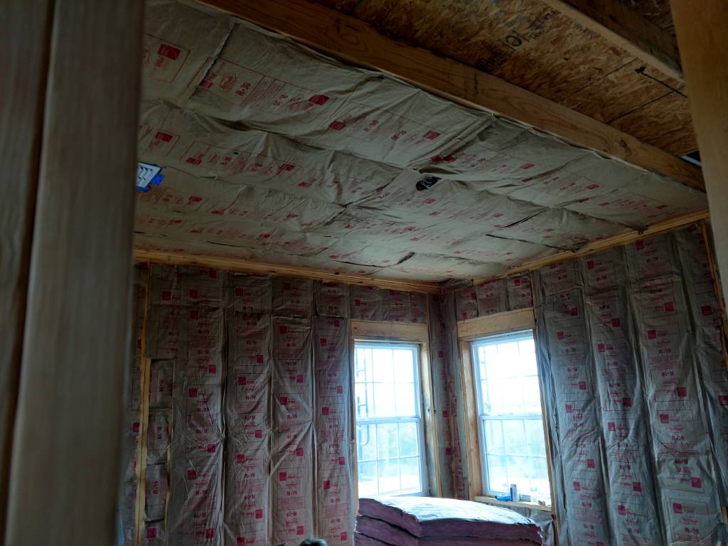

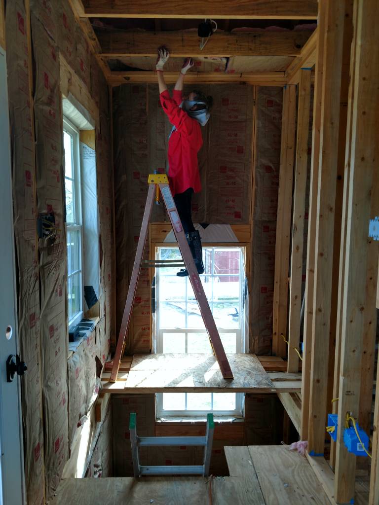

I'm sure you're joking and know this but, that's my wife. She's done all the insulation in the walls. I've been helping with the attic, it's a lot easier with 2 people. We also both have nerve damage in our neck that is aggravated by looking up and working overhead so cutting down on that by working together really helps.
It's really starting to feel like a house instead of just a building. It's amazing how the insulation changes the feel of a building, makes it seem more solid and inviting.
It's taken a LOT longer than I would've liked but, we've come a long way. I feel like we're in the home stretch now. Other than the float and tape of the drywall, we have a lot of experience with what's left so there's not any learning curve, it should start to move faster now.

Yes sir, I was joking. :)
Good to see that she's in there helping and the two of you are a team getting it done!!!!

Working on the attic insulation today. Fun, fun!View attachment 538525View attachment 538526View attachment 538528

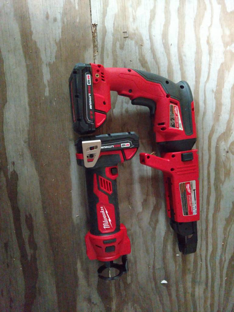

I took the opportunity to go ahead and get a drywall screw driver and a rotozip cutter. Can never have too many tools. :) IMG_20180205_154551745_BURST001.jpg
