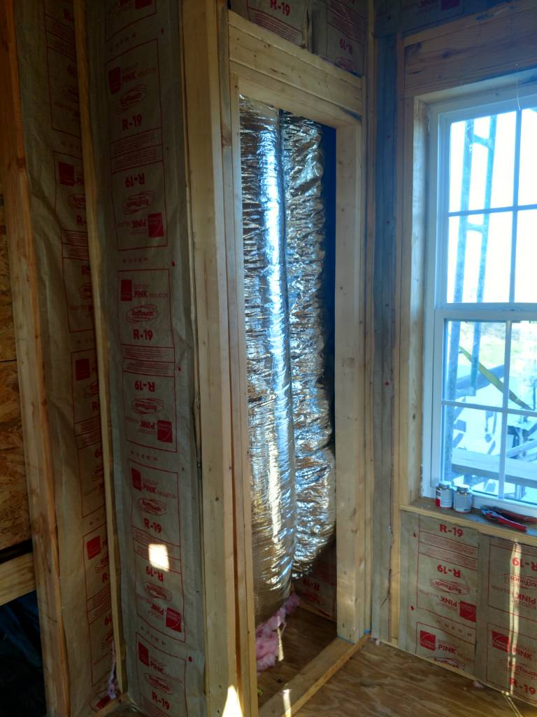

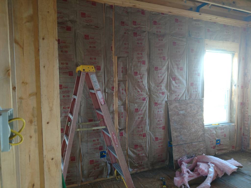

Busy weekend. Siding is on and flashed, I'll start the roof tomorrow. I'm 90% on the electrical rough in and 50% on the plumbing. My wife has been working on insulation in the areas where I have nothing left to run in the walls. I think.well be ready for drywall by the weekend.
It's such a big relief to have the siding done, everything that's left I can do all.e if needed so I don't have to bother anyone or by at the mercy of their schedule. IMG_20180128_170745239_HDR.jpgIMG_20180128_170821844_HDR.jpgIMG_20180128_170856627.jpgIMG_20180128_170900835_HDR.jpgIMG_20180128_170909927_HDR.jpgIMG_20180128_170920423_HDR.jpg

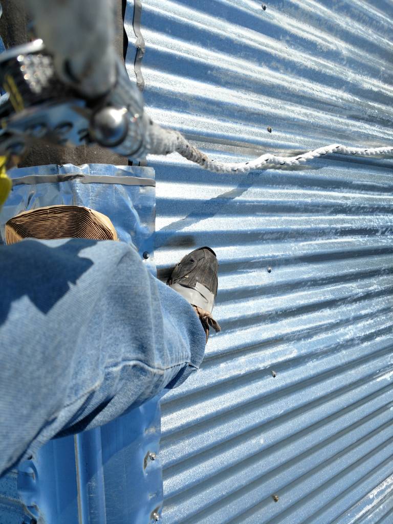

7:12, I wish now I'd gone shallower but, I needed the inside clearance for AC equipment.
I made these custom Gorilla Tape sticky shoes, they're OSHA approved. ;)

Does the tape help? I never though if that
   / Finally starting an addition on our shed
#146
Made all the difference in the world. It was just enough stick to keep my feet from sliding.
Roof is done now. On to the corner trim.

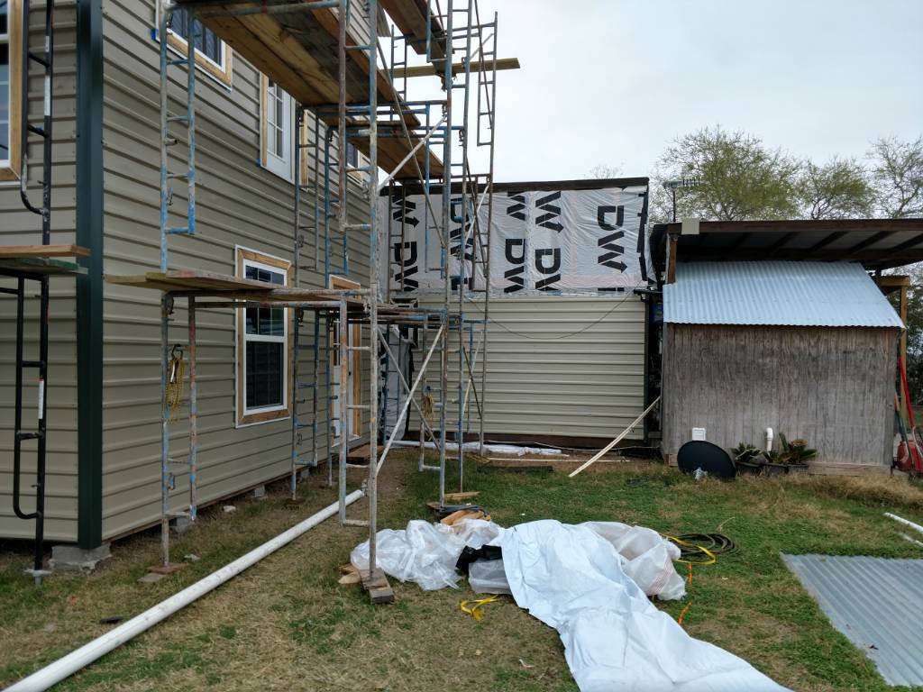

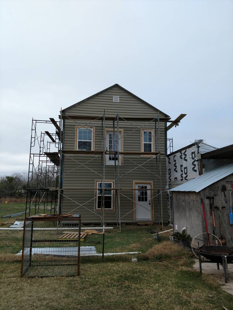

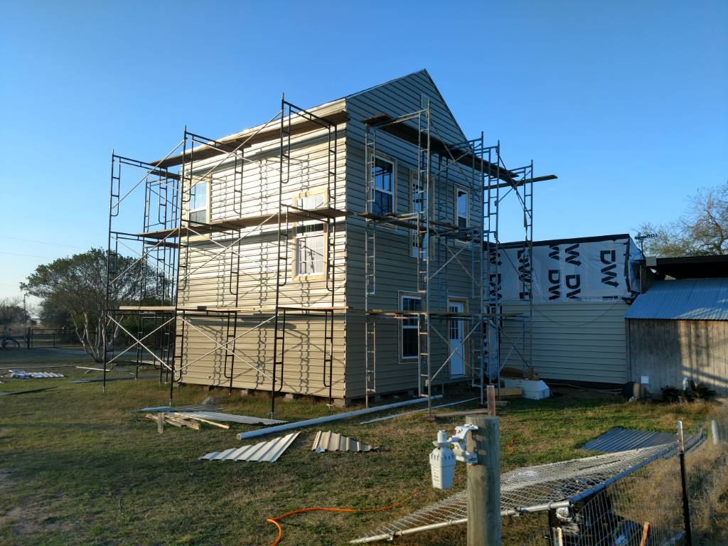

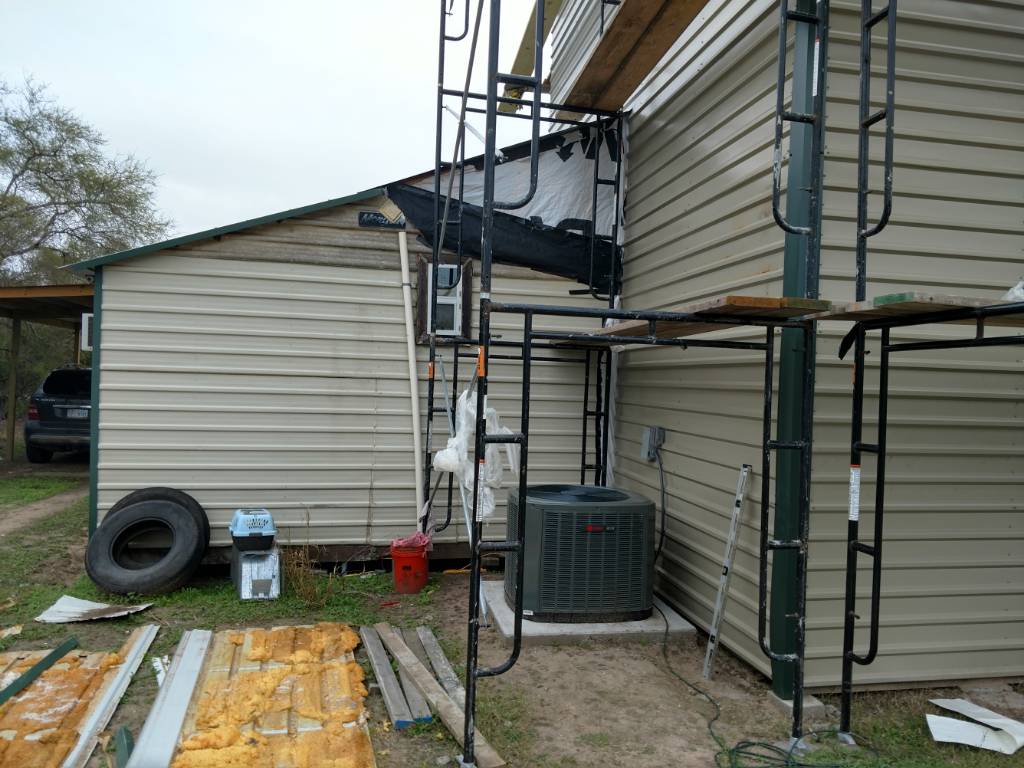

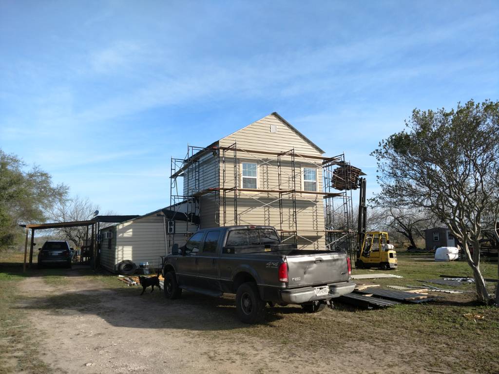

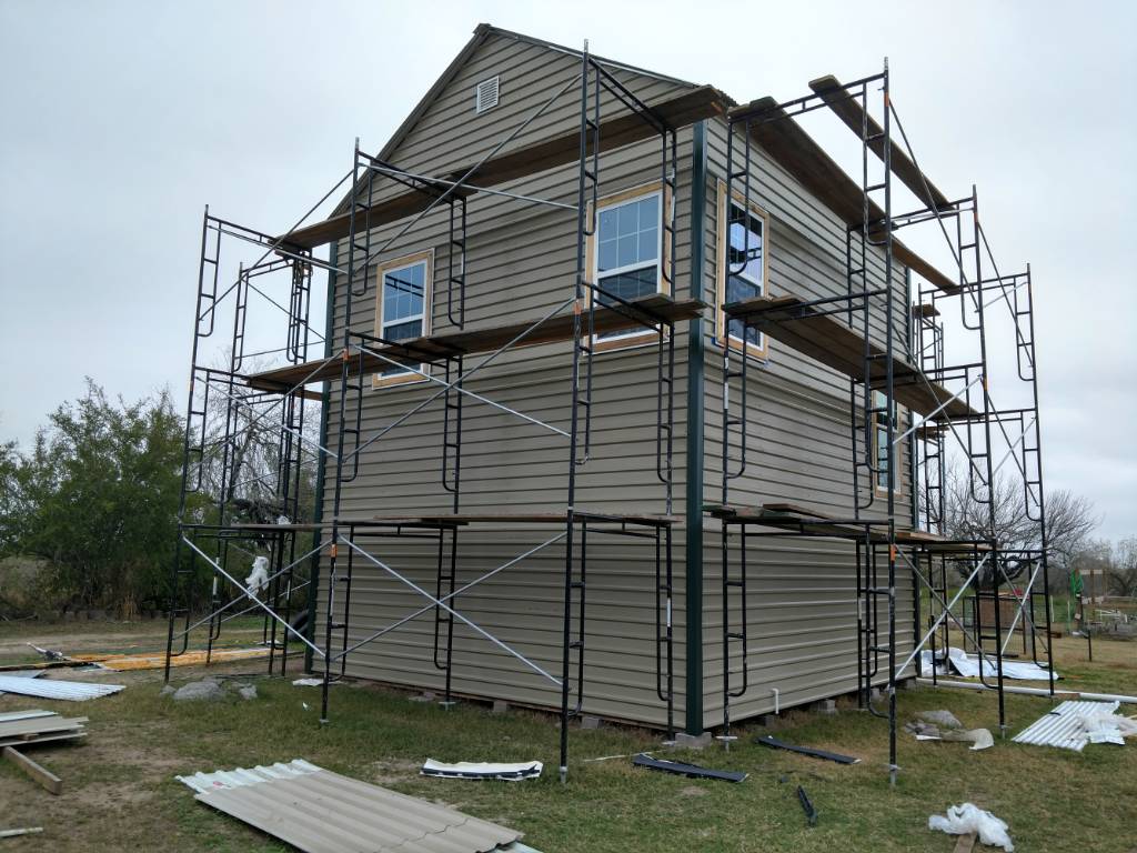

The corner trim is up, electrical rough in is done, I just need to run the drain line on the plumbing. My wife had just about finished insulating the walls, we're going to get the attic ladder and installation done tomorrow. Drywall should start tomorrow, anybody want to come help, or better yet do it for me?
I still have a couple areas on the new shed attic that need siding and roofing but, I still need access in there so I'm holding off on that. I'm just going to skin right over the existing siding and make it all match all the way around. It won't be that much more and I think it'll look 100x better than mixed siding.IMG_20180203_134455335.jpgIMG_20180203_125312639_HDR.jpgIMG_20180203_144736235_HDR.jpgIMG_20180203_125658987_HDR.jpgIMG_20180203_125638196_HDR.jpg

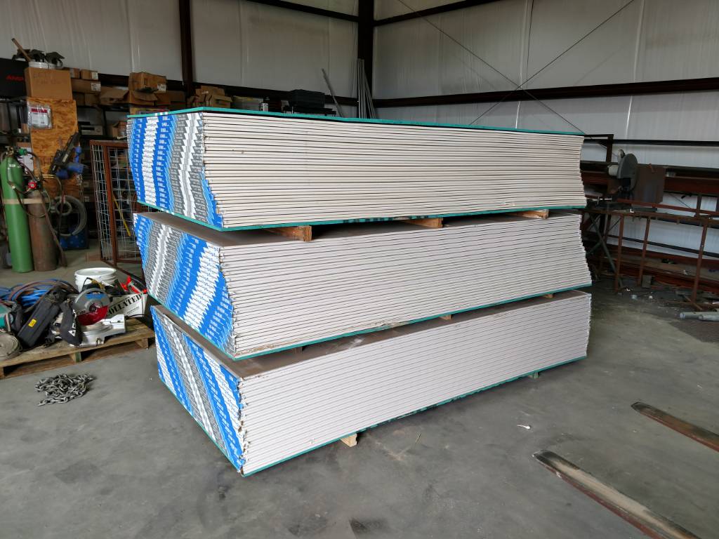

I've come to enjoy sheetrock. I make a lot of money with it, and after awhile, it becomes fun. Do you have a lift for putting it on the ceiling? If your rafters are spaced 24 inches apart, you need to use the 5/8's thick sheetrock, or it will sag on you over time. Popcorn texture and flat paint helps hide this, but eventually, the sheetrock will still sag if it's too thin.
#150

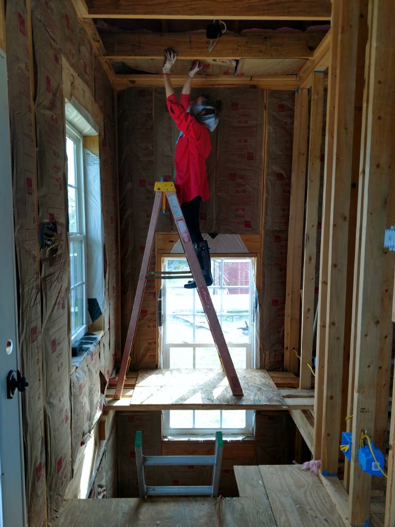

Come on down Eddie, you can do all.the drywall you'd like. I'll even let you play worth Kernel the baby wild pig! I'm to rent a drywall jack, it makes all the difference in the world.
Rafters are 24", I was planning to use 1/2" drywall, thanks for the tip. I guess I'll need to order some 5/8, although I hate using it.

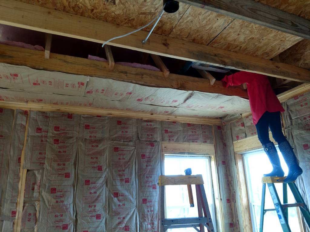

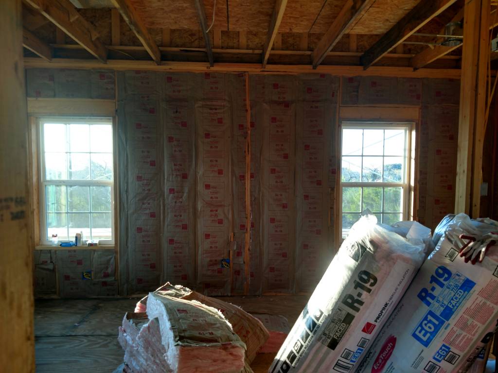

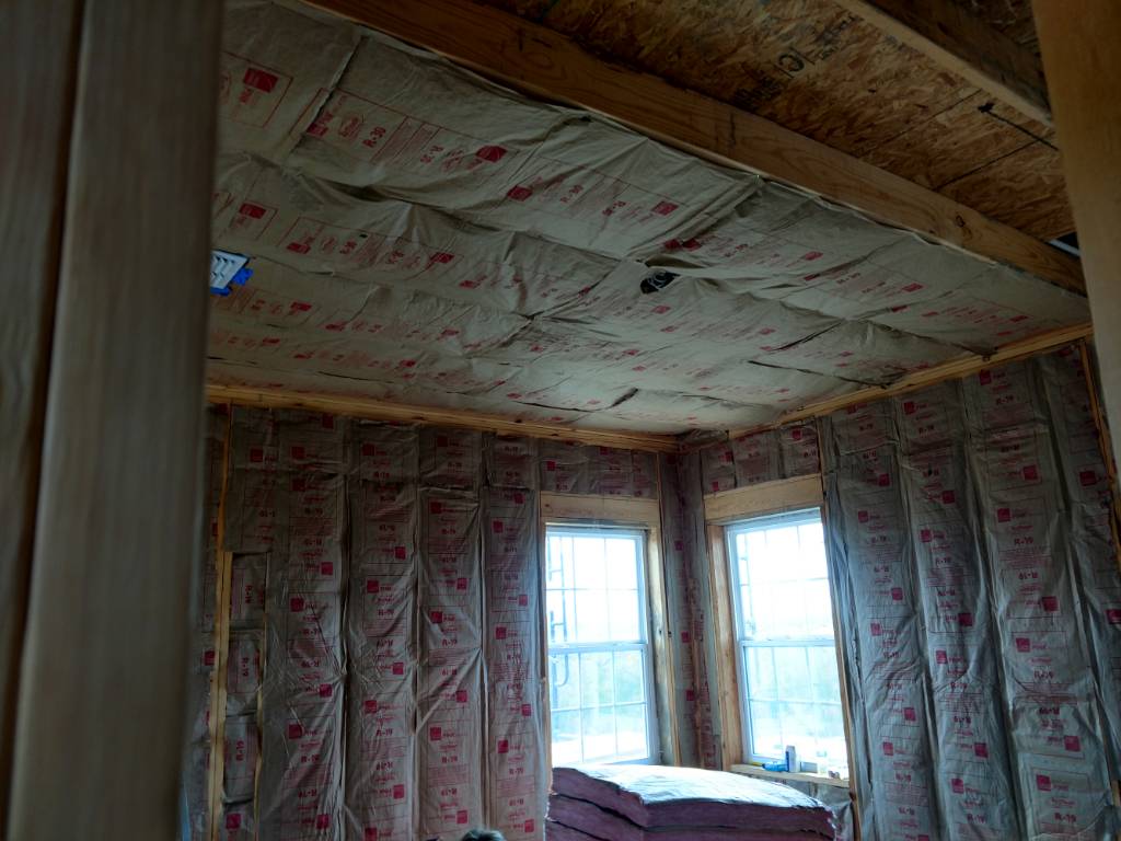

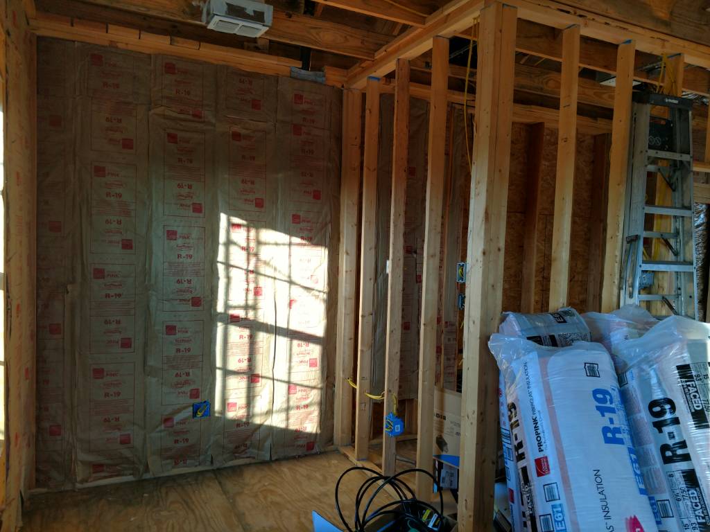

Working on the attic insulation today. Fun, fun!IMG_20180204_150744343_HDR.jpgIMG_20180204_145517789_HDR.jpgIMG_20180204_121522743_HDR.jpg
