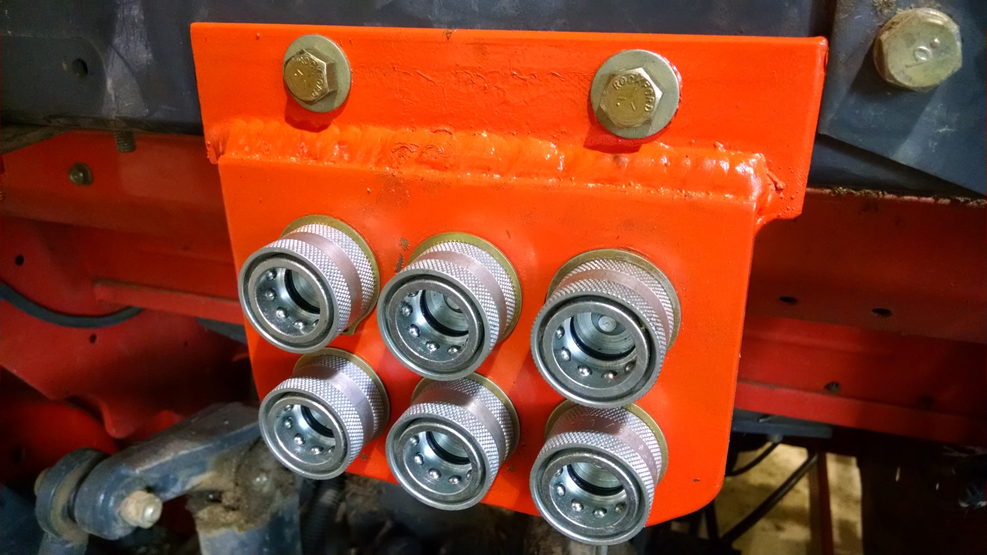

Island. While my setup is male/female and for the reasons you have outlined, I can think of a reason to use two females on the tractor side. If you mount the females with the breakaway mounting (mounted by the sleeve collars of the QD connectors) and you use double acting sleeve QD connectors, then you have two advantages. You have breakaway protection if you should do something stupid like forget to close your SSQA lever/levers and the grapple should come off the hoses will just uncouple without damage.
The second benefit is you have one handed connection connection and disconnection. Whereas you and I must use two hands to make a connection, one to pull back the sleeve connection on the female and the other to push on the male connection, with double acting sleeves and the females mounted to the loader torque tube by these connections you just push on the male with a single hand. Like wise to disconnect you simply pull on them to disconnect them.
So that is the thinking of the dual female double acting sleeve QD's on the torque tube. As for the two male connectors left on the grapple to protect them from dirt/damage, you could carry a female to female QD adaptor to put on these ends to protect them.

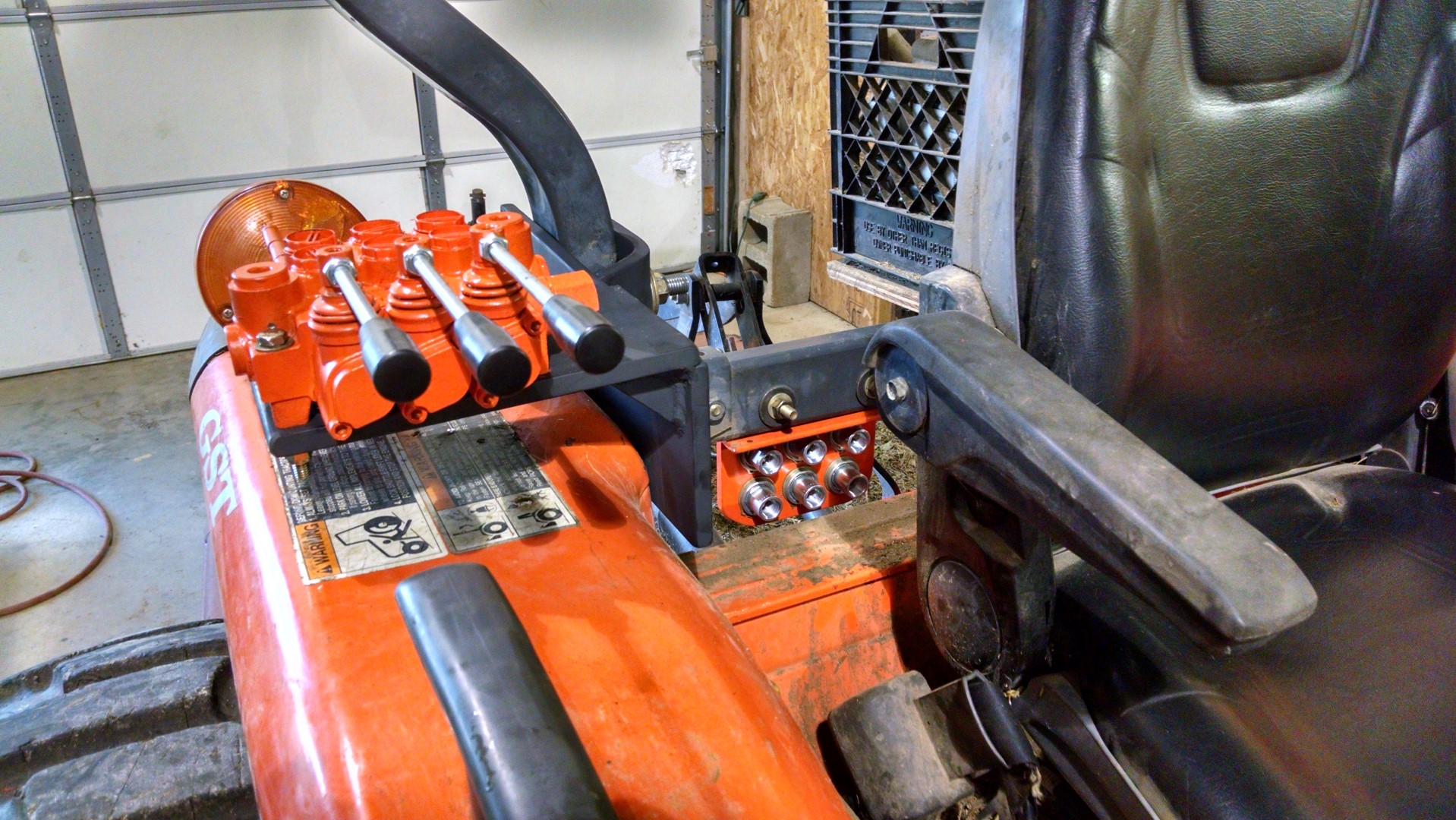

LD1 talked me into the double acting sleeve connectors when I had my RR installed. Dang glad I did it too!
