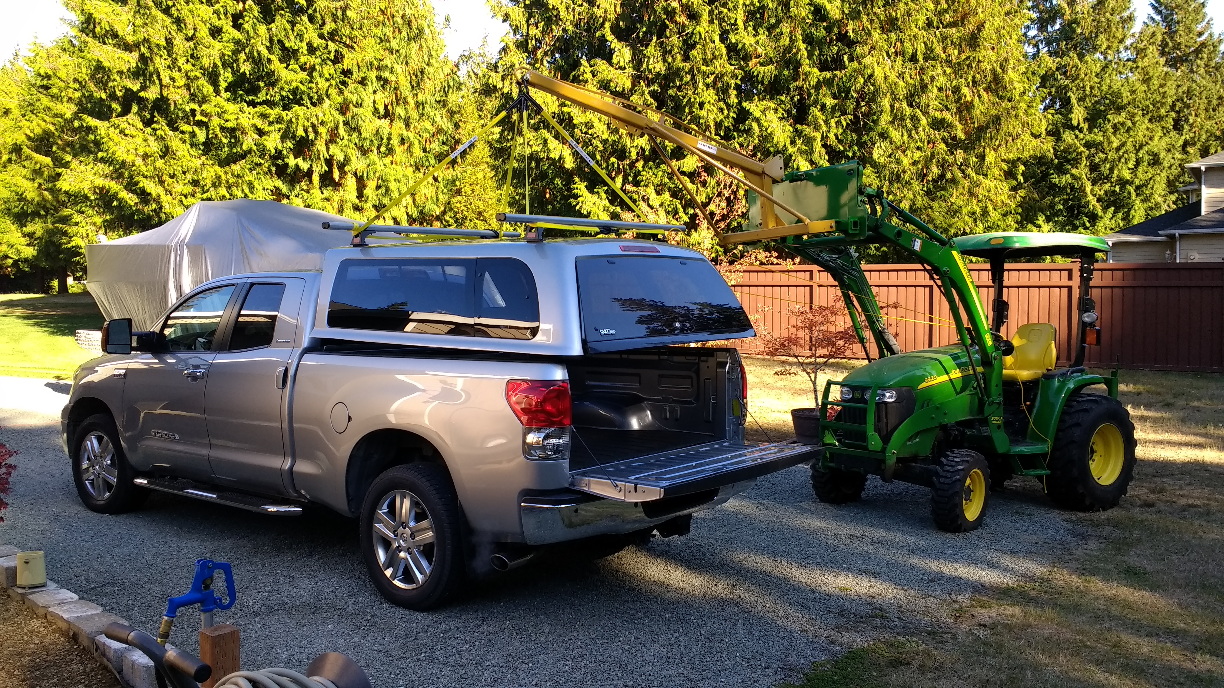

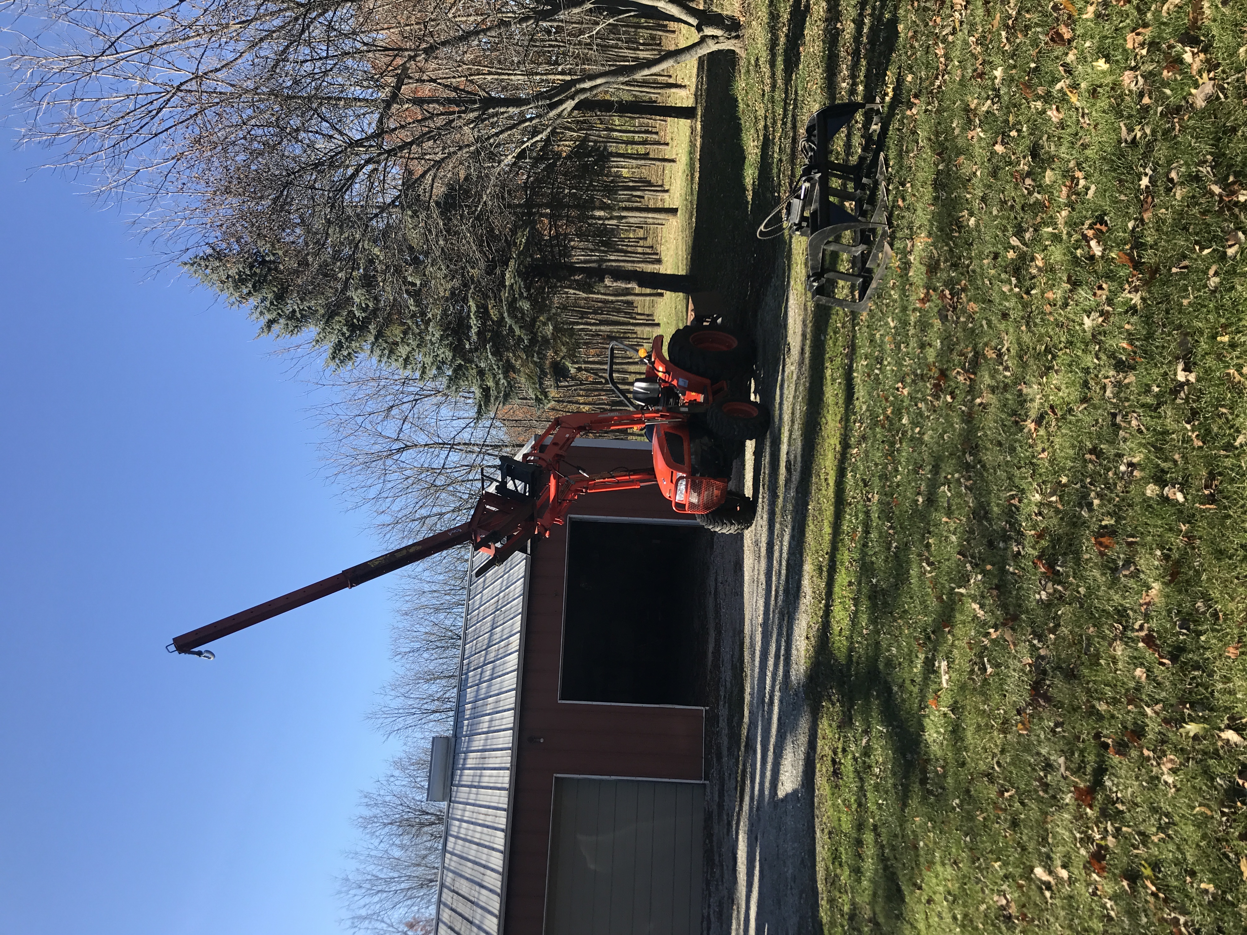

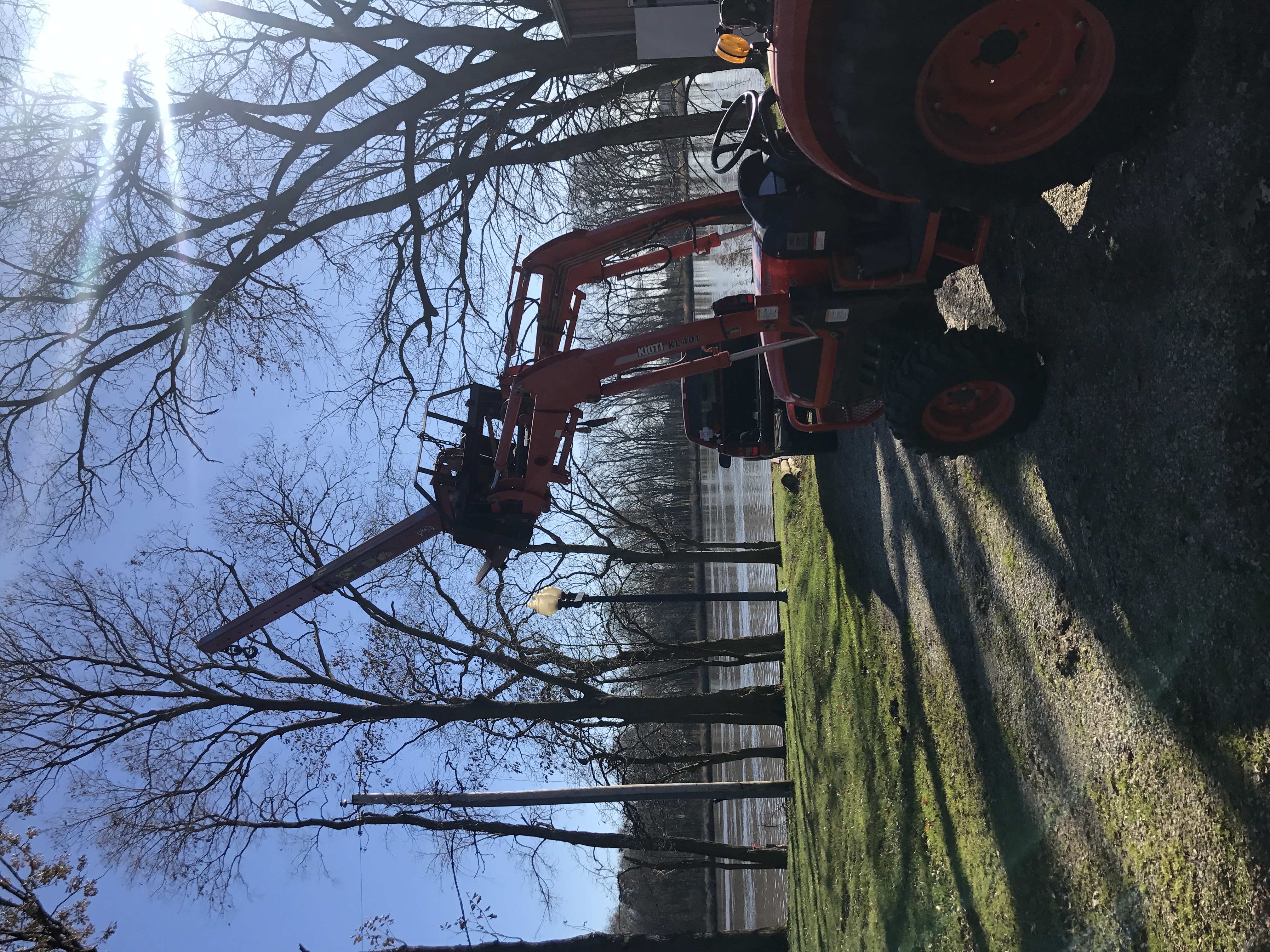

To answer your question, yes you will gain height by using a FEL mounted boom. You can also add a hydraulic top link to your 3pt which will gain some lift height. Whether it's enough to load a trailer depends of course on the trailer height.
Using any FEL attached implement requires an abundance of caution to avoid damage and / or injury. I've been using a FEL boom for many years now without incident. I use mine mostly for lifting furniture and light appliances (less than 300 lbs or so) up onto my 12' high deck. At my age, carrying these items up and down stairs is no longer an option. I also load items into my dump trailer which has 48" high sideboards. I can't do either with the boom on the 3 pt and hydraulic top link.
I don't lift anything close to the max FEL capacity more than 5' above the ground and only lift on level stable ground. Bouncing around in the woods carrying a 1000 lb log on the end of a FEL boom is a recipe for disaster. Likewise dragging that same log at an angle to the direction of travel (making sharp turns) is a sure way to bend or break the FEL frame.

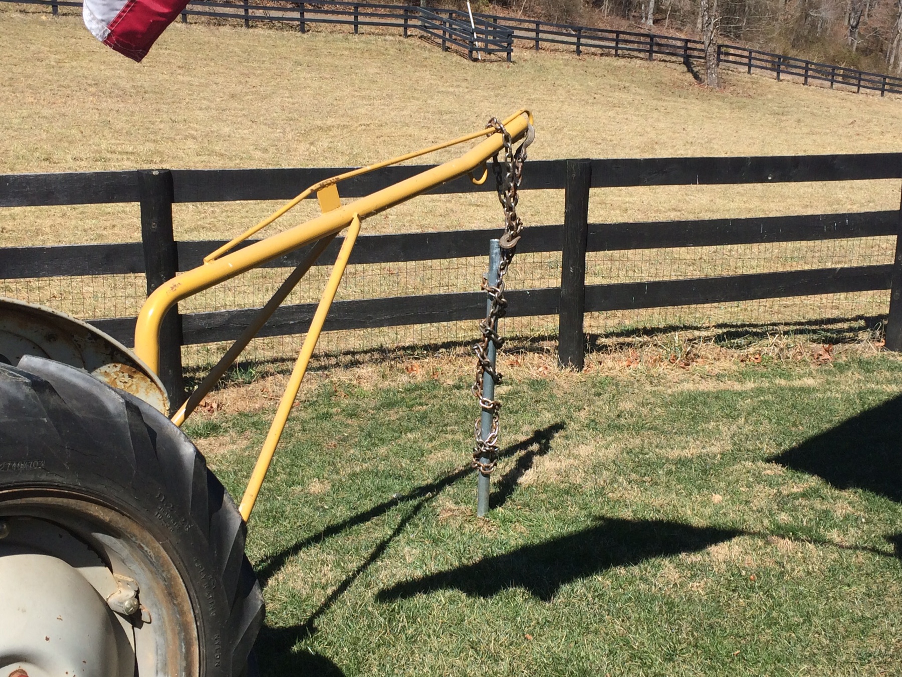

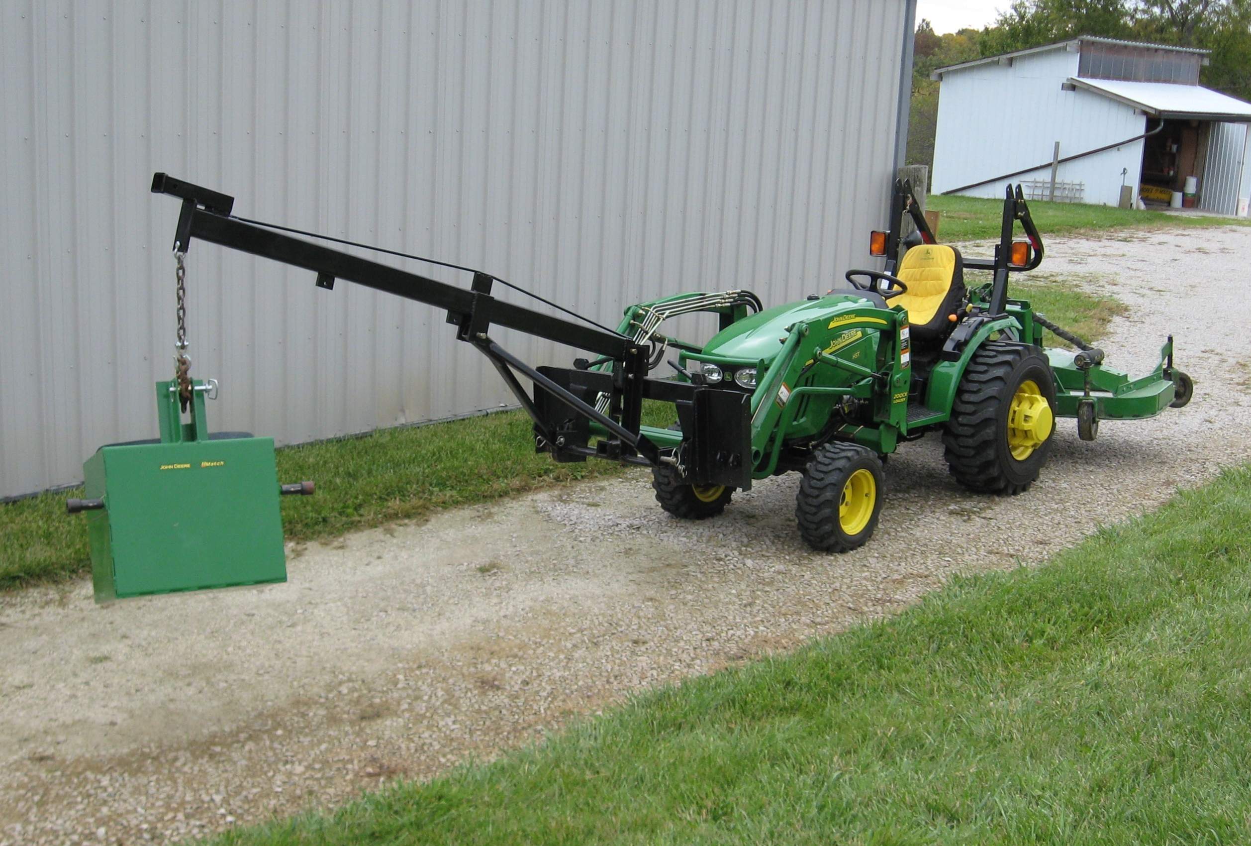

Built my boom pole in the summer of 2005, for long reach light duty lifting. The front axle is solid to the frame, no pivot, so very stable with weight up on the loader.
It sets on the forks, with a brace to the top of the fork frame:
/ Finally got a Boom Pole #28
/ Finally got a Boom Pole #29
What boom pole is that? I know you are using the titan SS adapter, but I like your setup.
Thanks!
I use this one from Titan:
The design has changed somewhat since I bought mine. The current model is slightly different than the one in the pic I posted.
