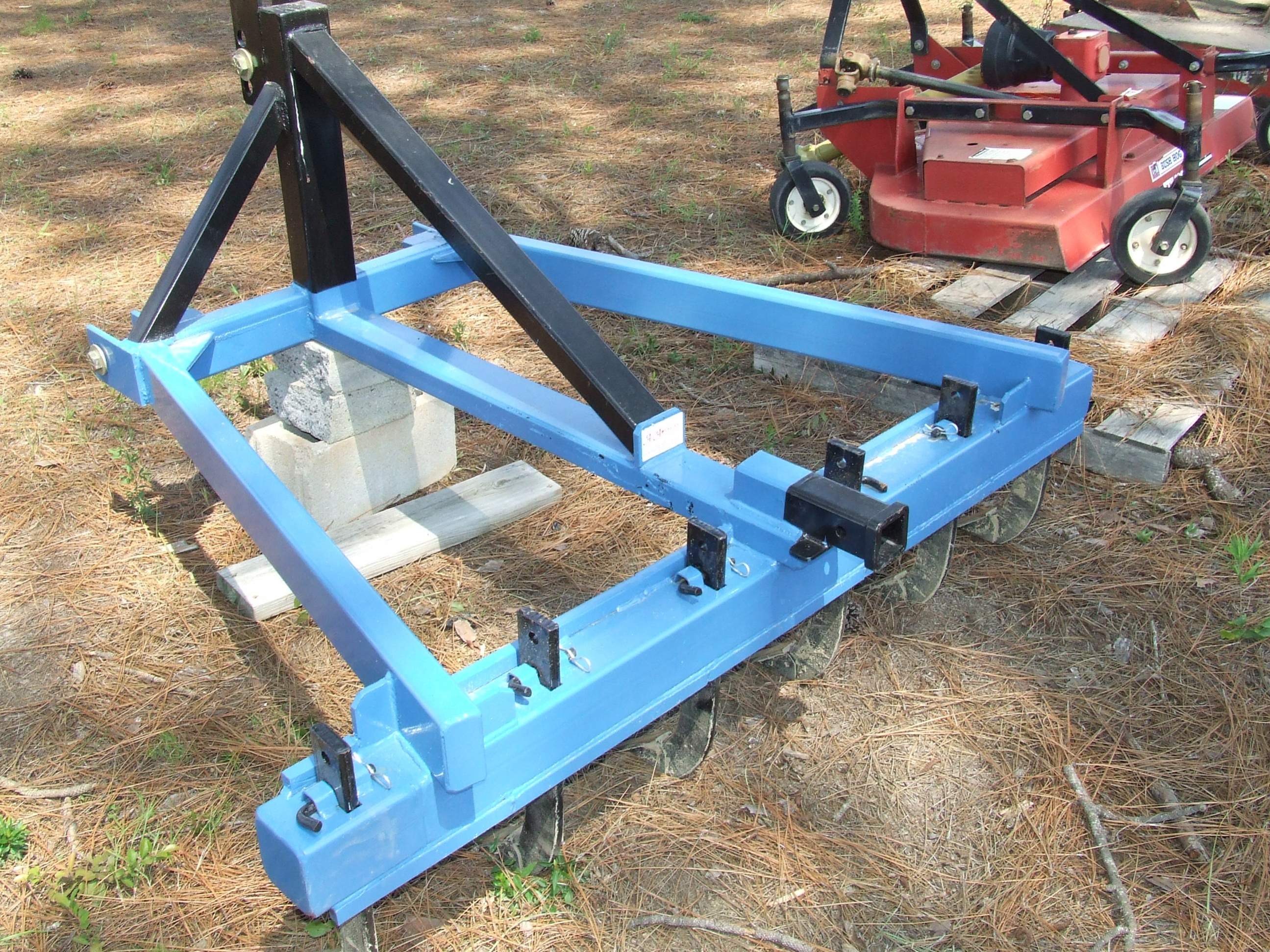

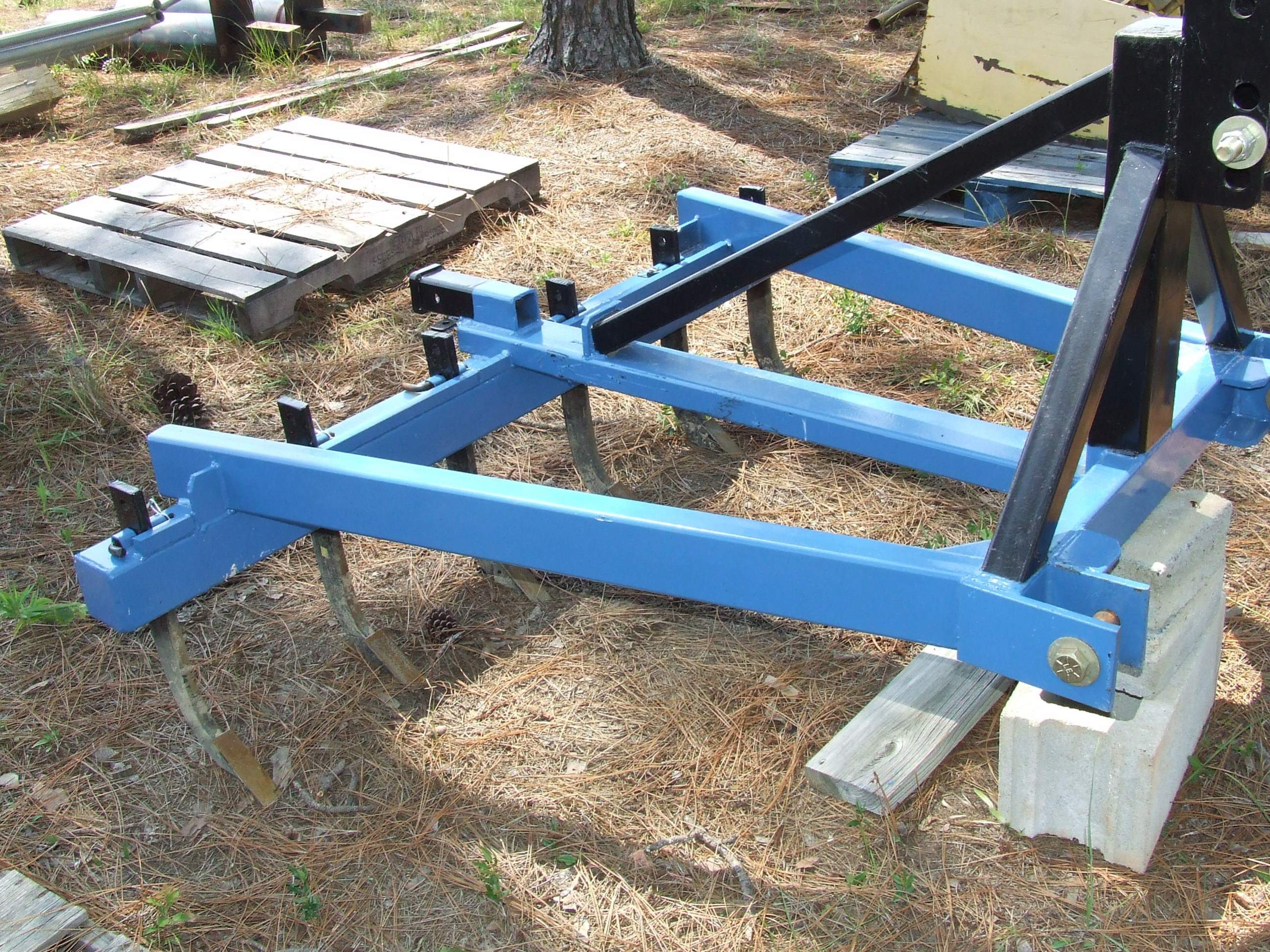

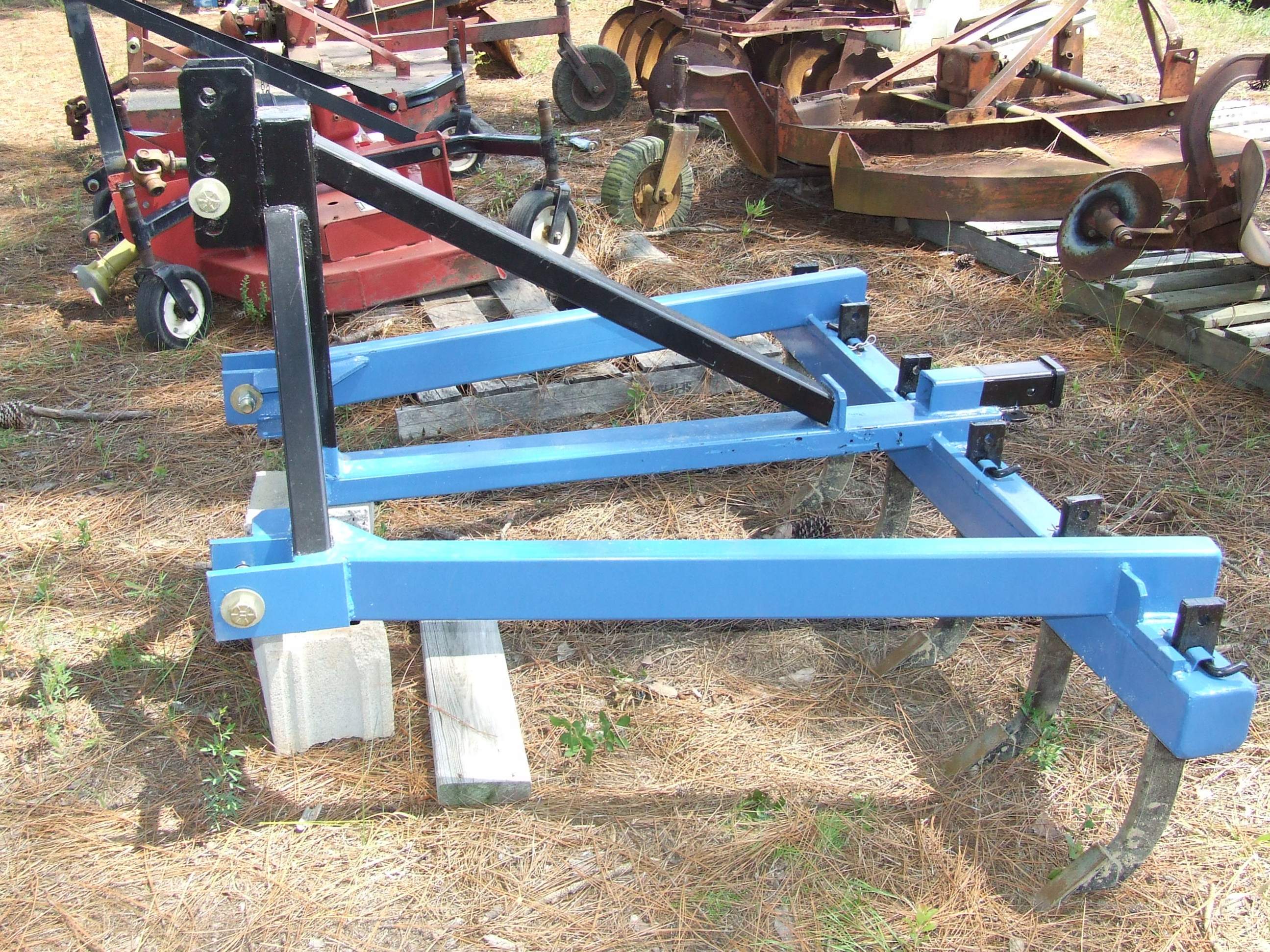

I started thinking on this about a year ago. Something to drag brush and pulpwood leftovers from hunting lease. Also a pretty good ripper tool.
Drew up a design and got with my buddy Jim at All American Equipment and this is what came from it,. I call it the Beast. Reinforced every where we could think. Don't think my TC 35 will tear it apart. Seatbelt a must when working around roots and stumps. Trash doesn't get up on rear tires like on my BB. 66" wide w/16" rippers. Threw in the receiver hitch for extra's, you just never know.

Now if you just had a little drop down support foot for the front, you could use those concrete blocks for something else.

Thanks Guys, and working on the parking leg this week.

Do keep your foot near the clutch and one eye on the rippers for snagging you to a stop resulting into a scary tractor wheel stand. I know.

Nickel I sure do! Had one of those moments the other day with my box blade and a sand ditch.. pucker factor 10.
I saw where sweets farm equip had something similar to this and called it a pasture renovator . I didn't even know I had one of those now.
