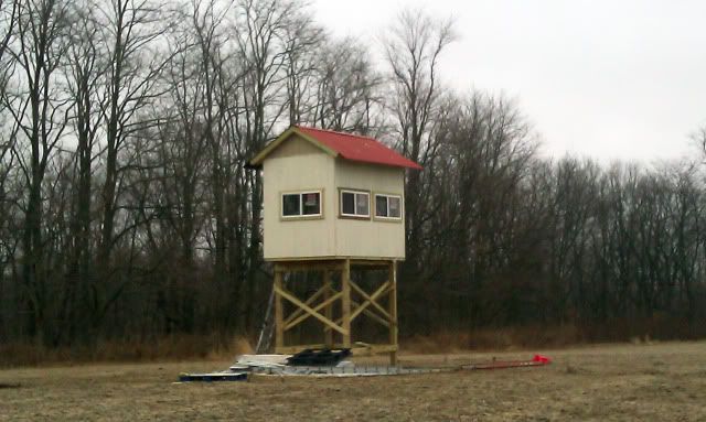

I made it out yesterday and was able to get the roof on and install the door. I ended up using the Ondura panels for the roof. Probably not my first choice for durability but the price was right. My lumberyard had several sheets that were damaged (corners split, cracked, or missing). Since I needed to cut them shorter it didn't really matter to me. I was able to pick up the 6 sheets needed for $10/sheet. I'll see how these last. Even if they only last a few years I'm not out much and can redo the roof with regular shingles.
I will say that after installing them, I don't think I would use them on anything other than a blind or playhouse. I've never used them before and there seems to be a very fine line as far as getting just enough pressure when driving the nails. Not enough and the nails didn't seat well enough and just slightly too much pressure and the nail would crack the panels. I had a few spots I had to caulk after overdriving the nails.
I still need to finish trimming out the building corners, windows, facia, etc as well as insulate the inside. It's at least sealed up from the weather now. Eventually I'll add stairs but that will probably be a spring project.

   / Finally building a tower blind #35
Looks great!!!
Are you building stairs to get in to it?
Eddie
   / Finally building a tower blind #36
I would have to take my boots off to enter that stand. Nice work!
