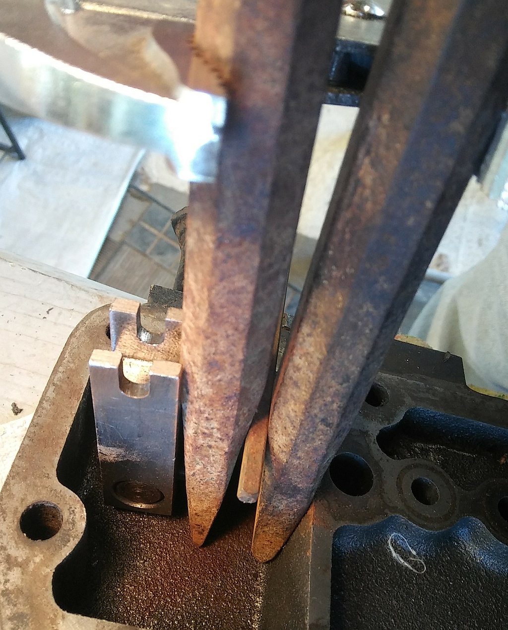

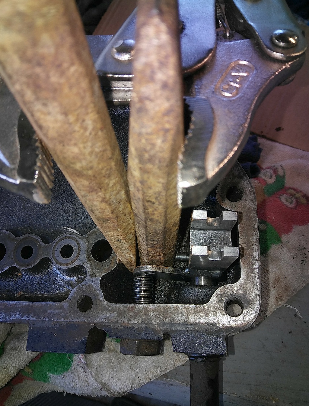

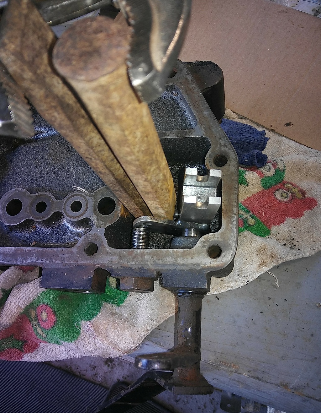

Yanmar must have a specialty tool to get that spring pin (rollpin) in, to attach the external lift lever's shaft to the driver for the internal hydraulic valve. This was a nightmare. (See parts 6, 7 in post #14 above).
The not-visible hole in the lever's shaft has to stay perfectly aligned with the hole in the block that the spring pin starts in. With the lever swinging free off the side of the workbench it was a miracle that the holes stayed in alignment as I forced the spring pin in.
This took extreme force. There isn't room to hammer on the spring pin so it has to be driven in by something similar to a screw clamp.
I used various flat objects to pry the pin in, being careful to not twist the block relative to the hidden hole in the lever. First I used the square top of a carpenter's nail punch, the only thing small enough to fit between the end of the spring pin and the cover casting. Soon more leverage was needed so I pried with a chisel 12 inches long. Finally, after the tip of the spring pin had passed into the lever' hole, extreme force was needed. I got a couple of old rusty jumbo chisels from the junk box in the barn and had to use them like expansion pliers, forced by Vise-grip pliers.
Thankfully this didn't bend the shaft that the pin went into. It seems like it might have.
Putting the second, 3mm spring pin inside the 5mm required backing beyond the first pin so the 3mm pin didn't drive both out the far side.
Mission accomplished. I added safety wire as shown in the Service Manual, and that part of the project is complete. When the rain lets up I'll go out and do the (easy) reassembly of that cover back onto the transmission.
And thanks to Aaron (Hoye) for having the spring pins that I couldn't find anywhere, and even the original paper gasket for the cover.
