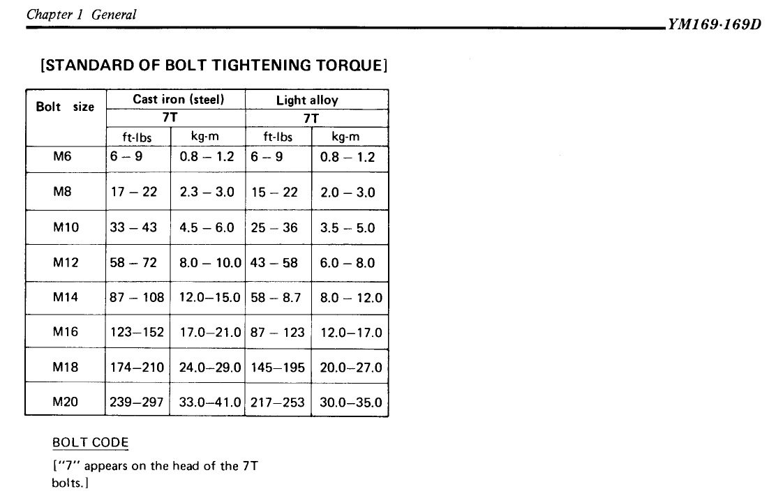

The YM169 Service Manual has some standards for bolt torques. It has Section 3 and Section 6 with great details of the hydraulic lift system.
