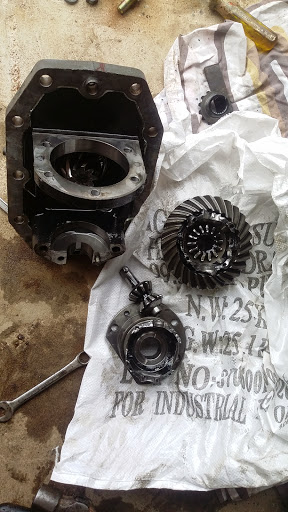

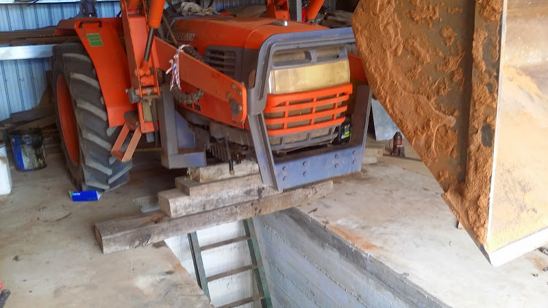

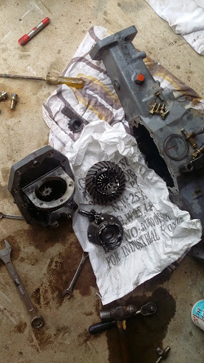

Think I have had her 13 years, treated her like crap, and she has finally got her back up! pictures tell all the story

I just hope I can get a replacement diff centre.

Phew, ok, I got to a dealer today with the differential centre in hand. It looks like I should have all parts here within 2 weeks, and to my surprise they were not that pricey, quoted round figures $570au for all the bits and pieces. Will keep you posted when they arrive and I start putting it back together.

In two separate incidences this past summer, I broke bevel gear cases, so I've seen some of the parts you pictured! On the bright side, you have a nice shop to work in; my repairs were all done 'way out in the woods, which was OK in August, but not so nice in November. It's good to know that parts can still be found after more than a decade; that can be important for any of us!

California, sorry for the late reply ;) , I dropped in today for the first time since Christmas 2014. I sure did get that differential back working in early 2015 and it is still going strong. when all the parts finally arrived they where slightly different from the originals but with a few extra shims I sorted it out, I had to fly by the seat of my pants and I put it back together guessing the tolerances by trial and error. When I finally got it back together I ran the tractor in gear on blocks for about 4 hrs to let everything bed in with absolutely no load. Its been one great tractor, abused now for 20 years and still going.
