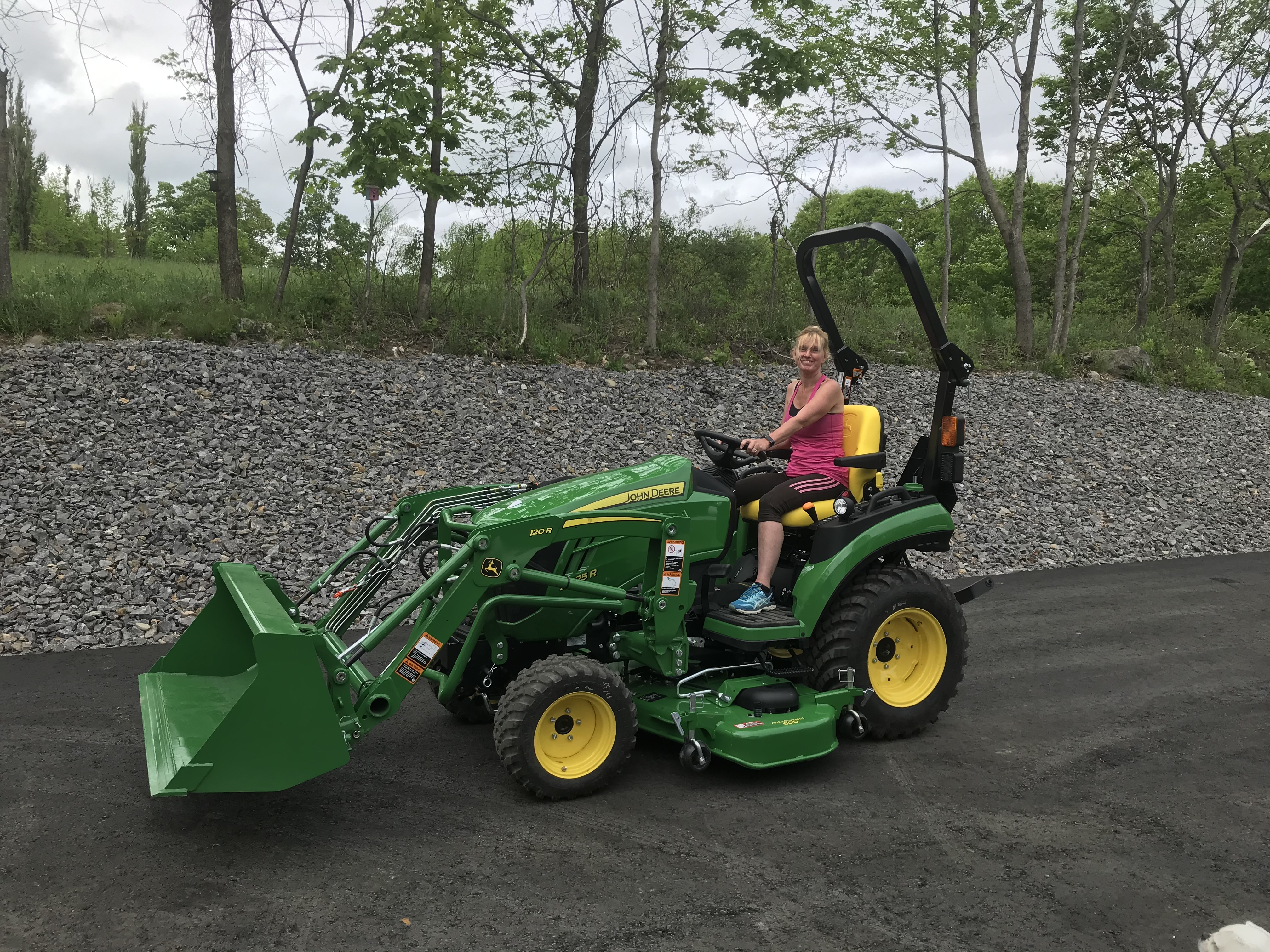

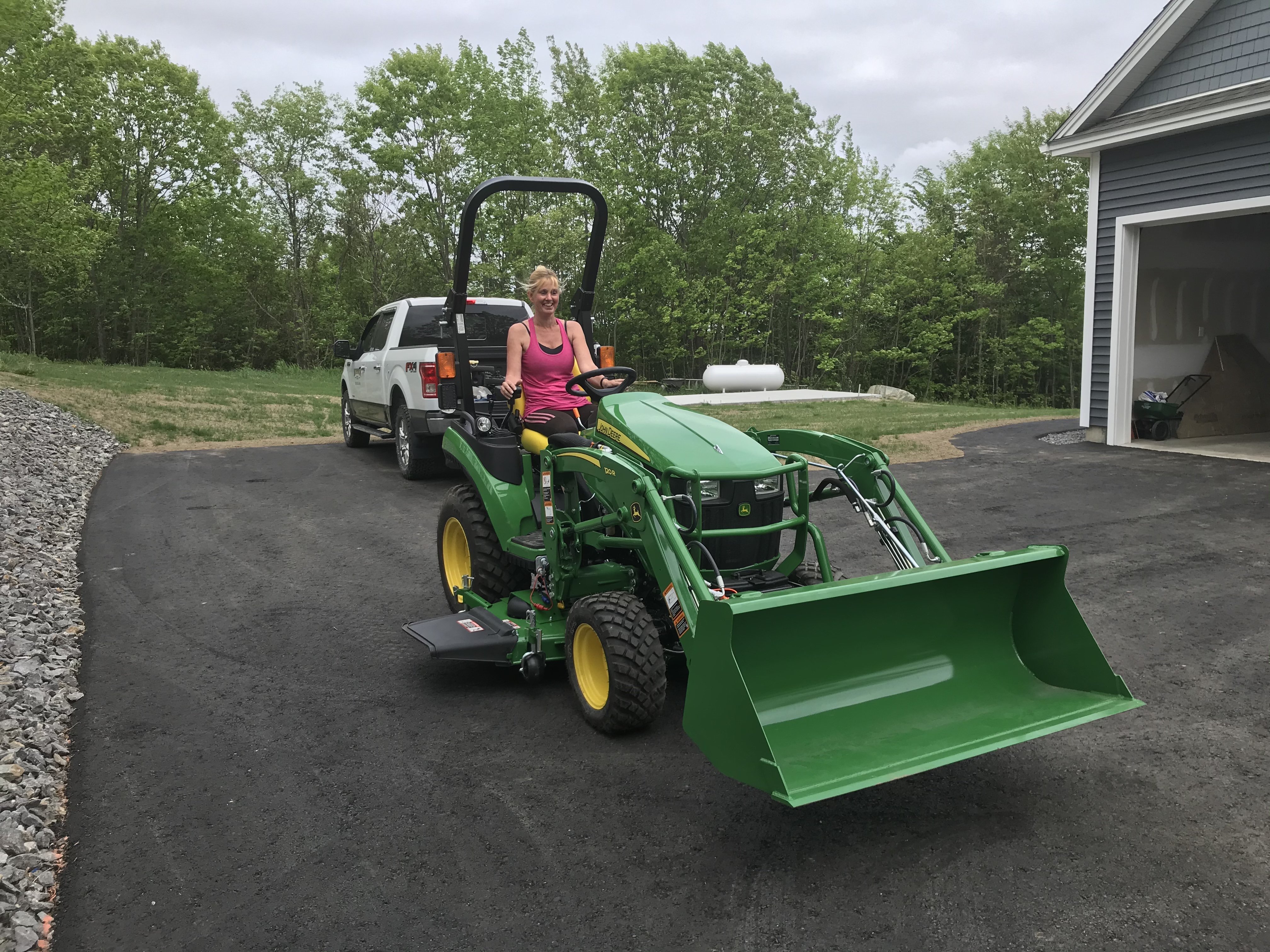

Delivered today. Got my Ratchet Rake in today also, and my Titan forks should be here next week.

Very nice, I’ve had mine for about 15 months now. Mine was about 21k out the door but no third function and I have the regular turfs. I’d say you got about the same deal as me. I really like how easy the loader and mower deck go off and on.
A WARNING. Don’t take the deck off and on with the loader on. The front draft arm springs up and gets caught by the loader stand and bends parts. Cost me something like $50 in parts. I did it a few times with no problem then wham, bent parts. On another forum I’ve read of it happening to several people. Good luck and enjoy.
