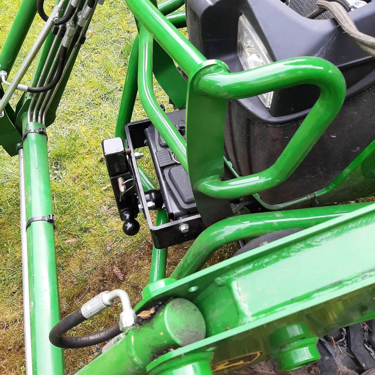

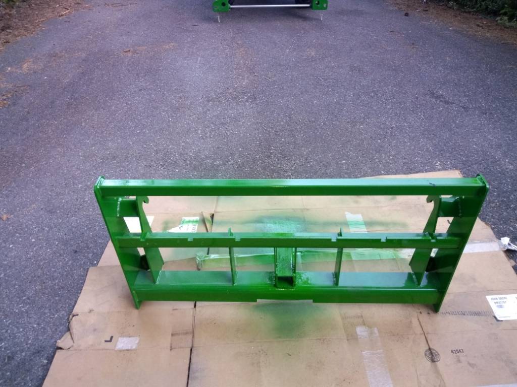

I added a 2 to 2 1/2 adapter to the fork attachment for trailer moving. And made a place to store the ball mount. IMG_20190505_191643526.jpg20200405_105752.jpg

Nice job. Are those the Frontier ones? Dealer wants $900 for them
I think I paid around 700. They are lighter than the ones Amazon sells. Every bit helps as these tractors don't lift a lot. Make sure they set the joystick pressure at the maximum of the range. It made about 350 more pounds of lift on mine.
