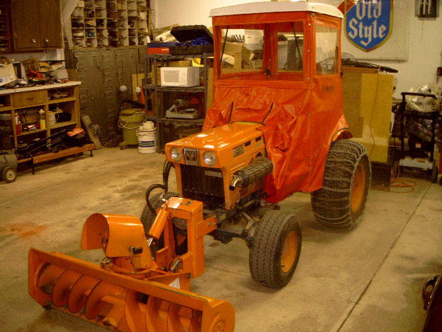

LHoyer said:
This is my blower set up. You can just see the pto clutch behind the hydraulic cylinder for the blower.
Hello LHoyer,
How do you like your snowblower? I believe I have the same one (Kubota B-648A Snow Caster).
How does it perform? Does it really throw the snow far? Is it fairly rugged? What about in heavy snowfalls?
That season is coming ......!!!
Cheers!
Eric
