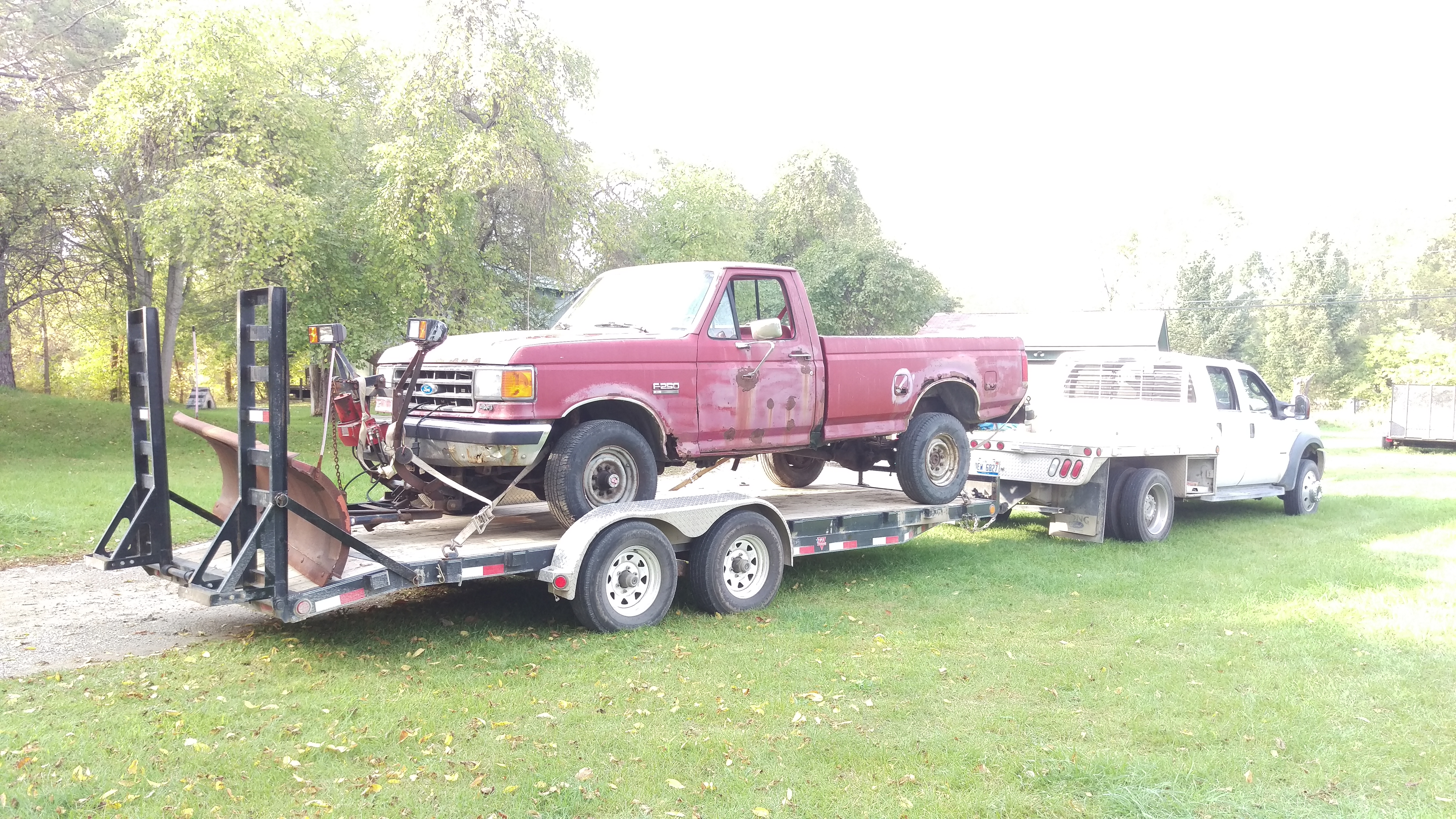

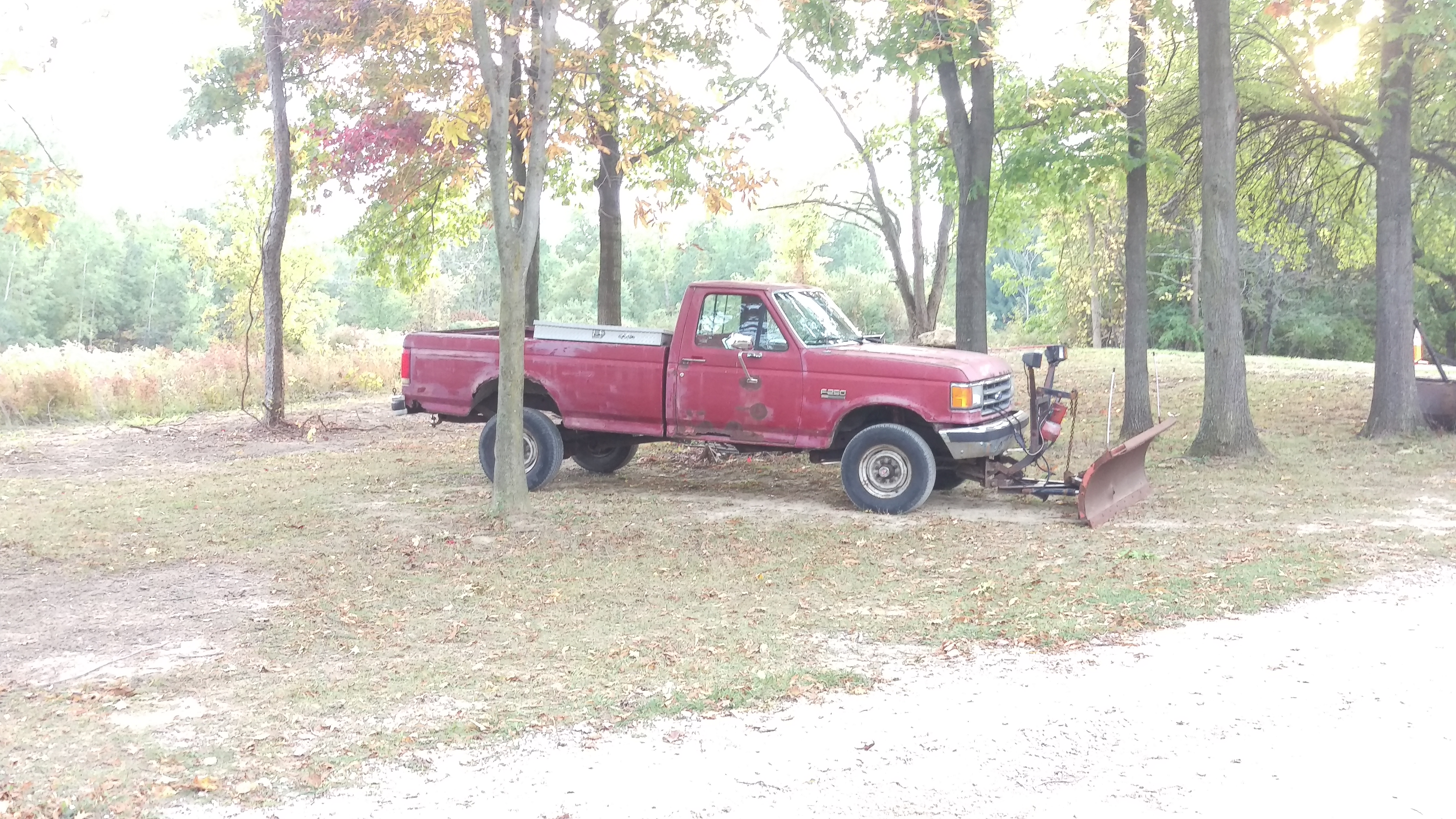

I sold that white F250 V10 a couple years ago now, have had that F450 6.0 PSD since. BulletProofed it this spring.
Although I also just picked up this '89 F250 plow truck...
How's the LS holding up? And how's the 6.2L working out in that new truck?
Lol i meant F-450, I see it no longer occupies your signature. Your "new" plow truck looks "experienced." I have been busy with college and haven't been to the farm in a month, but the LS was doing fine a month ago. As to the 6.2L powered F-250, that pickup has not seen daylight since mid June. :eek: We bought a 6.4L Powerstroke powered F-250 thats been driven a lot lately.
