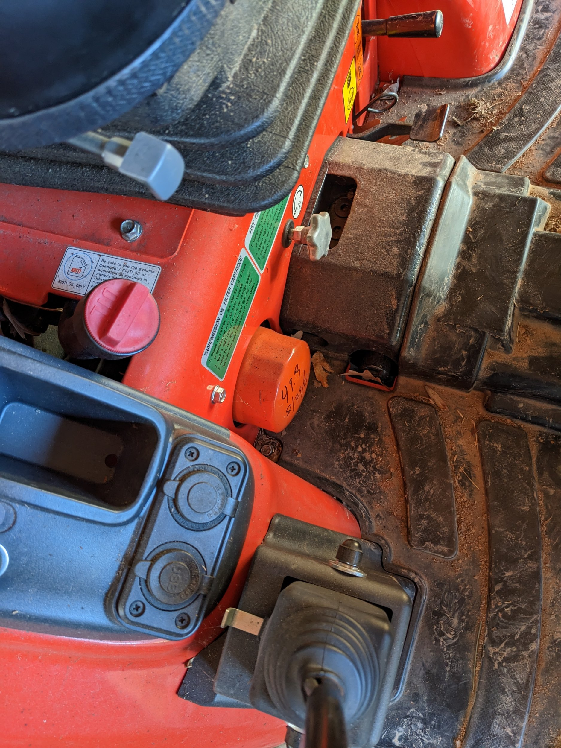

This filter on my CX2510 was a bastard. It's kind of tucked in to a corner. The socket style I had wasn't deep enough and kept slipping off. The 15 inch pliers I mentioned before ended up getting it off.
What a horrible location, accessible to damage ur heel hitting it and bad spot to remove, that's crazy what we're they thinking

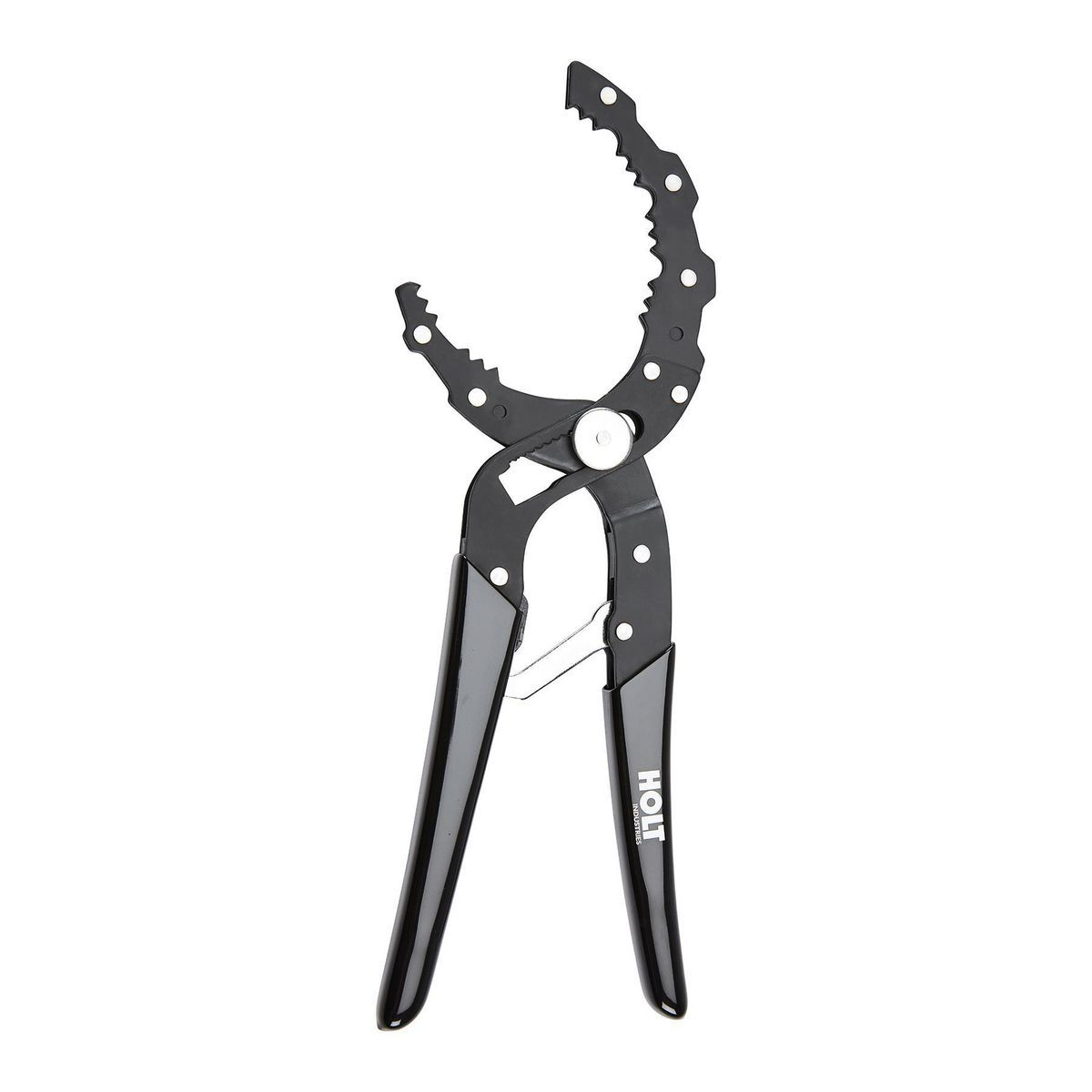

I have used this one: Filter Wrench
I have used every strap wrench, every object calling themselves a filter wrench, and even a homemade wrench called a screwdriver-through-filter wrench. But those channel lock style wrenches work the absolute best!
Absolutely agree with this.
There's self-adjusting versions as well which is what I use. I like this particular one because they open up wide enough for the gigantic spin on filters on my medium duty truck
