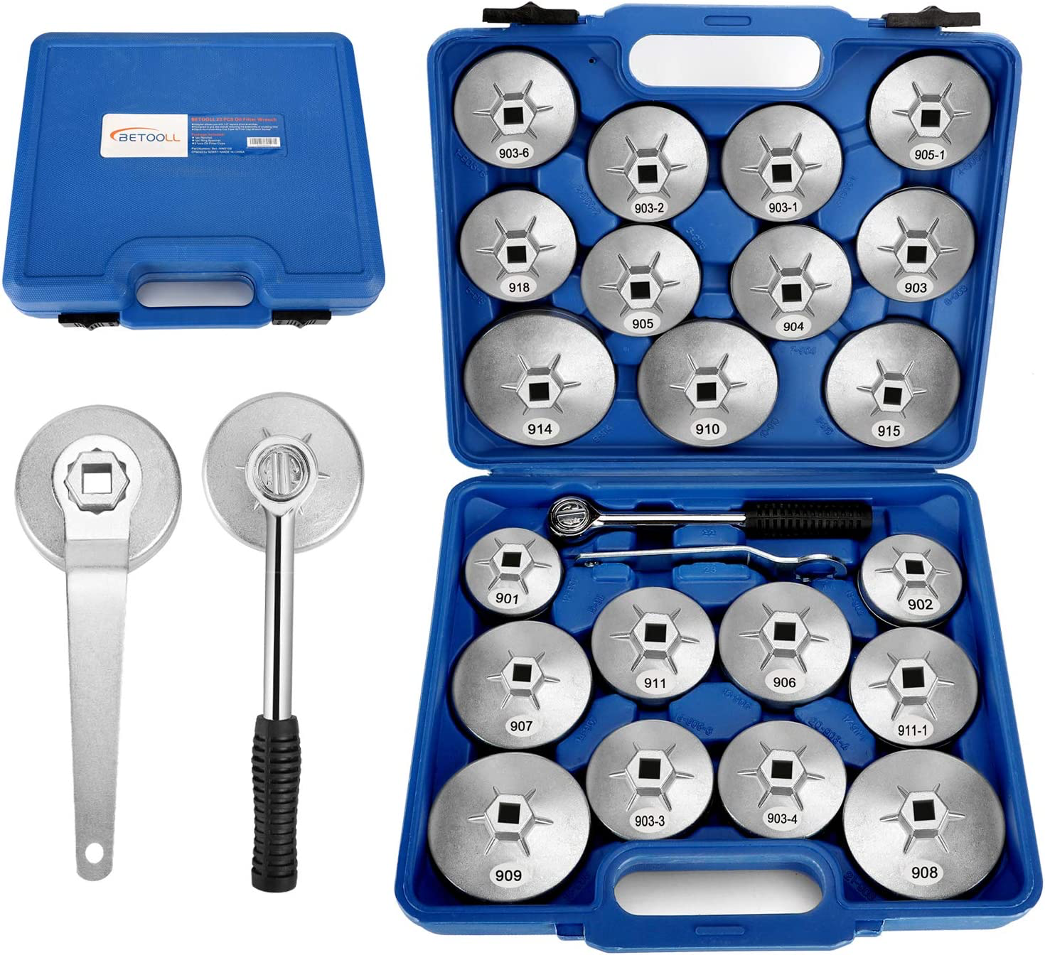

I use this style (one i have is a little different).
I can set it in place (grip the filter) in tight spots with my fingers, and then put the socket wrench in to loosen it.

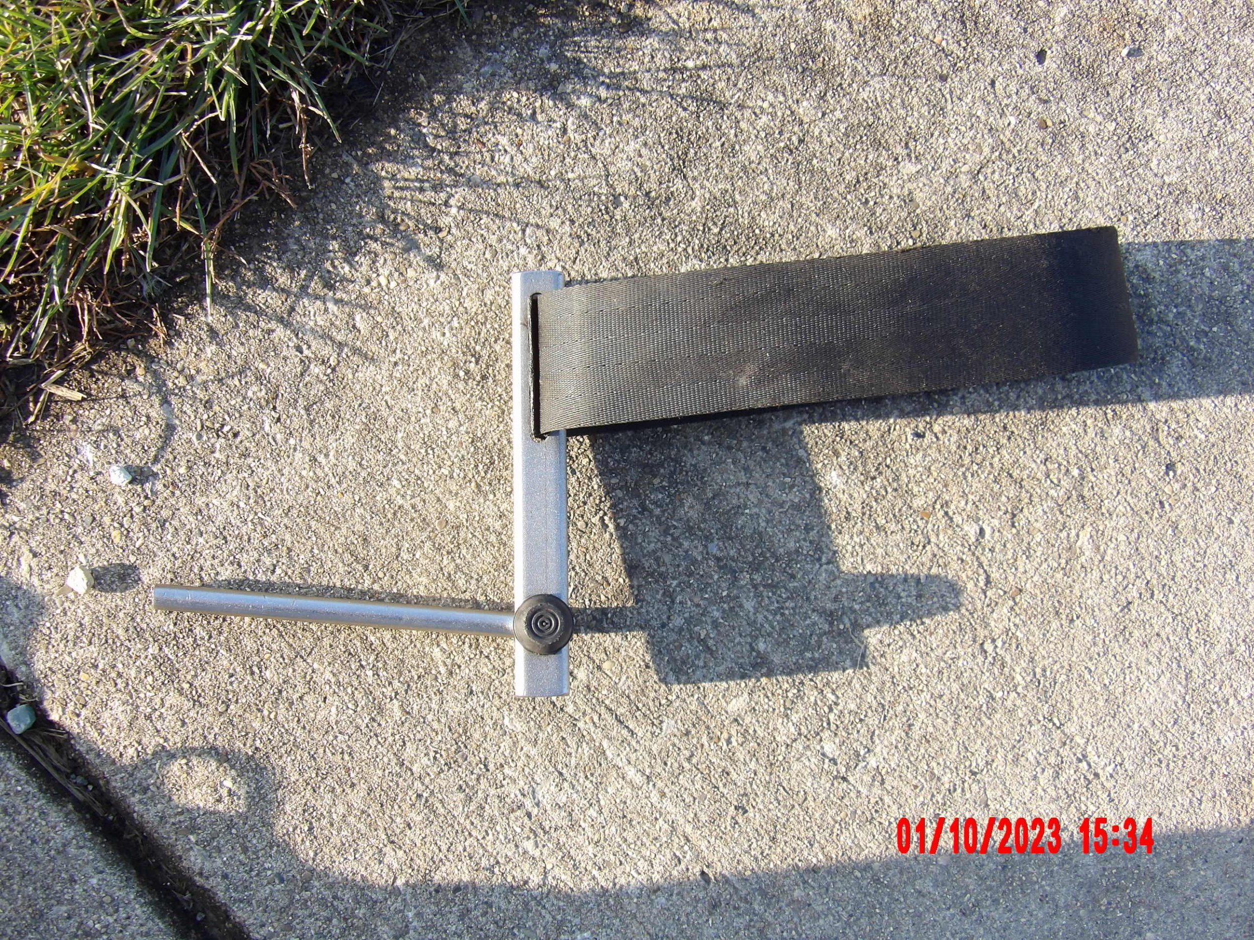

I am sold on this type of strap wrench. It has worked on every filter that I have attacked. With the assistance of a cheater pipe or 1/2" drive ratchet, it has removed even those that the strap crushed, which helped break the seal of the filter. Good luck

I am sold on this type of strap wrench. It has worked on every filter that I have attacked. With the assistance of a cheater pipe or 1/2" drive ratchet, it has removed even those that the strap crushed, which helped break the seal of the filter. Good luckView attachment 778679
i agree on this style. I carry 2 on my service truck for generators. Work every time.
