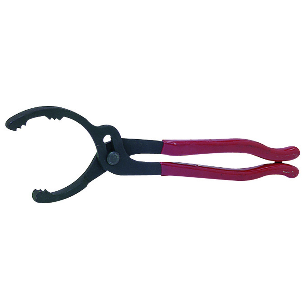

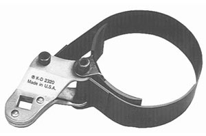

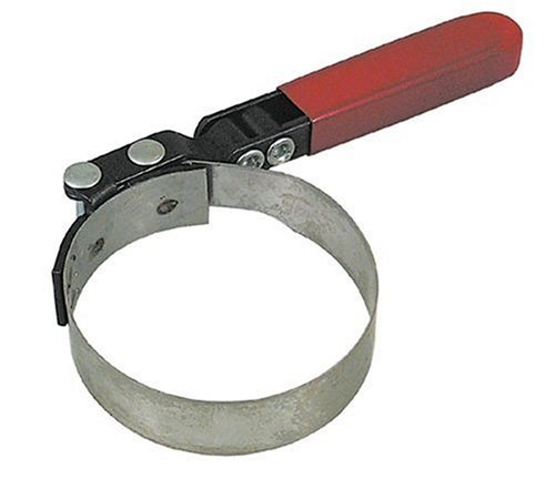

Most people use something like this. 41H31jGU1yL.jpg some prefer these that use a ratchet or breaker bar, KD2320-L.jpg and others prefer the pliers type image_17544.jpg then there are the widgets that work on the end of the filter using a ratchet and I've even use common plumbers strap wrenches for the hard to access filters and you could also use a chain wrench which is a strap wrench that uses bicycle chain instead of a rubber or fabric strap.
I've never seen one like you have and it doesn't look like it would be very effective ero the very low price.

I picked up some pliers at o'Reilly and a ratchet type grabber at nappa. The pliers were slightly angled so I thought they might fit in the opening easier. I tried the ratchet first with several extensions and after getting a good bite, the filter came right off.

Most people use something like this. View attachment 490123 some prefer these that use a ratchet or breaker bar, View attachment 490124 and others prefer the pliers type View attachment 490125 then there are the widgets that work on the end of the filter using a ratchet and I've even use common plumbers strap wrenches for the hard to access filters and you could also use a chain wrench which is a strap wrench that uses bicycle chain instead of a rubber or fabric strap.
I use the 'strap/handle' one only on my D110 due to the relatively small size of the filter. Everything on my 4105 is done with a larger 'pliers' type, which I bought at my JD dealership... it also removes/tightens the cap for the hydraulic filter.

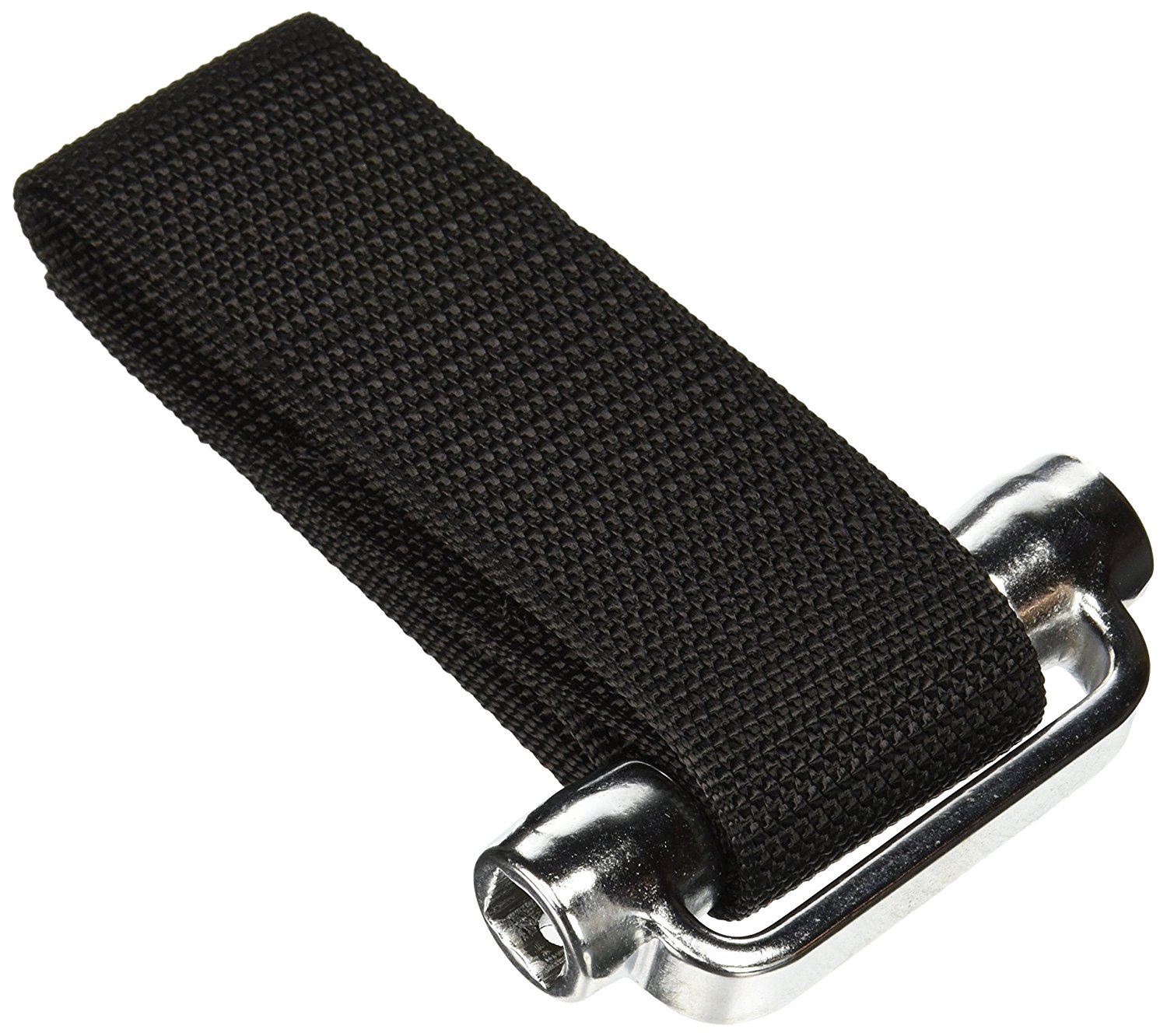

I have a version of something like the 2 links below . Bought it at my local Freightliner dealer . Catapillar brand . Goes up to pretty good size , but smaller filters can be a pain , since it is designed for bigger stuff . Clearance issue's are never a problem in most cases since if You can slide the strap on , All You need is to use extensions with ratchet out of the problem area .

Here is what mine looks like :
