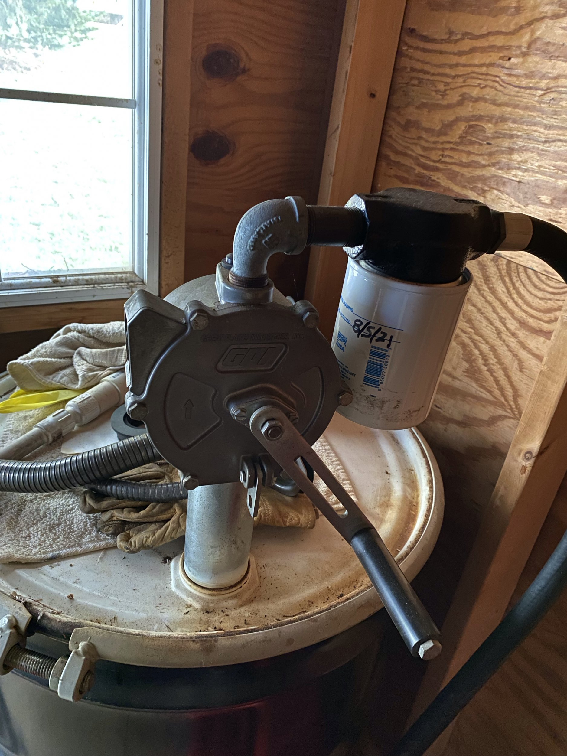

Do you guys have any ideas on how to attach a filter to a 55gal drum?
/ Filter for diesel storage tank #19
/ Filter for diesel storage tank #20
Looks good but I have an electric pump with hoses.... I guess it could be hard plumbed in (y) and a filter added like you show. OR maybe I should just break down and buy the rotary pump. Argh
