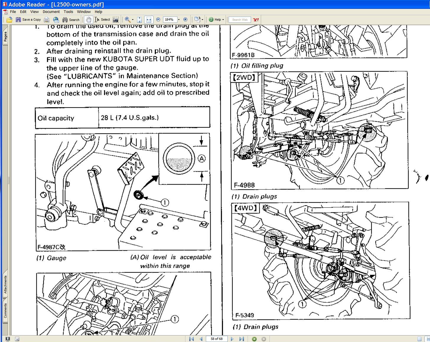

How can I tell my transmission is filled?
I removed the fill cover and can't see the level.
Thanks.

Welcome Brian, I have the same model and did all the fluids when I received
my tractor. There is also a screen filter/strainer to remove and clean if you are going to drain and refill. I ordered the maintenance manual from a local tractor dealer, pretty handy. There are quite a few drain plugs to remove to do a thorough draining, but make sure to be on a hard level surface to get an accurate reading on the trannny fluid level
   / Filling L2350DT Transmission #7
If the 2350DT (4wd) is like my 2500 there should be 3 drains for the hydraulic/gear oil. There is 4 on my 4wd.
Rob
