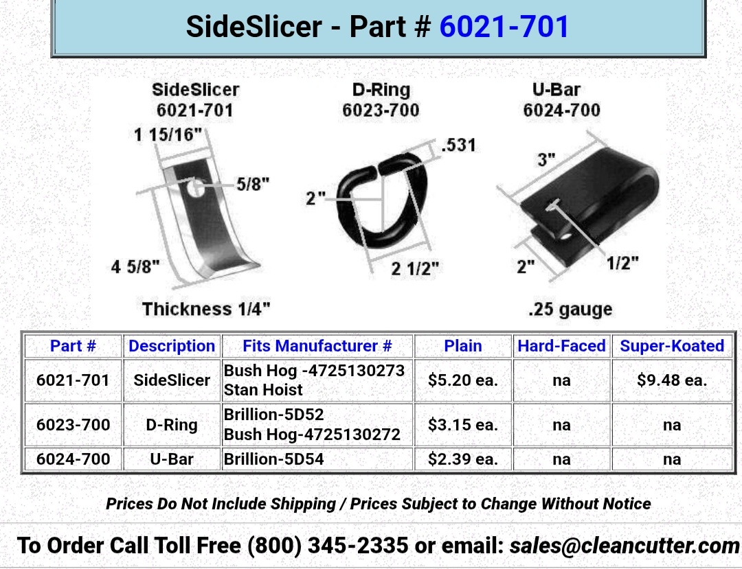

Hello, new member here.... I just bought a Bush Hog FH188 Flair Mower, and I need to replace several of the cutter blades on it. This is my first flail mower and the cutting blades look the letter "Y". Can anyone please tell me where I can buy new ones for this mower? I looked online, but have yet to find any blades for this mower. Thank you, Greg
/ FH188 #4
The Bush Hog FH188 flail mower is a rebranded Alamo SHD88. It uses the same blades as a Alamo / Mott. FYI Alamo is the parent company of Bush Hog.
Leonz has listed two places to get them.
Flail Master or Clean Cutter
Montage is another one.
/ FH188 #5
The "Y" blades are referred to as side slicer knives.
Do not reuse the cotter pins or the nuts and bolts,
please use new ones.
/ FH188 #6
Call this number 1-800-251-4020
willy
/ FH188
Excellent information, Thank you very much !!
/ FH188
#9
Thanks, again - good info....
