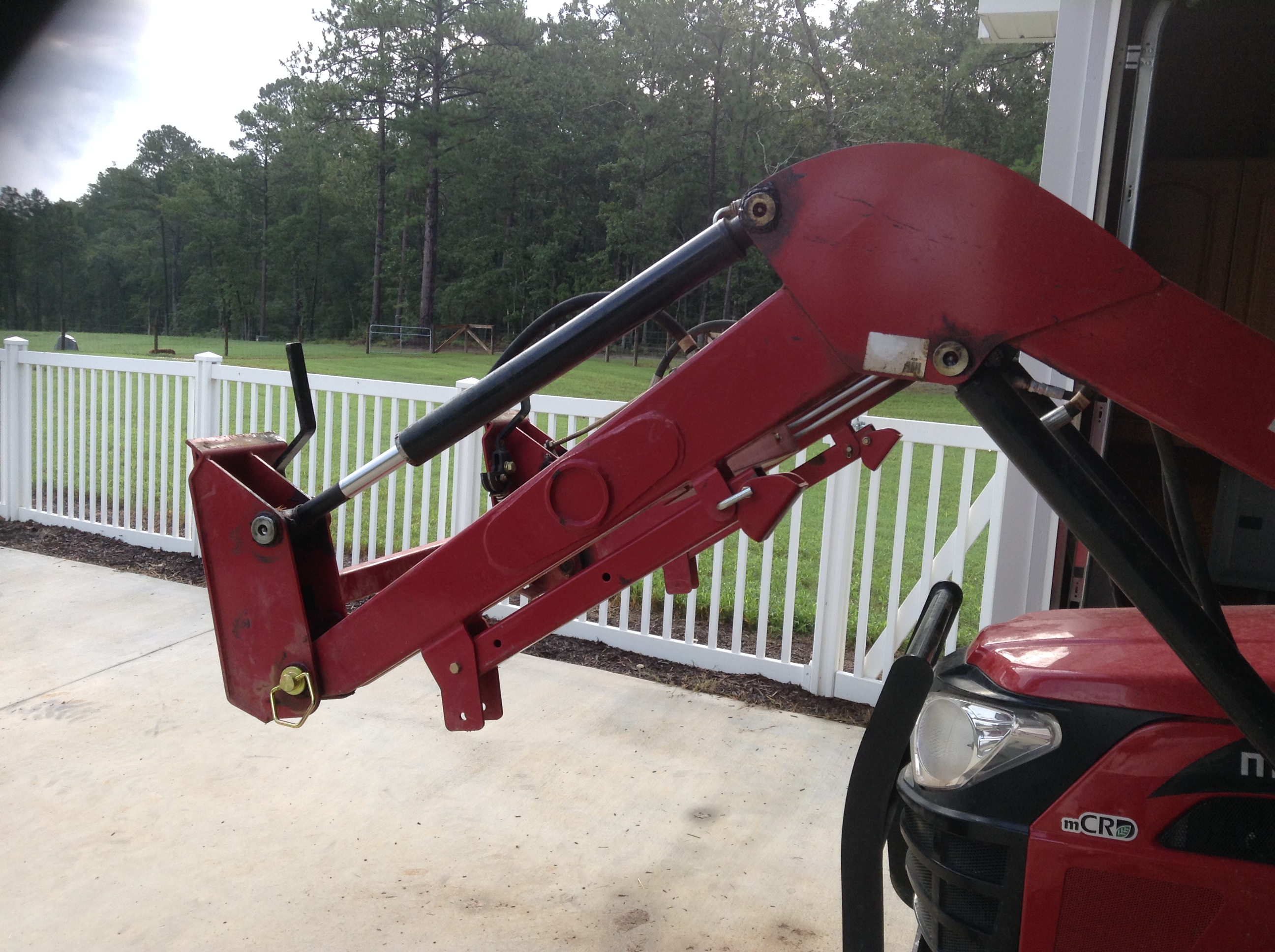

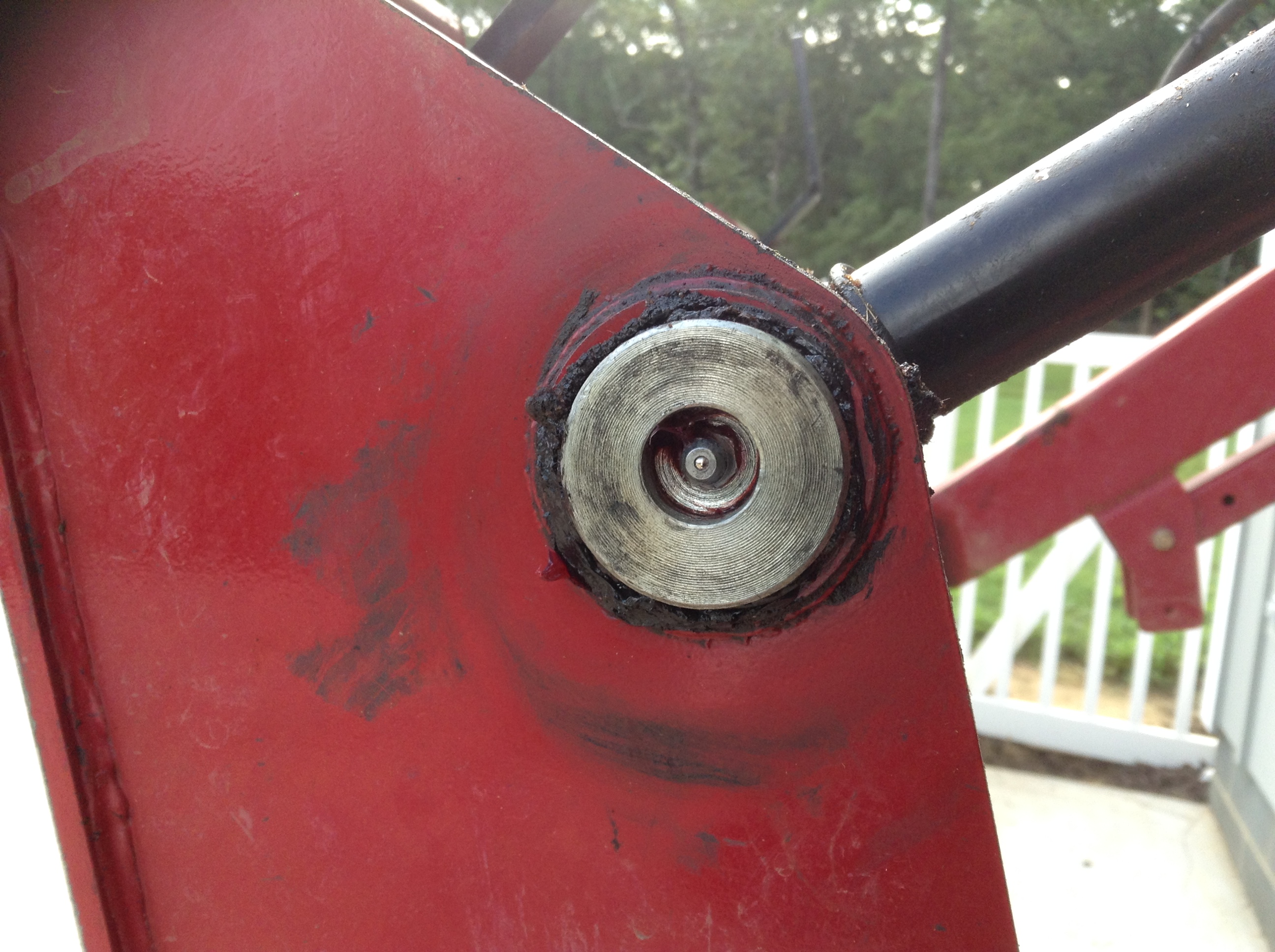

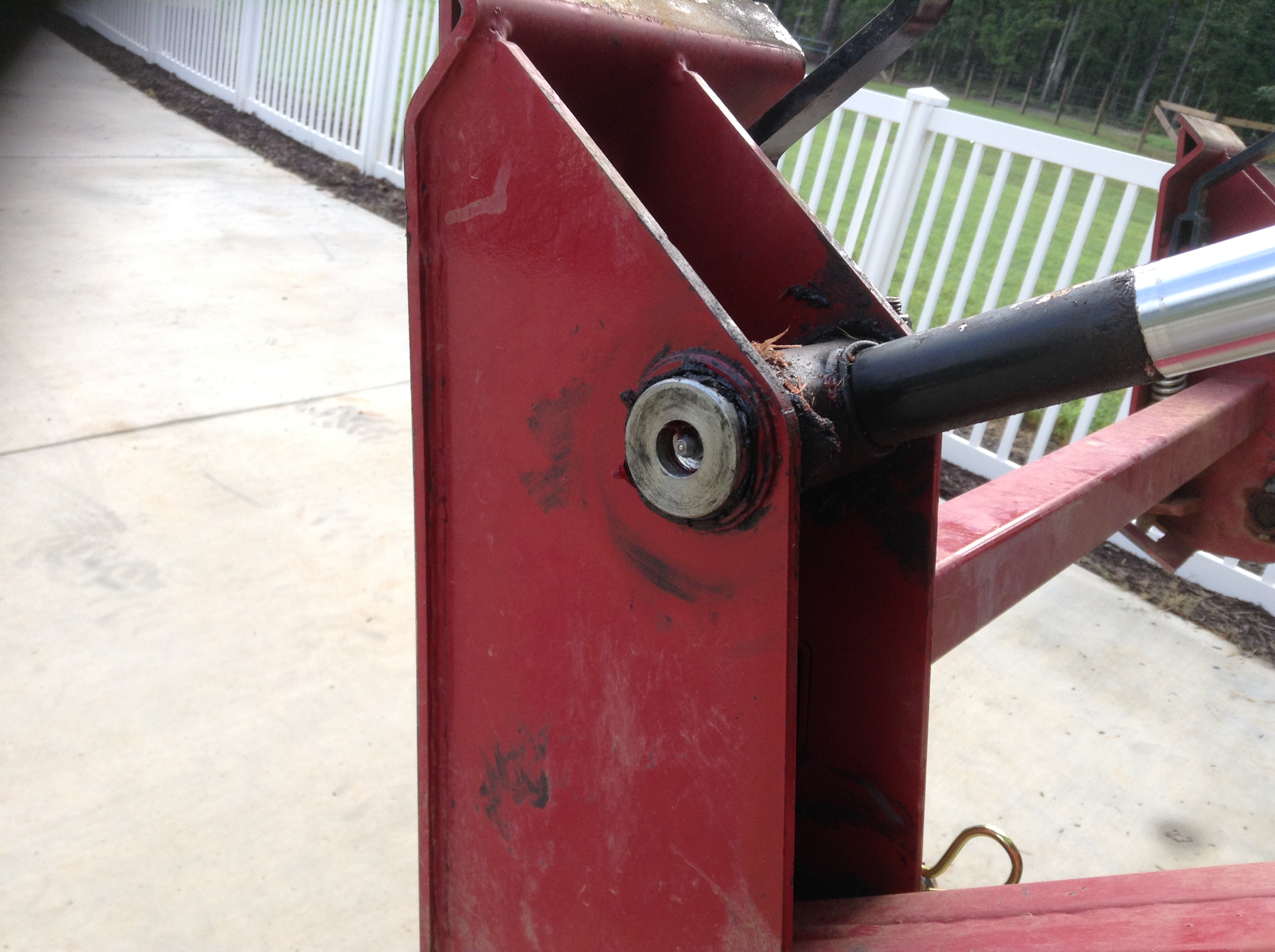

As requested, here are a few pics.
The first one is a long view of the curling mechanism for the bucket. Obviously I lost the bottom pin, but the pivot pin above my clevis pin, is exactly the same for the bucket.
The 2nd pic is a close up of the outside of the pin itself. The zerk is in the middle of the pin itself, not on the outside of the sleeve, and there is a horizontal canal in the pin to allow grease to flow from the zerk to the mid point of the pin and then another canal that intersects and goes to the outside of the pin, within the housing where the hydraulic cylinder mounts. (so the canal is in the shape of an "L") The canal that goes from the outside of the pin, into the center canal is what is clogging up.
The 3rd pic shows the backside of the pin, with the shear pin/bolt to hold the pin in place. (as you can see, I leave a fair amount of grease/dirt "cap" on the outside of the housing to protect it from additional dirt getting in)
I use a DeWalt power grease gun. Same one my excavator used on his bulldozer and trackhoe when he did some work for me. Puts out plenty of grease, and with sufficient power.
Hope that clarifies things a little.

   / FEW curl pins clogging #13
View attachment 565291View attachment 565292View attachment 565294
Are the pins grooved? ... IOW, does the small part of the L shape come out to a smooth pin surface or to a circumferential groove on the pin.
A groove would help but I dont recommend it. Iv had several pins at the bucket crack at the groove and replaced them with solid pins to prevent this.​
If you want to preserve through pin lube with as much effectiveness and durability as possible, I think you should grind a smooth shallow flat at the exit hole. Be sure to de burr the hole exit well to inhibit eventual initiation of cracks in use.​
Also, are you aware of the grease ram? Im not sure of the correct name but it holds about 2cc of grease driven by a piston that you drive with a hammer blow. This gives a huge pressure pulse and can usually clear a clog. . . Theyre simple and inexpensive.

So you have the zerk on the end of the pin, then you have the blind center hole in the center of the pin. Then you would have the cross hole at mid point to lube the end of the cylinder or area that needs lube. Does that cross hole go all the way through the pin or does it just go half way to the center feed hole? If it is only half way, it would help to drill through the pin. Sometimes, the pressure on the loader would be right at the cross hole location making it difficult to push grease through. As stated above, a groove would also do the same thing. I would make a shallow groove around the pin by using a dremel stone. To help from future cracking, be sure to make the grind marks (scratches) length wise on the pin, not in the direction going around the circumference of the pin. (spin the pin while the side of the stone makes the groove)
I thought about doing that, but didn't want to compromise the strength of the pin. (no grooves on mine). I like that idea better than grinding my own groove around the perimeter of the pin. I think it would definitely weaken it, and as one other poster stated, he's broken a few that had the factory groove machined into it. And I lift a lot of heavy stuff, so I don't want to test the tinsel strength of the pin if I don't have to.
